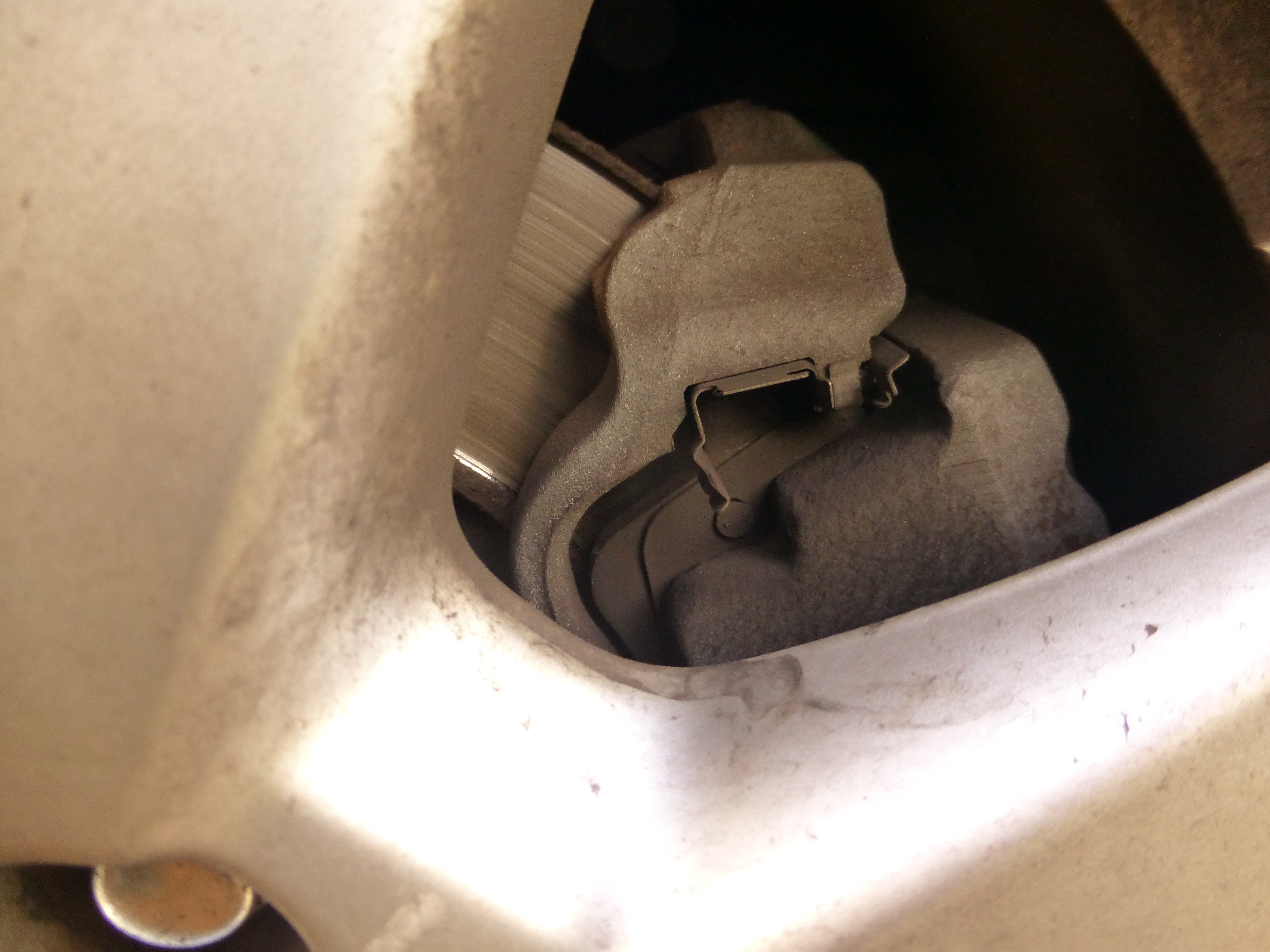

Check the thickness of the brake pad material and also that the brake disc has not lipped or has ridges. The brake pads should have no less than 3 mm.
You can check the brakes if the wheels are alloys and have large openings, or you will need to remove the wheel for better access.

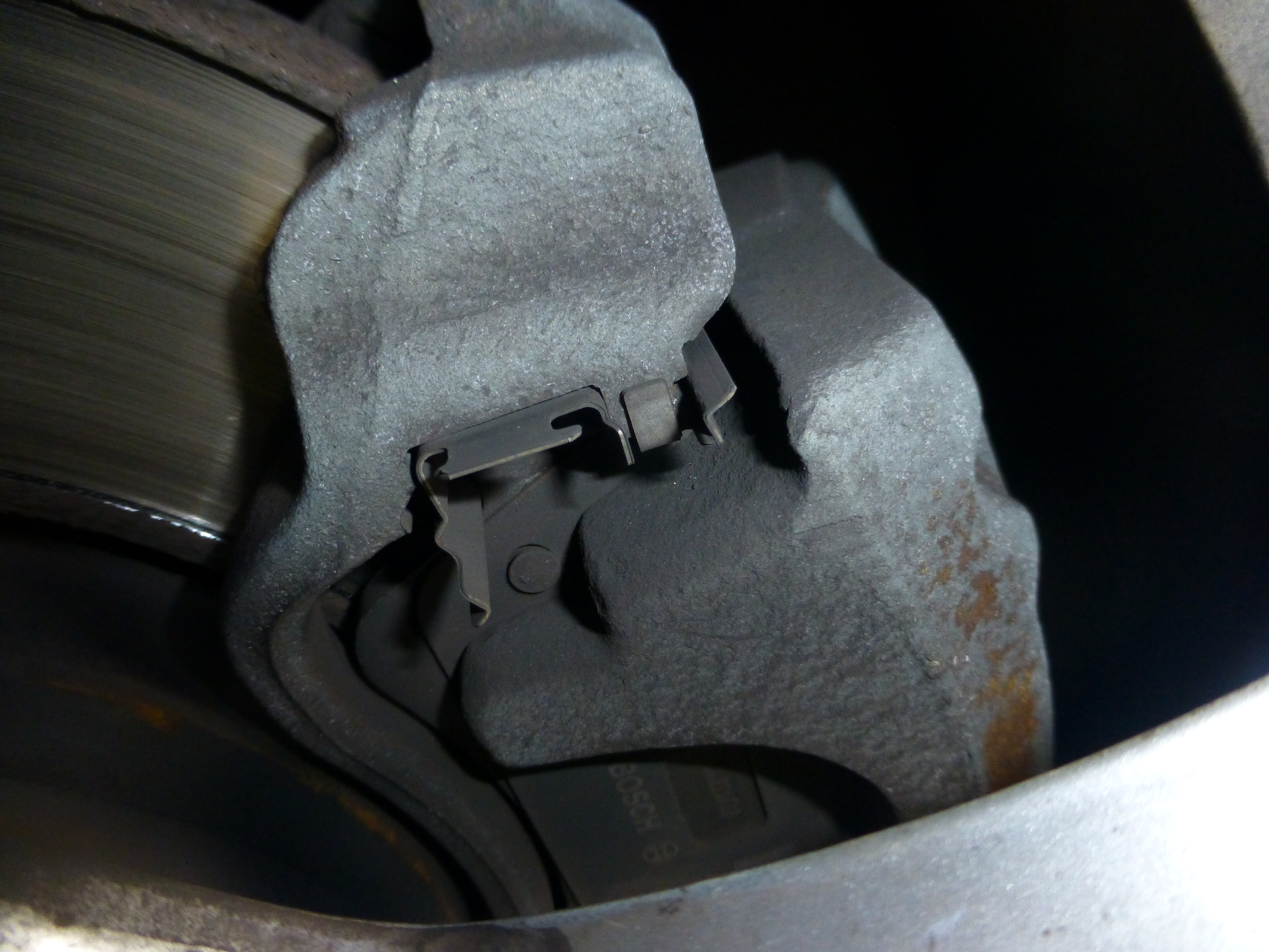

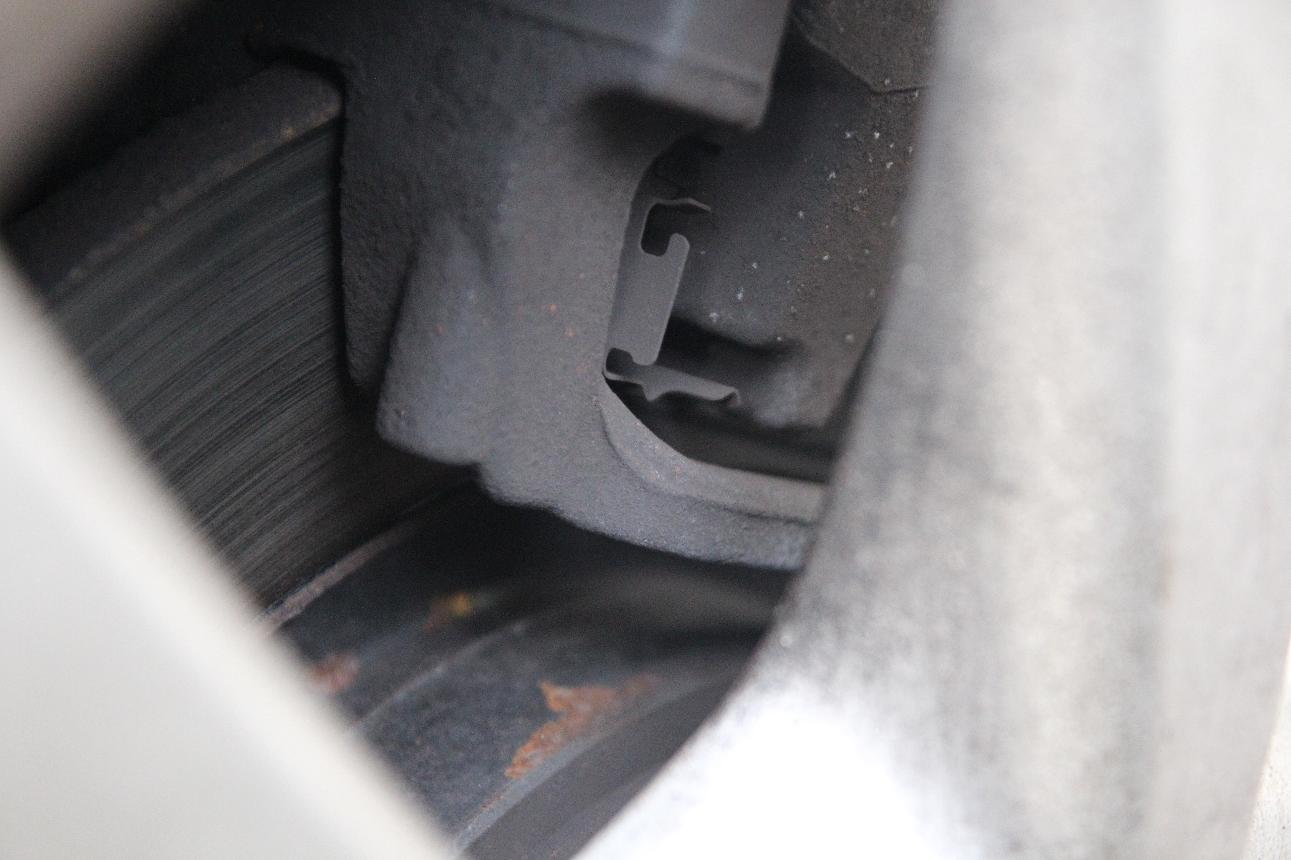

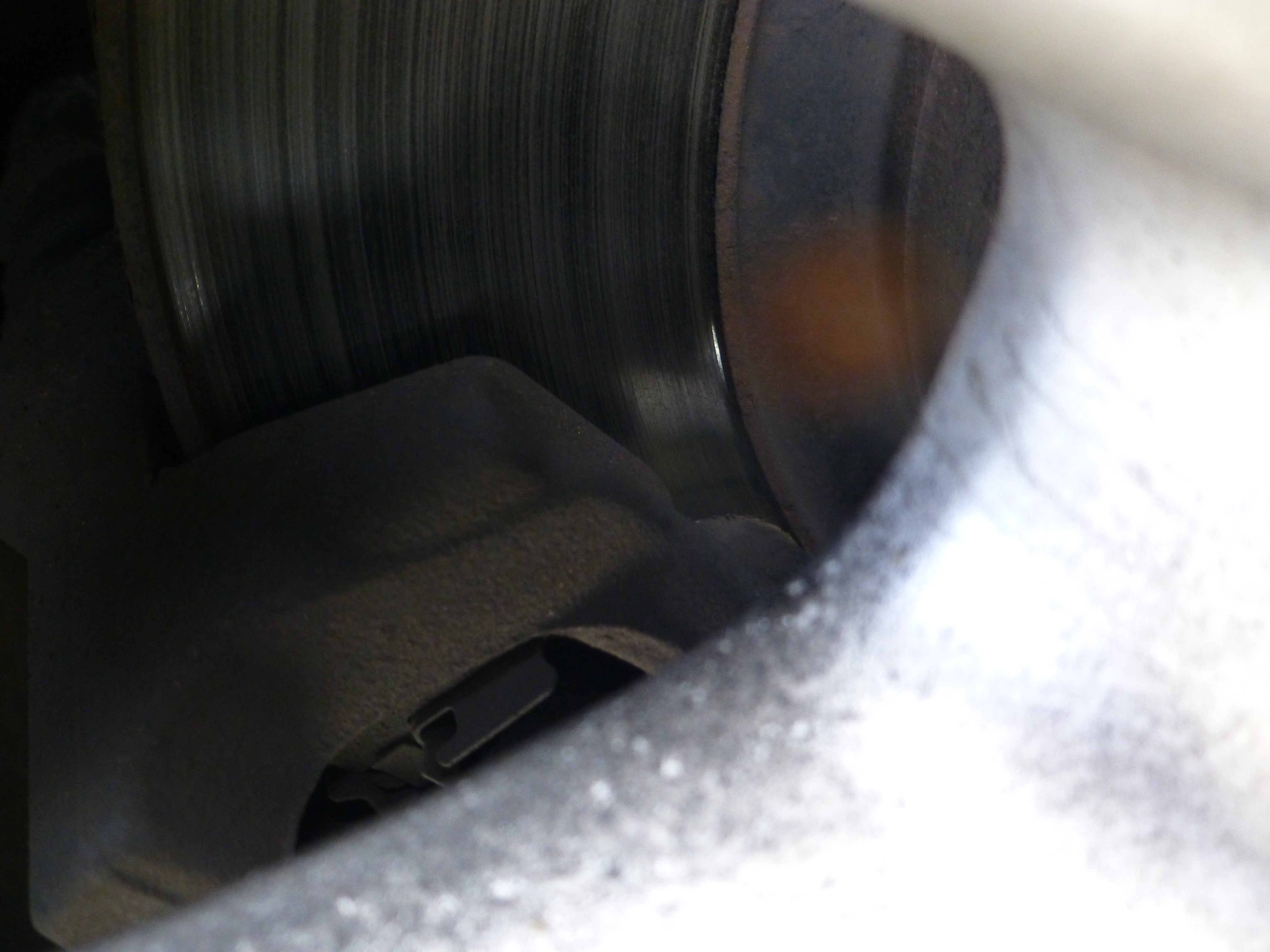

Here are photos from last year when I changed my disc and pads all round on my 2009 Avensis.
Looking at the brakes through the wheel
Another photo looking through the wheel.

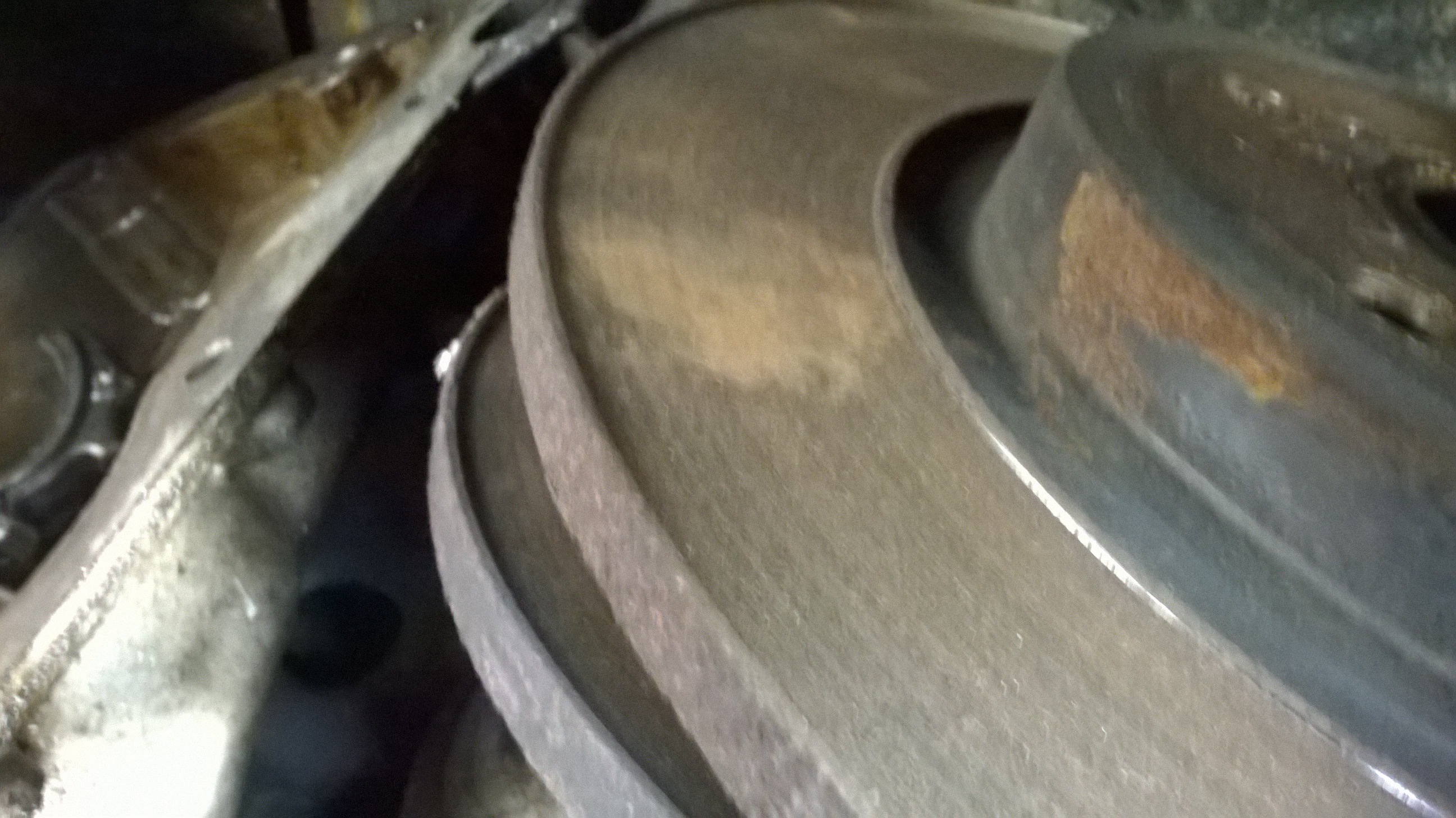

Notice the lip at the edge of the disc.
These are my old rear discs. The lips show how worn the discs are.

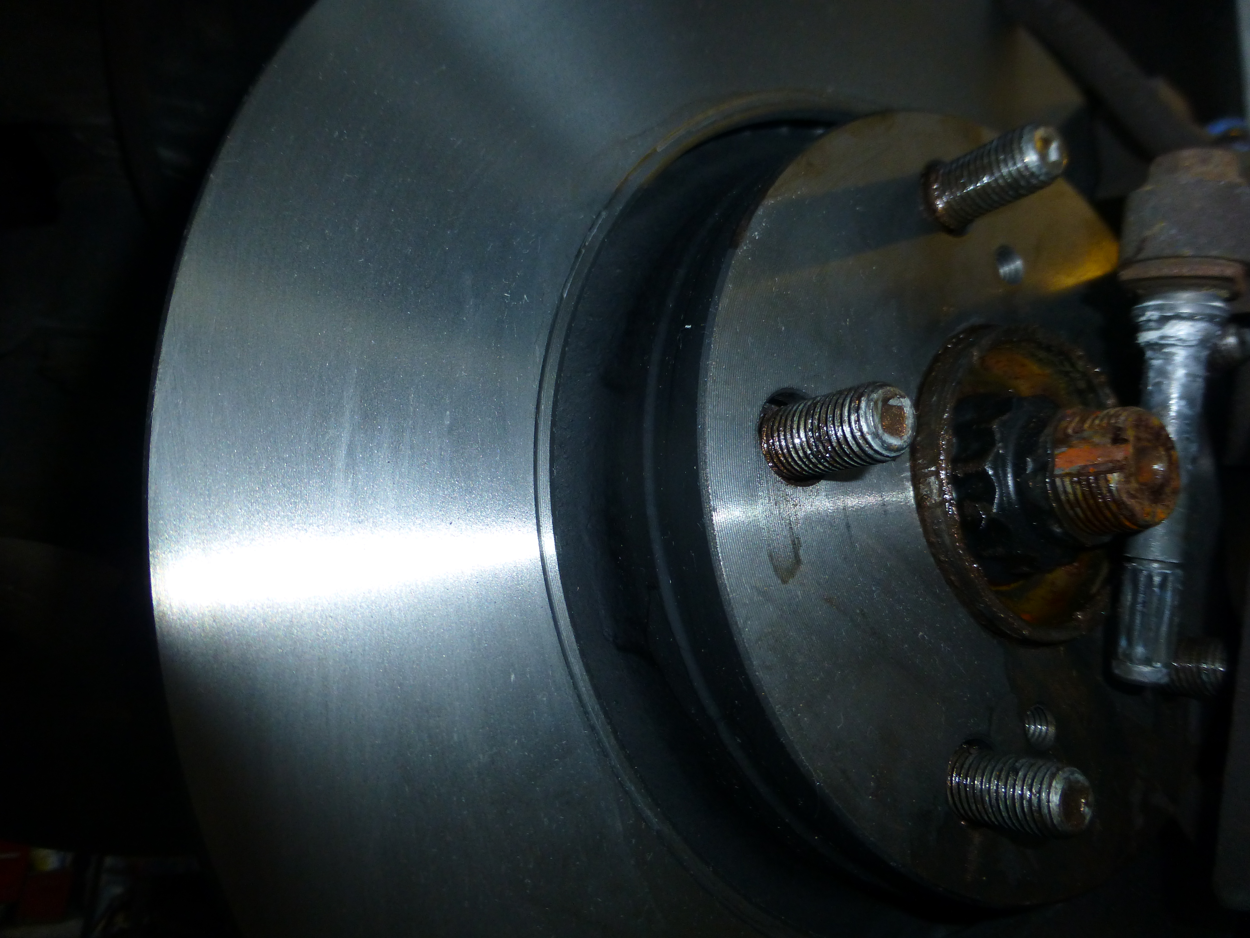

New discs being fitted.

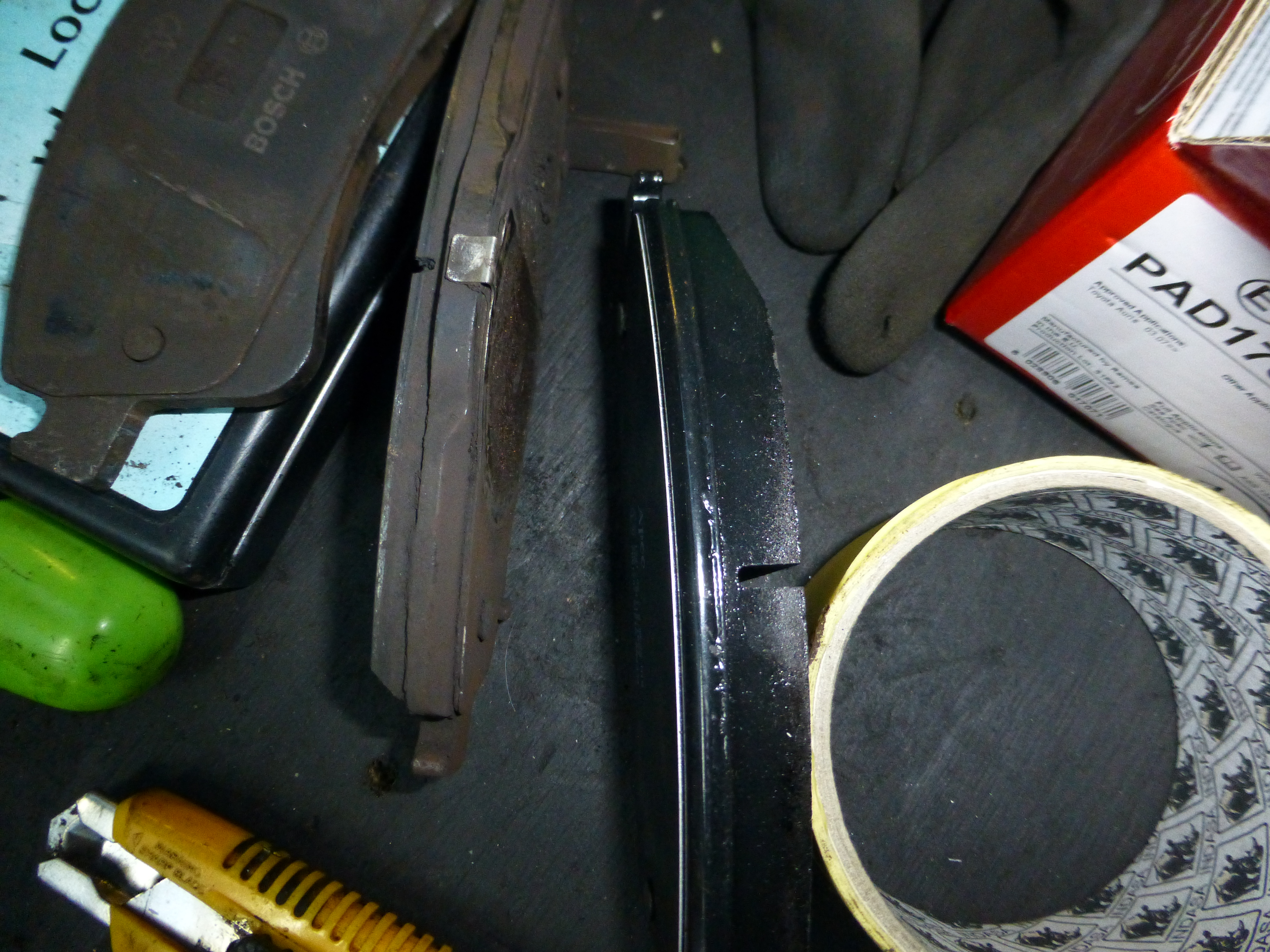

Old and new front pads compared. Not too low but with the disc worn, it was time to change.
