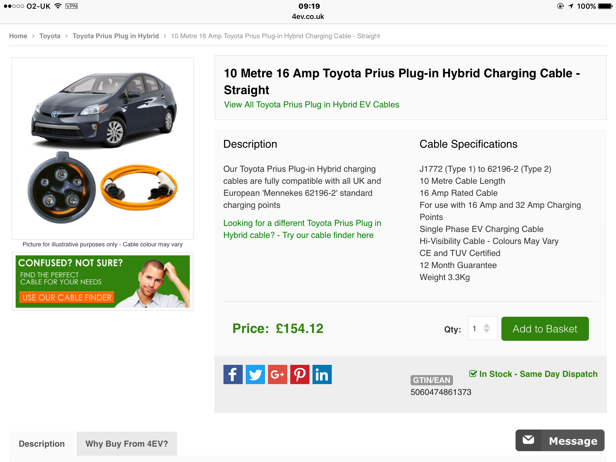

just wondering if any thoughts on this cable? The car came with the one for home charging but also need one for regular charging points...16 or 32 amps?

For the current plugin prius, a 16amp cable is fine.  It only takes 10amps max.
The new plugin (when it gets here) can use faster charging so a 32amp cable would be required in this case.

I notice the one you have shown is 10m length. Mine is 5m length so it will be cheaper.
I use a 16amp for my PiP currently. A 32amp will also work, and be more future proofed, so worth potentially getting the 32amp for any PHEV you purchase at a later date.
