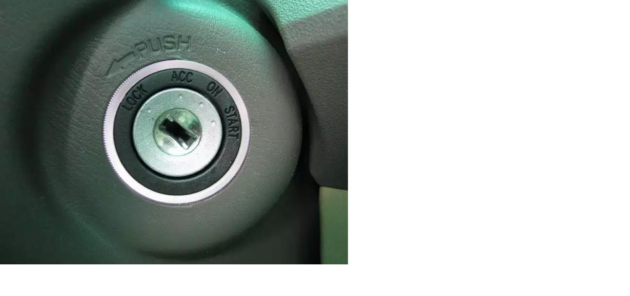

On my Auris the interior light comes on when i open the drivers door but only remains on for a couple of seconds before dimming and then going out. If i open the passenger door it remains on until the door is closed. This is a pain at this time of year as i then have to switch on a map reading light to see the ignition switch. Is there any way to extend the delay on the drivers side?
Your ignition switch is not illuminated? Mine has an orange circle illuminated by a LED that is connected to interior lights system. Maybe your LED is burned .

Both of my Auris (a 2009 and a 2012 model) had illumination to the ignition switch, and the interior lights performed as Alan described.
Thanks for that guys. It is a 2007 D4D. I checked this morning and there is an LED around the ignition switch. The top light came on with the door open but only stayed on about 5-10 seconds, not quite long enough for me to put the key in the ignition. If i open the passenger door the light stays on for the duration the door is open.
