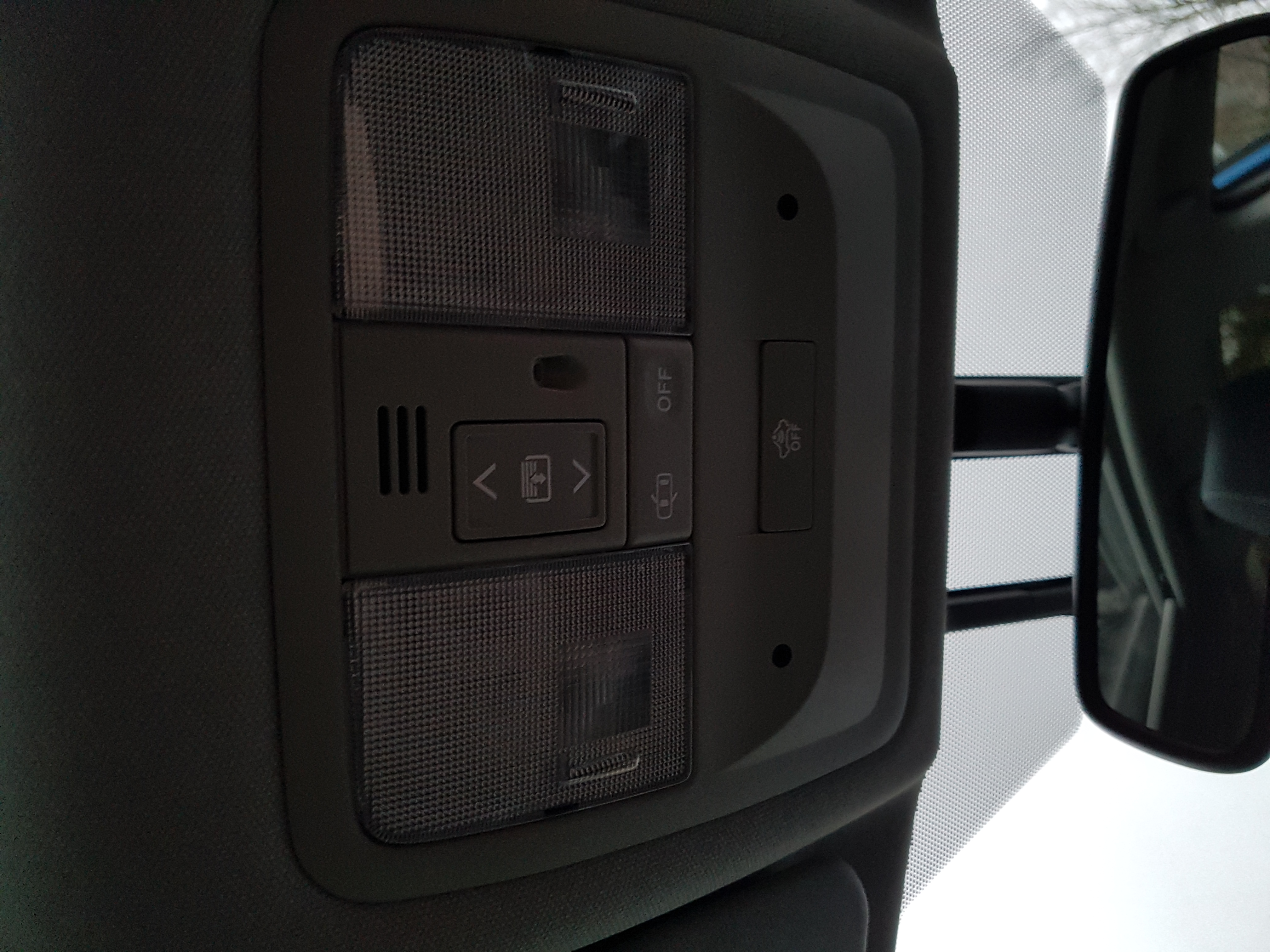

I purchased a 2014 Auris TS at the beginning of the month, and it is great! However the incandescent interior lighting leaves a lot to be desired, especially in the boot. I have replaced the boot, rear center and vanity lights with LED bulbs but have hit a snag with the front center. I cannot work out how to access the bulbs behind the sunroof control / light panel below.20170130_081326.jpg
Please excuse the sideways-ness of the picture, technology eh?
A cursory search hasn't provided me with any enlightenment, can anyone help?

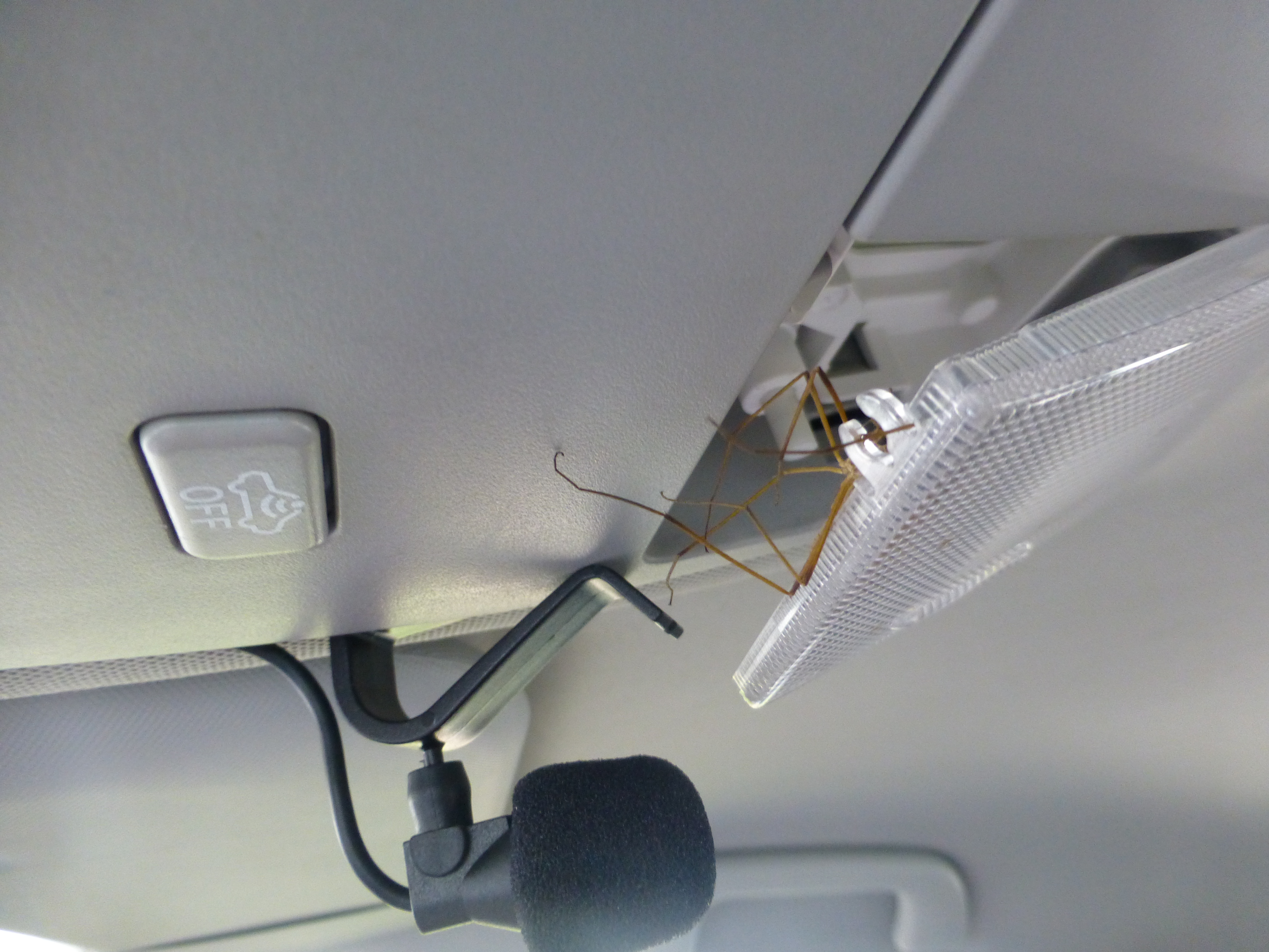

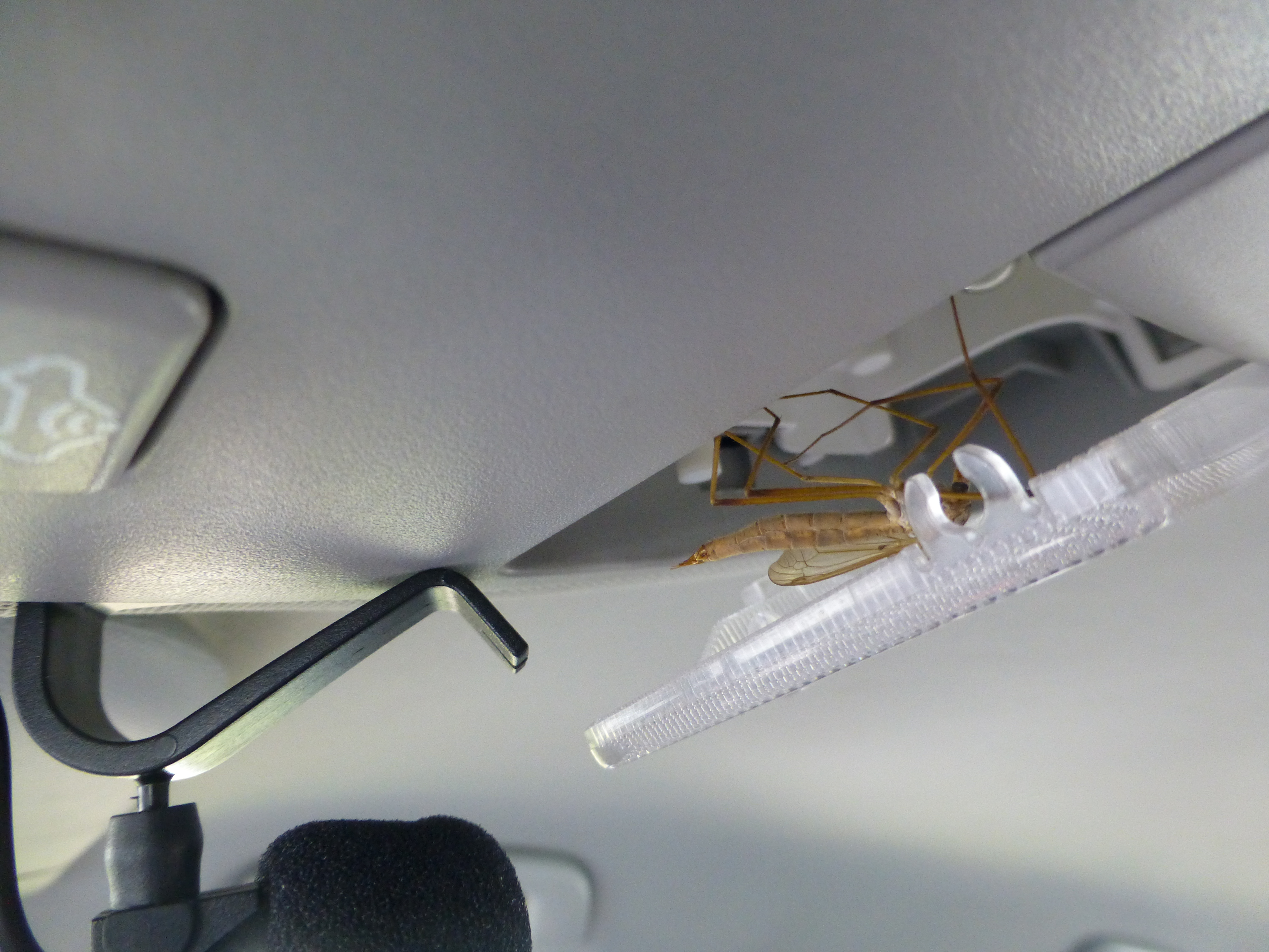

Looking from the passenger side at the drivers lamp. I bought the car with the dead guest!
Lever from the centre corners to release the lens.

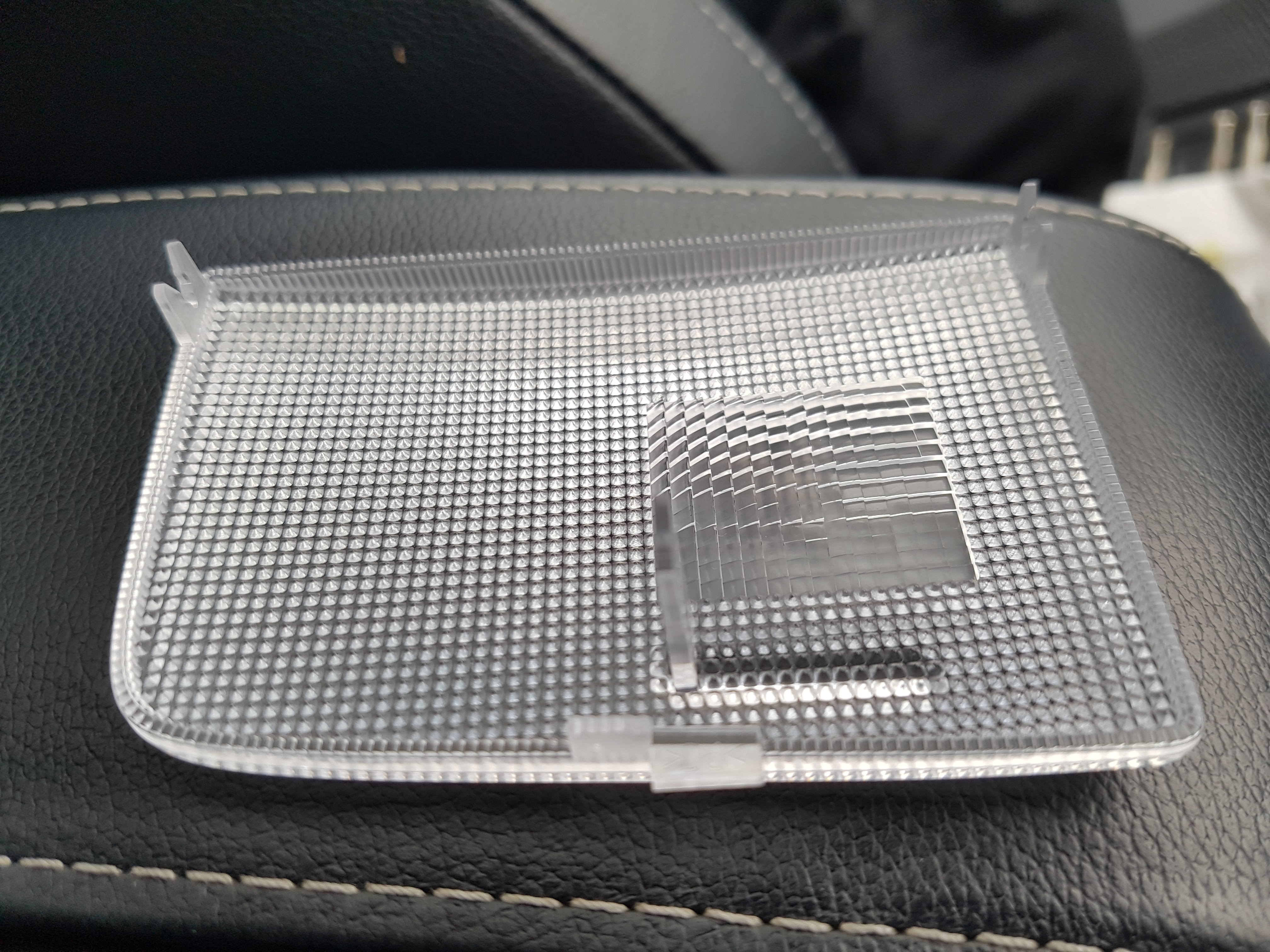

Lens removed, notice the slots near the hinges to insert a suitable tool.

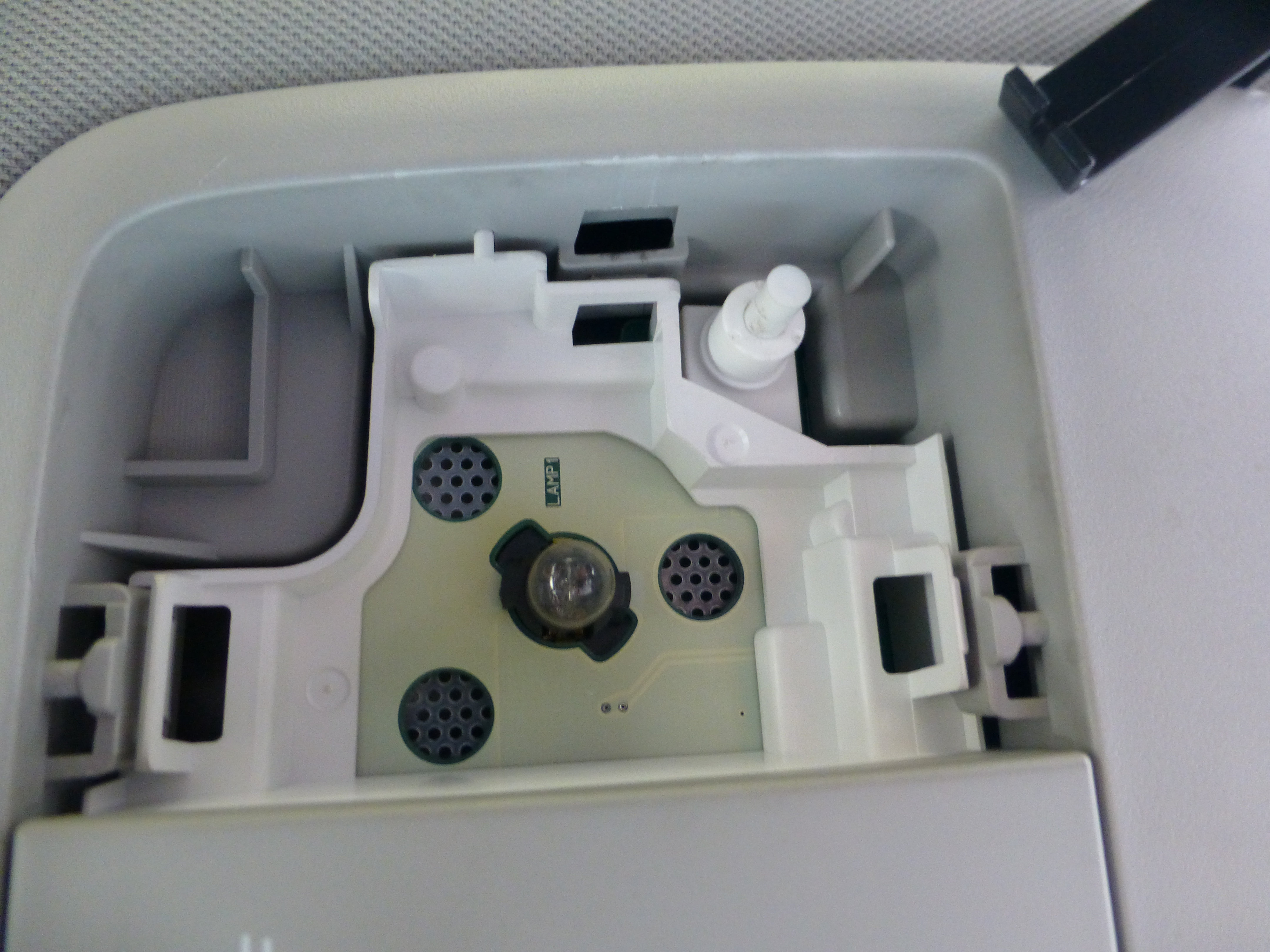

Clear access to the bulbs.
Even though they are different cars, Toyota tend to be consistent with the design and access.

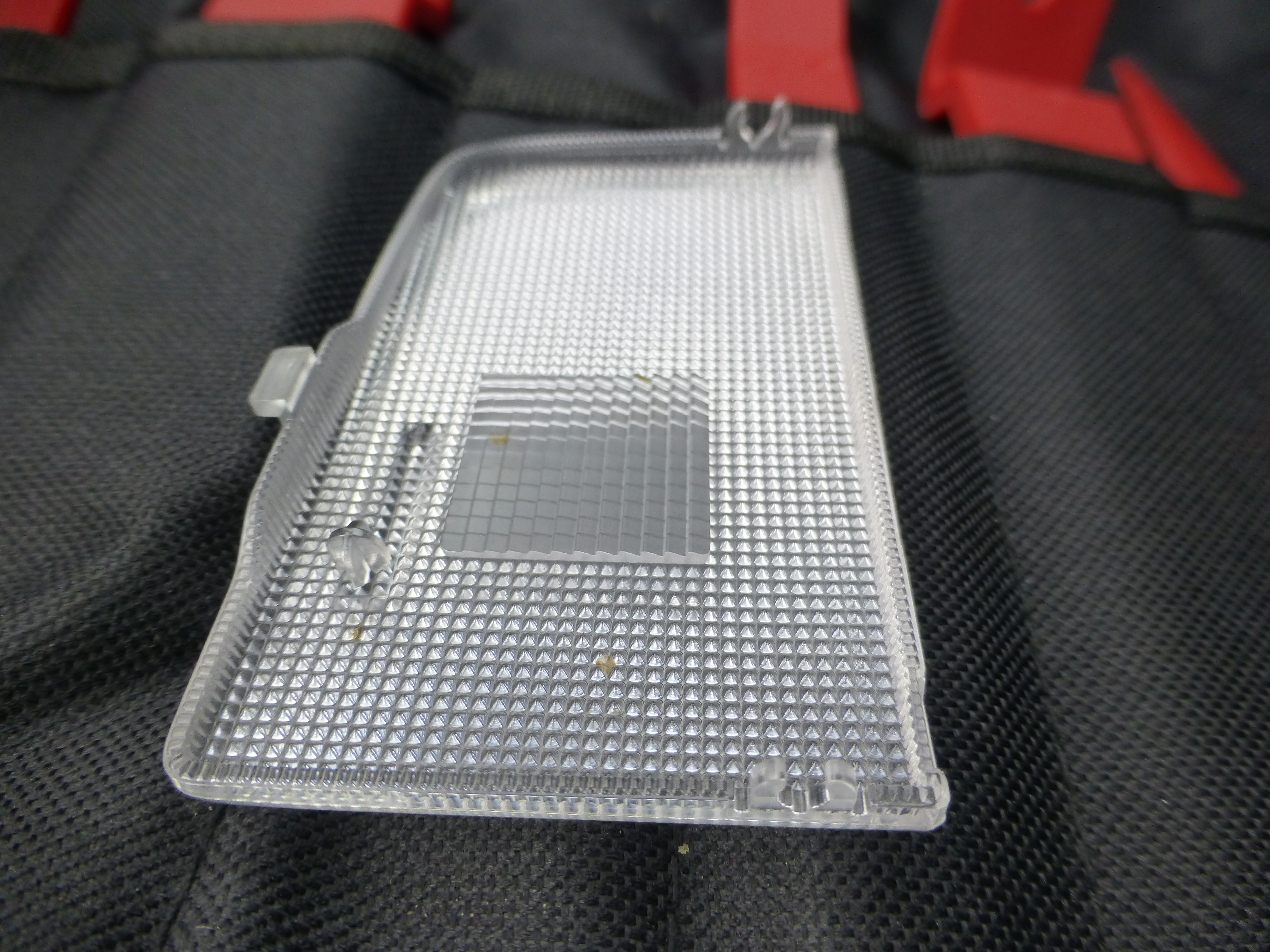

That did it, although my lenses had no slot for tool insertion.20170130_120445.jpg
Hence my confusion. A *very* thin screwdriver in cloth levering next to the hinge popped them open.
