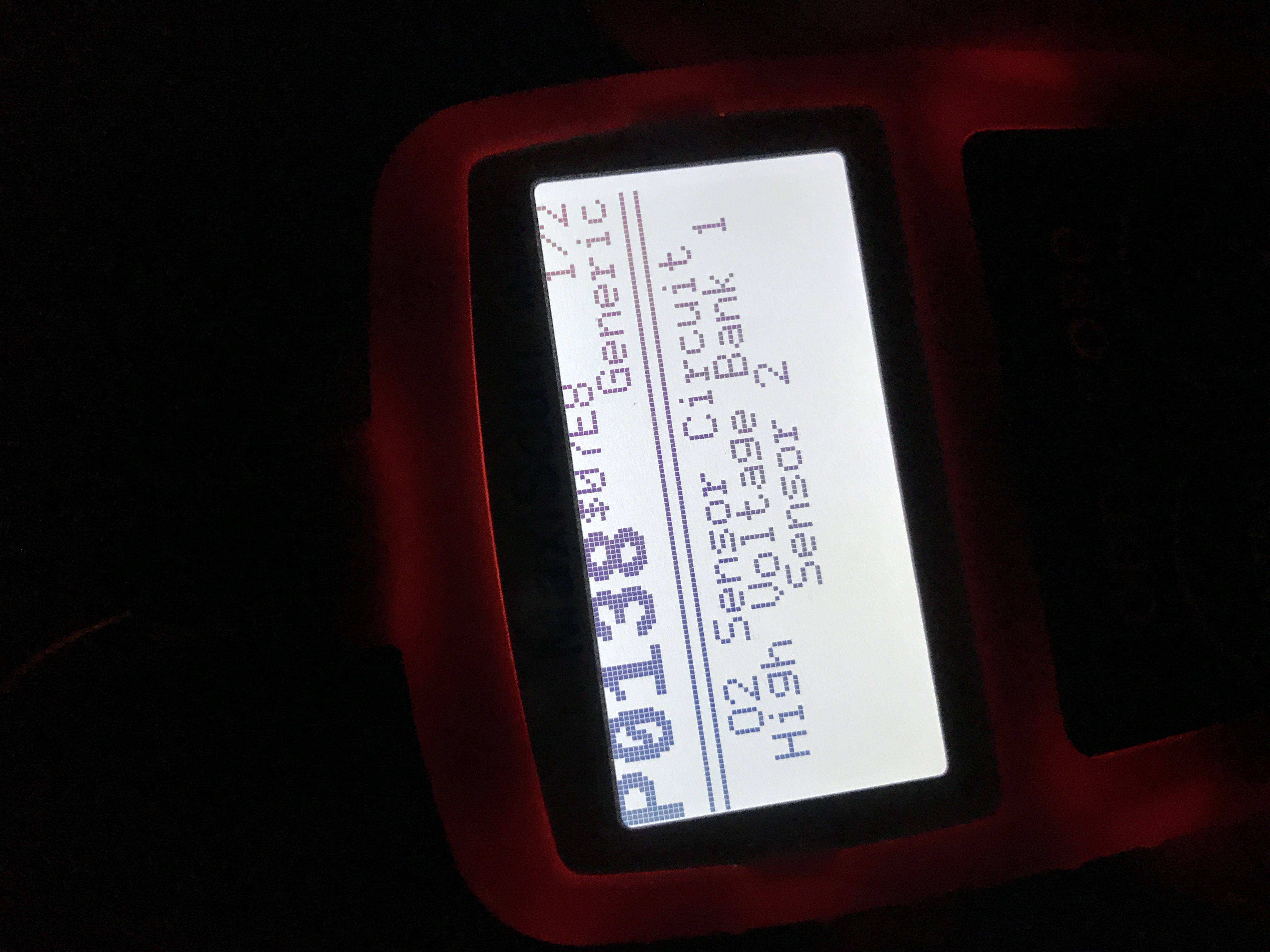

Driving along the other week and the engine light came on along with the traction control light, plugged in code reader and it stated 'P0138 O2 Sensor Circuit High Voltage Bank 1 Sensor 2', have had the sensor changed at a garage, drove a couple of days and the light reappeared, back to garage where they gave it a service, again drove a couple of days and the lights reappeared.

I presume so, the garage checked their code reader and got the same code.

I would think the scanner that the garage used was/is good enough to identify what the car thinks is the problem. I would personally save the money unless you wish Toyota to carry out their own repair.

Hi Andy I was just wondering if and how your issue has been resolved? I have exactly the same fault on my 10 plate manual IQ had the sensor replaced twice (second at garages expense) serviced etc but lights still coming on in car and have checked with my obd reader p0138! Thanks
Hi, yeah I took it to Toyota and they changed both sensors as the one I had fitted wasn't factory Toyota and they thought if they weren't the same brand they might not be compatible. Cost me about £360 but it's sorted now.
