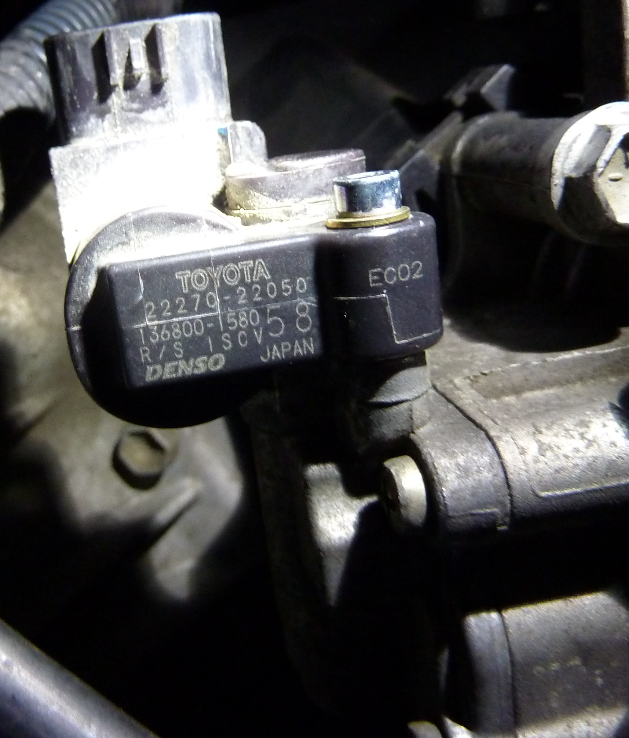

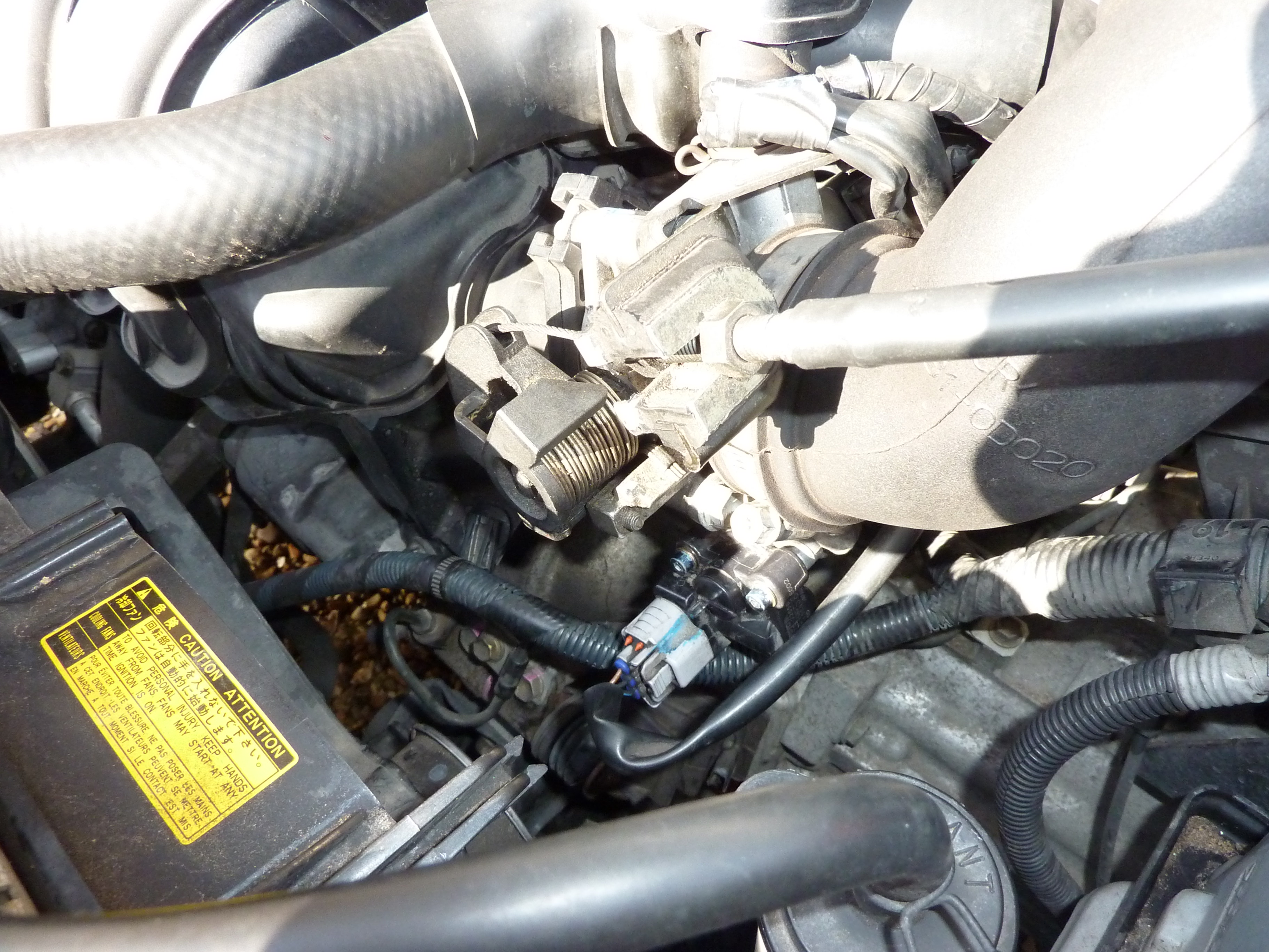

I had almost the same problem on a 2001 1.4 VVTi, the only difference was it would put the engine management light on.
I had a brief chance to fault-find before the symptoms went away (until the engine was cold again). The fault was happening for days before I fixed it.
I think I used a can of freezer spray to try to pinpoint the failing part.
This car had a Pierberg throttle body with a Denso idle control valve. The valve was secured by two 5-point(!) Torx-style security fasteners. Removing and thoroughly cleaning the valve made no difference to the fault.
The idle valve was only available as part of the throttle body, which was about £400 from Toyota.
I got one from a breaker for about £12, and replaced just the part with the Toyota label and the shiny Allen bolt showing in the 1st picture.
Since replacement 4 years ago, it has never gone wrong.
Some ingenuity is needed getting the bolts off, the picture shows the new ones.
