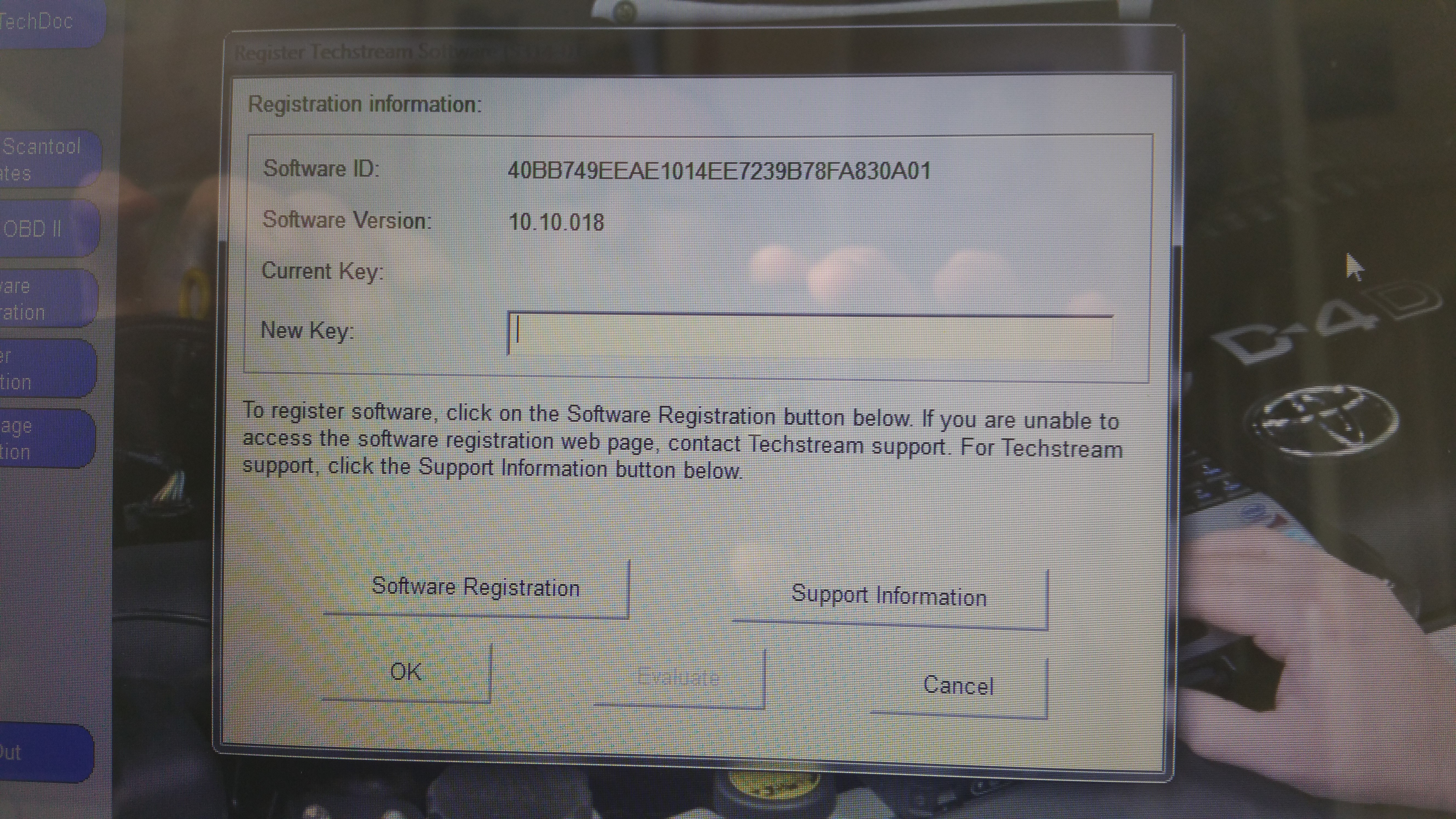

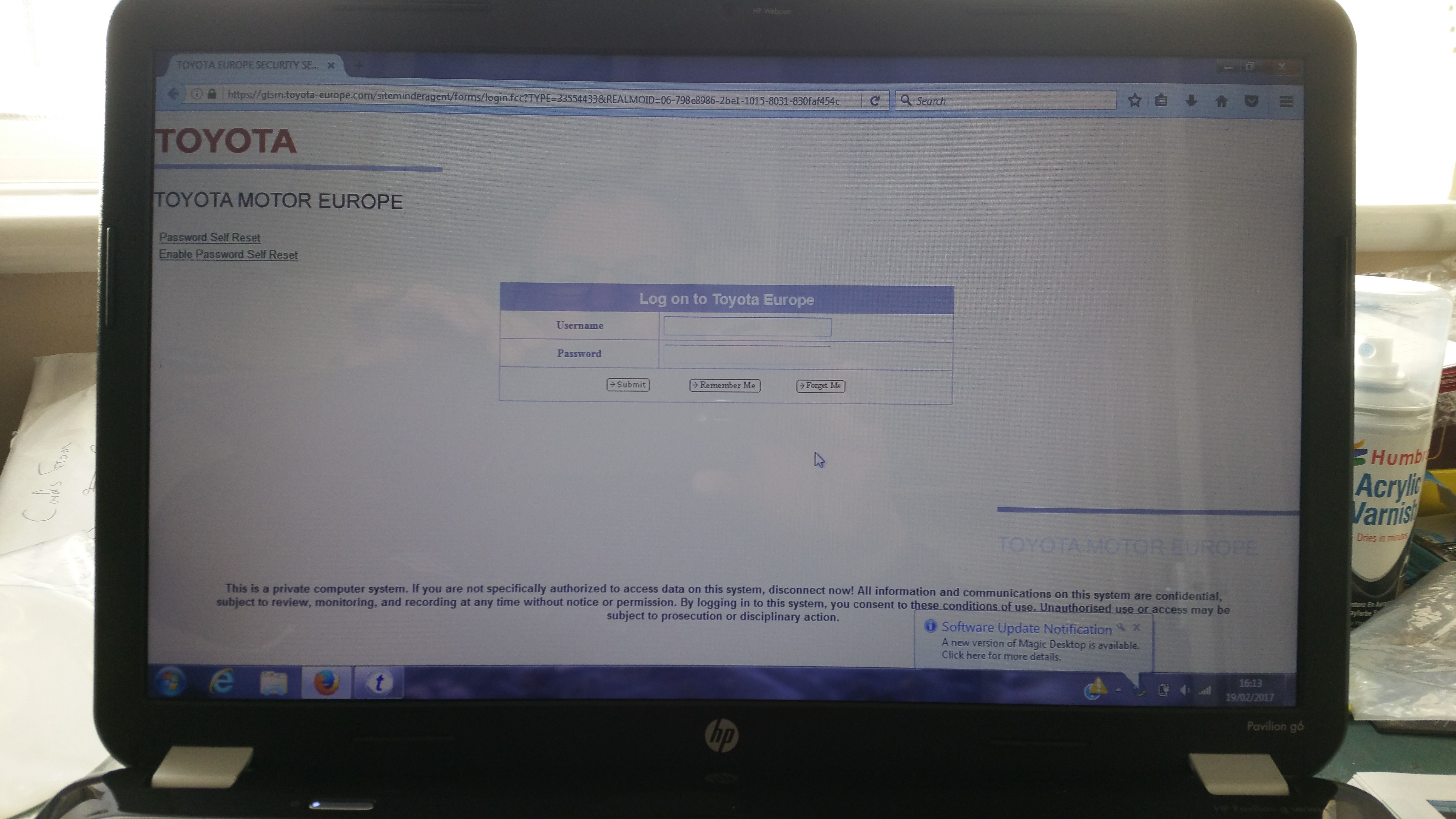

I have just bought one of these Toyota mini VCi thingy's but I am having trouble trying to use it! I have installed it on to my laptop using the supplied disc no problem but, when I now try to use it I am getting these windows up and I really don't know how to get past them! I have already had a window come up asking me to enter the 'repairers' details etc so I have had to put my own name in and make the rest up!
The first picture is a 'registration' window but I have no key to enter into the space as my VCi didn't come with one!
Second picture is asking me to logon to a Toyota Europe website that I am not even registered on! what am I supposed to be doing here? does anyone know? I really need some 'detailed' help please.
The software supplied with eBay cables won't be an official Toyota licensed version. Usually they come with some sort of 'crack' to circumvent any registration process. Are there any setup instructions saved on the disc as a text file perhaps?
