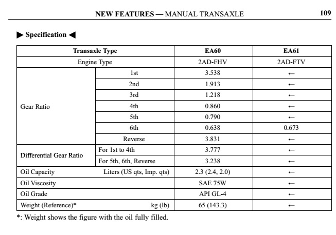

Haha that was me I guess. I learned it the hard way. Just make sure that the gearbox is the EA60 version.
I've attached a chart I got from Toyota back then.
