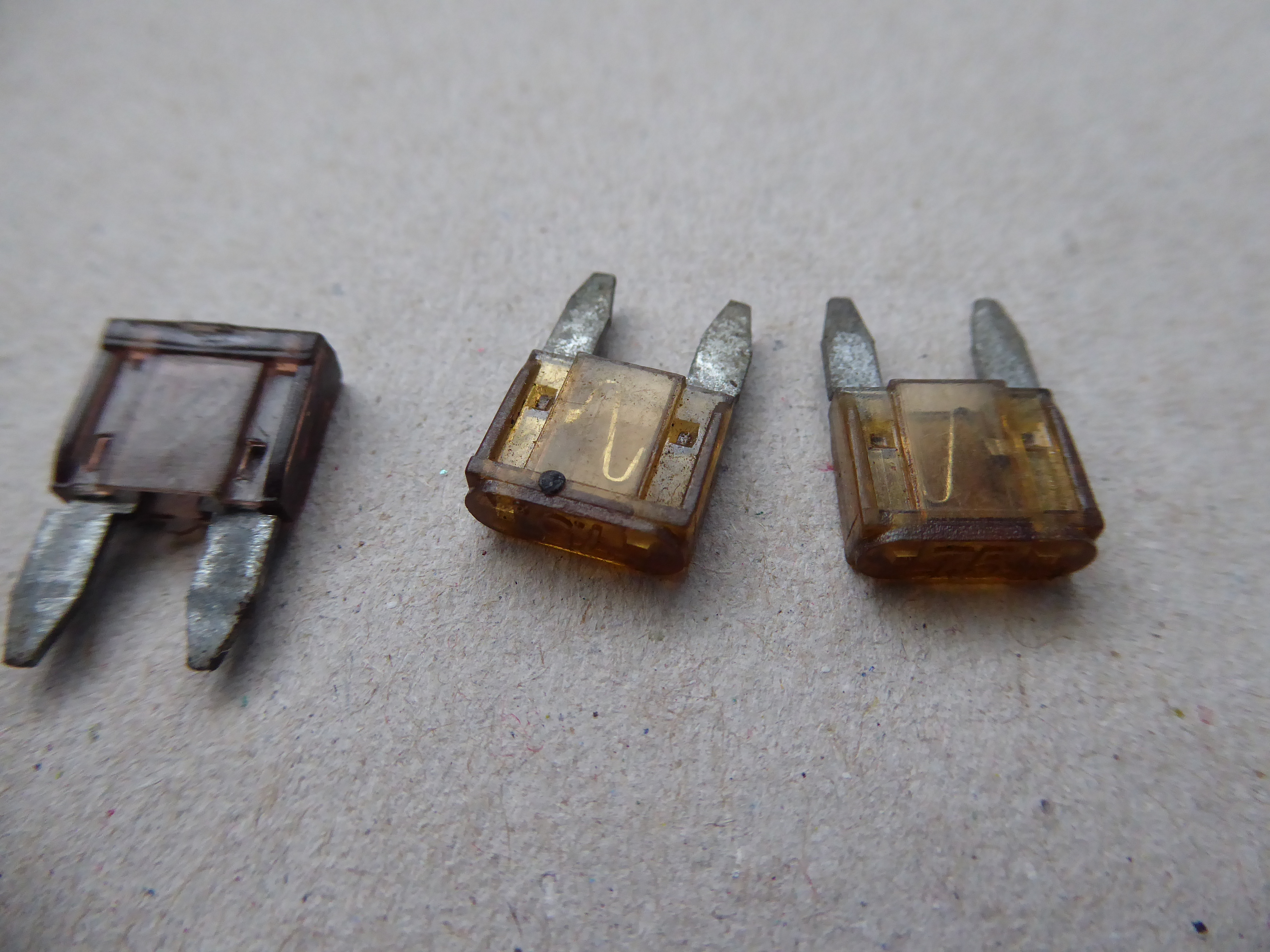

In relation to your other query regarding the alarm light and no remote, try swapping the dome fuse in the engine bay fuse box, even if it has not blown. Mk1 Avensis like my old one had this issue, and the fuse was intact, but the resistance was high due to the change of metal properties. I had a spare so swapped it and the central locking started working.

Hi Konrad, I looked on eBay for a dome fuse but couldn`t find one. Will I have to get one from the main dealers?
The type of fuse you need are mini blade fuse rated at 7.5A. Euro car parts sell them - http://www.eurocarparts.com/mini-blade-fuses
or Maplin - http://www.maplin.co.uk/p/75a-mini-blade-car-fuse-vj50e
or Halfordshttp://www.halfords.com/workshop-tools/garage-equipment/fuses-electricals-fixings/halfords-mini-blade-fuses-7-5-amp-hfs195

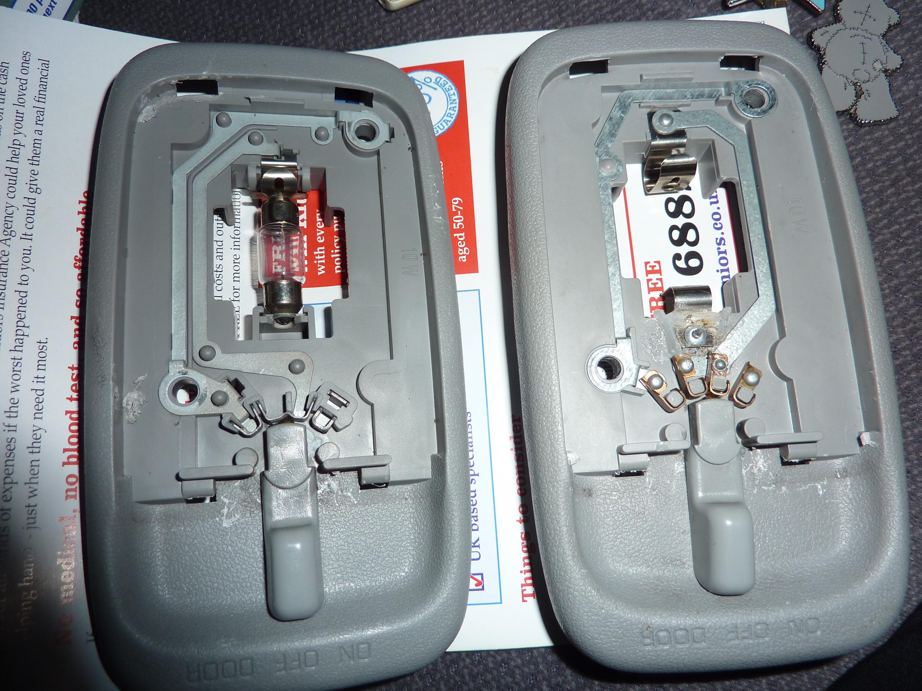

I assume your dome light works when the doors are open? I have had trouble with that in the past, and replaced it with a secondhand on that looked the same but a different design internally.
Hi Konrad, by the dome light do you mean the one in the middle of the roof just behind the sunroof? If so that has not worked for years.
There are a few reasons why the centre centre dome light doesn't work. First the bulb has blown, the unit is faulty, the unit has a short that can blow the dome fuse - mine had this, the dome fuse has blown for another reason - check the door switches.
I replaced my dome light housing because it was not working and shorting the fuse.
The housing on the left is the replacement unit, the one on the right the old one. Notice the difference in design of the electrical components.
I tried to repair the original housing but it did not work, so replaced.
