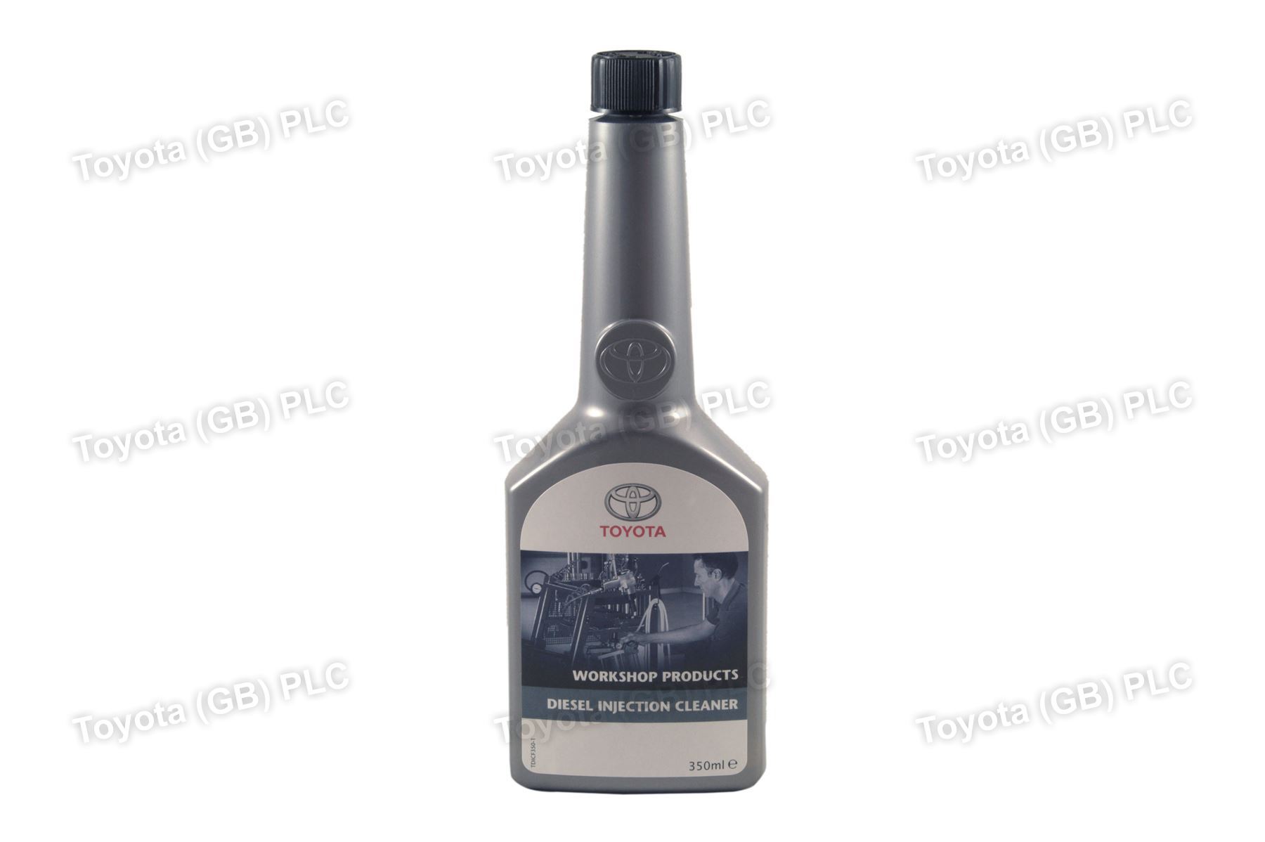

  • Try Toyota fuel system cleaner - take in to the fuel and 50miles later it will make the car perfect. Unfortunately 2-3 full tank fuel later, the fault came back.
  • Usually buy normal fuel (not from supermarkets) - now tried the premium, most expensive diesels, and fault again disappeared. However later it's no matter the premium or/and the cleaner liquid in the tank, by all means it's grabbing and stop the car, take the fault code P1251
