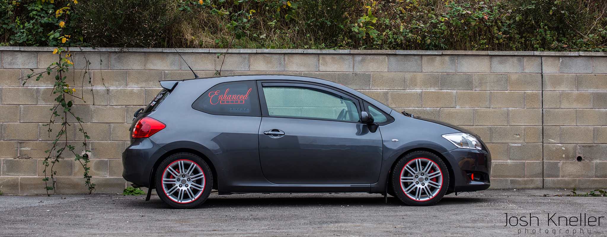

My own auris is very harsh feels like no suspension ... I struggle to get on my own drive but yours sounds a different issue ... How low does your car sit do you have a picture of it from dead on sideways (as seen attached) from both sides to see.

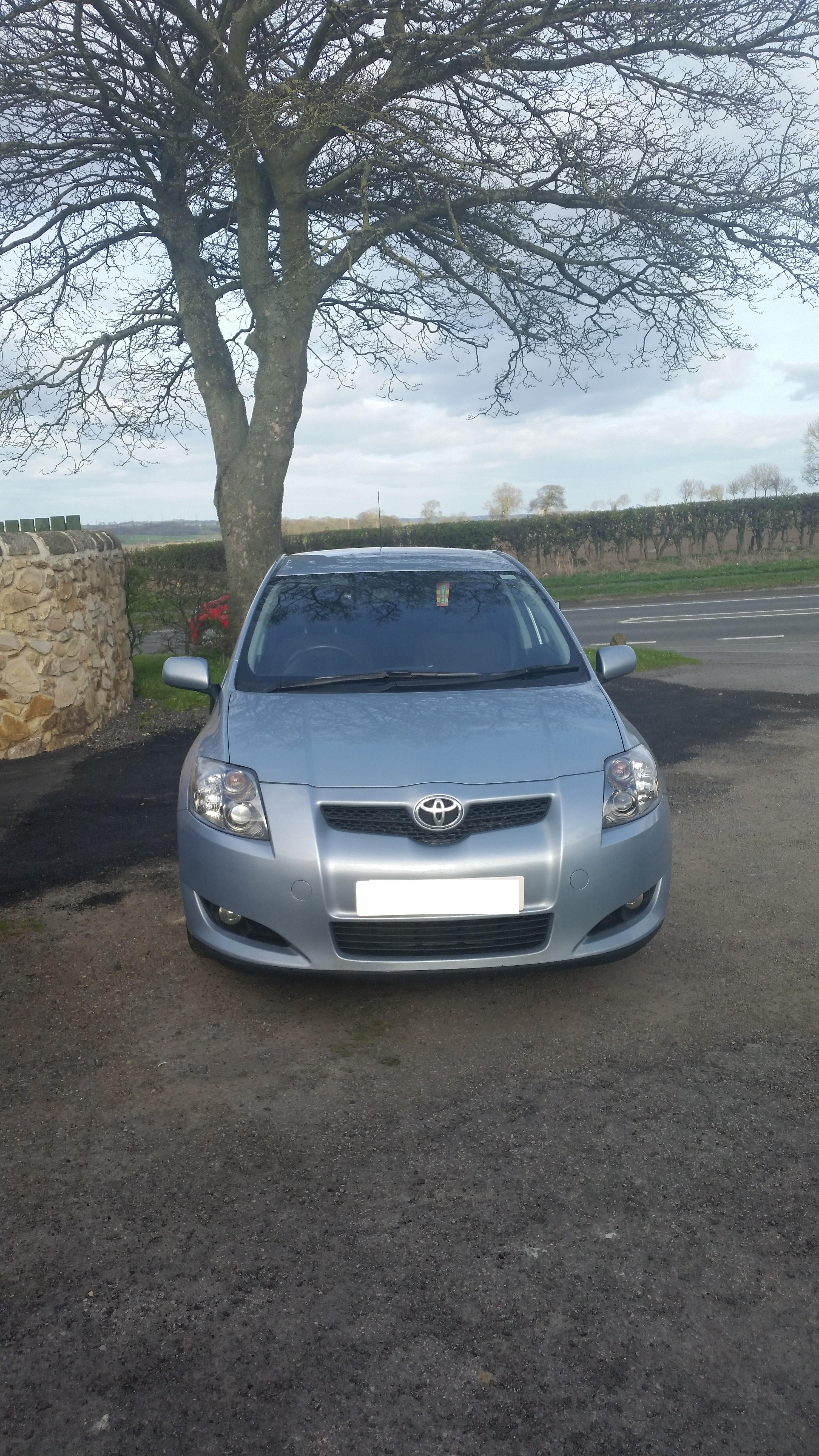

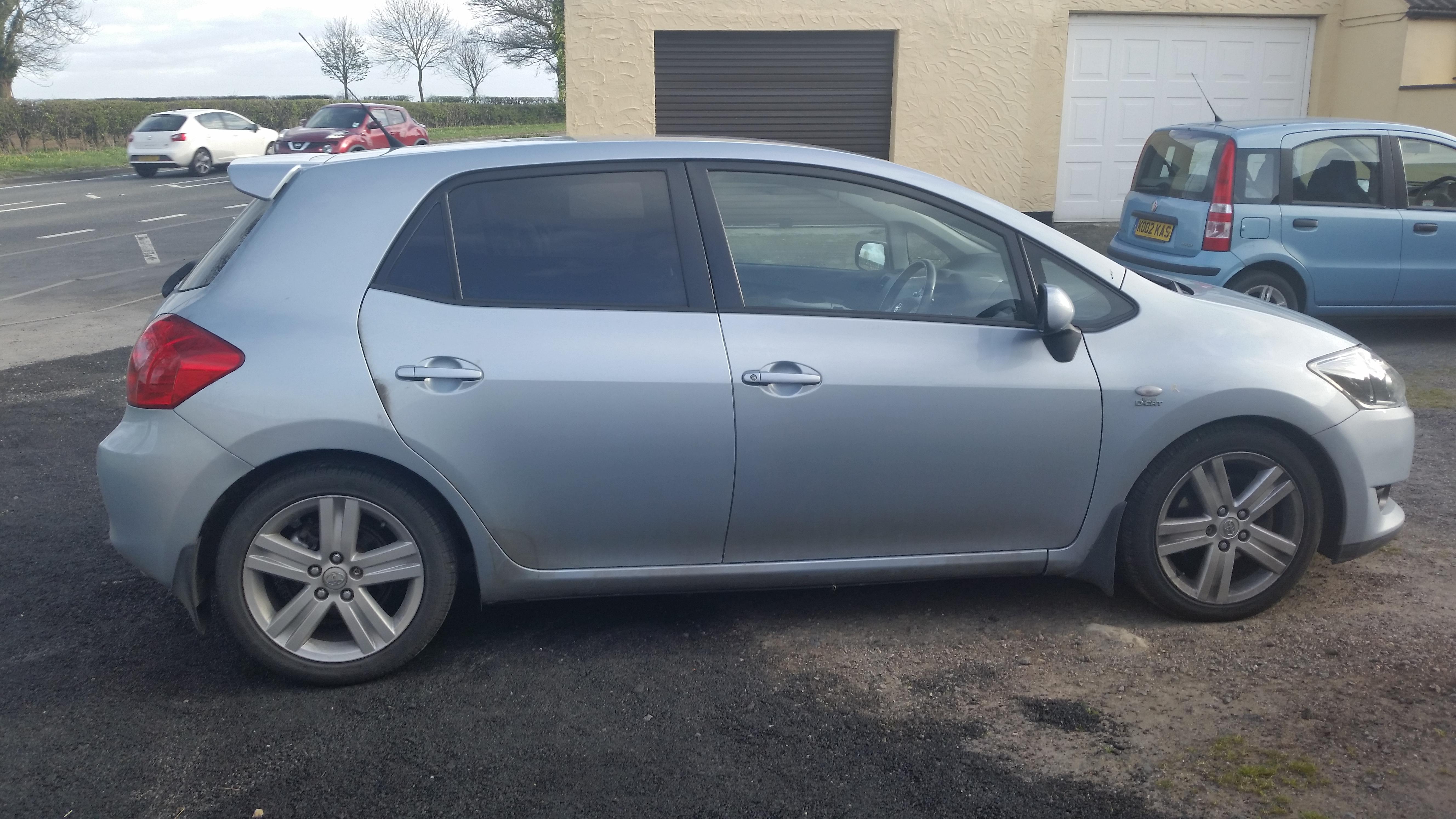

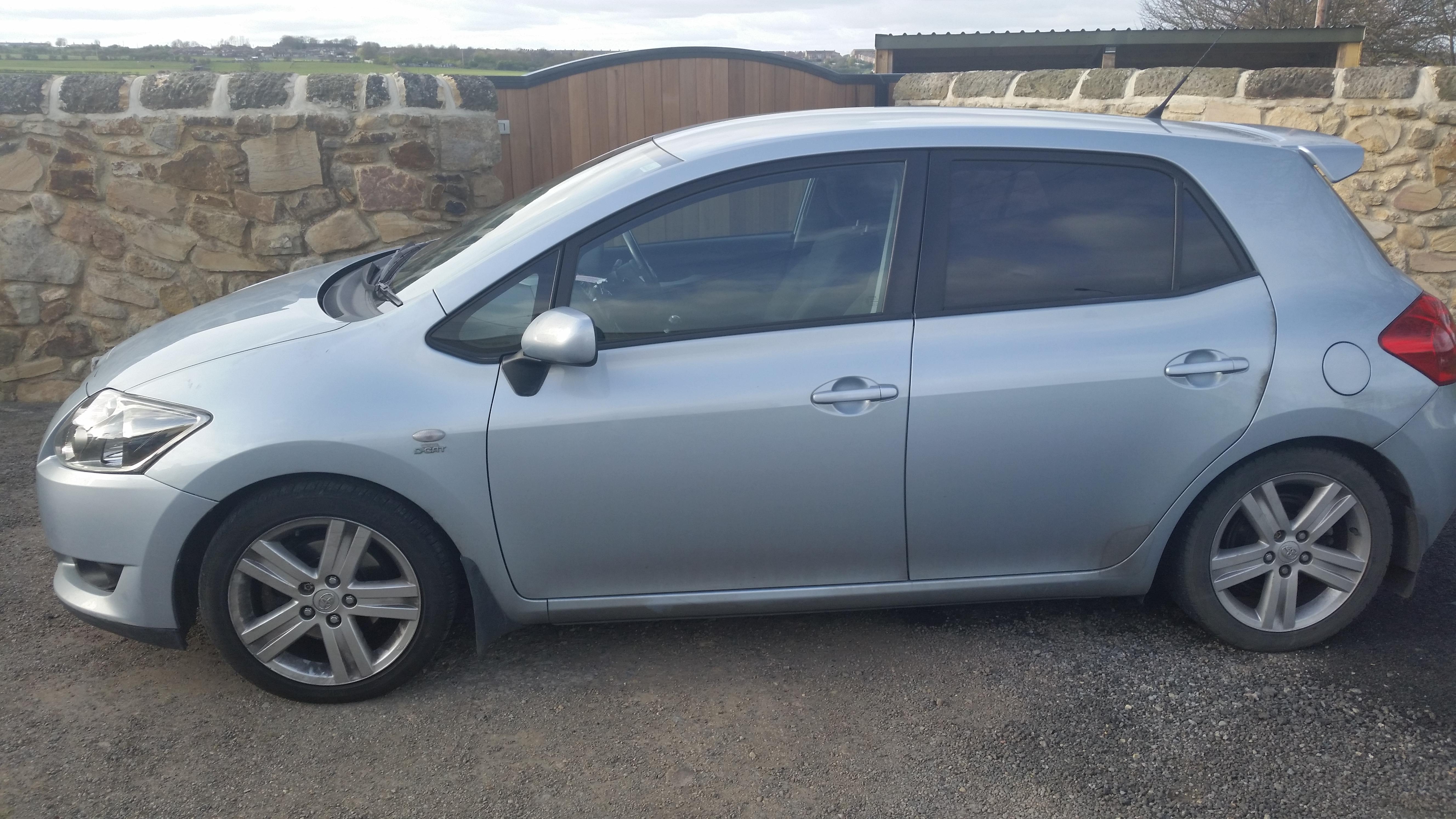

Finally as promised pics of how my car sits. Everything looks ok to me
