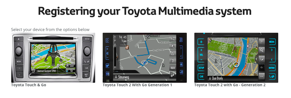

5 minutes ago, Mick F said:
They want you to register your multimedia system, but we don't have one.
You don't have a Toyota Touch or Touch 2 system?
Don't know what it's called.  The car is a 2014 Hybrid Excel.
We have a screen that will show the engine and Battery and fuel consumption, we have DAB radio and MP3 and FM radio. We have full audio and bluetooth hands free.
No navigation, no internet.  There is a settings screen, but I've not checked it all.  I do know there's no way of downloading anything.
Note to self:  Check on how all this works properly.
Mick.
We don't have any of these that would show anything like that.
You probably will have, on a 2014 I imagine it will probably be a Touch 2 system (& if you have bluetooth you may well be able to access the internet via a connected mobile phone).
I'll check, but playing about with it earlier, there seemed very few facilities.  No doubt if I wanted to, I could access the internet actually on my phone, but I couldn't see anything to control that from the car.
Touch2 and Touch and Go, neither of which are like ours, and Vehicle Customisation was blank.
Mick.
does yours look like that featured in this? http://blog.toyota.co.uk/2014-toyota-yaris-introduces-aupeo-audio-streaming-service
