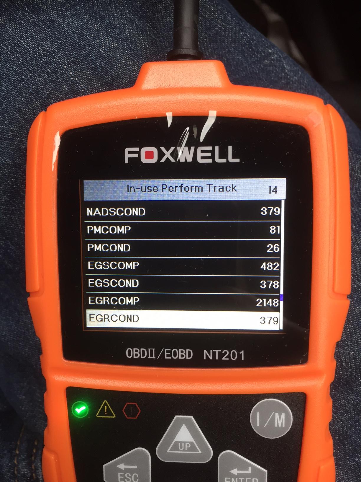

Just over three months in and 3,000 miles further, I go a warning light - I bought a cheap ODB reader.  It reported that the EGR valve was stuck open.  Probably needed a clean according to the internet but my local dealer replaced it under warranty so no bother there.  The smell and the fan have stopped after the fix.  My guess is that the car was attempting a regen, perhaps as a result of the EGR being stuck open.
I'd like to keep an eye on the DPF and how often it regenerates.  We do a real mix of driving.  Mainly the school run and shopping but once every 2 weeks or so it'll be on the motorway for at least 15 - 20 mins and I'm averaging a longer run (1-2 hours on motorway) once a month with work at the moment (but frequency not guaranteed).  I think we treat the car and the DPF fairly, but I'd like to make sure, especially if I don't do a long run with work for a couple of months.
There are various numbers reported through the ODB system including "PMCOMP" and "PMCOND" (pic attached) which Wikipedia describes as PM Filter Monitor Completion Condition Counts and PM Filter Monitor Conditions Encountered Counts.  The current readings are PMCOMP 81 and PMCOND 26 and we've done somewhere just over 13,500 miles.
Can anyone help interpret what these mean and/or tell me how to keep an eye on how often the car does a DPF regen?
