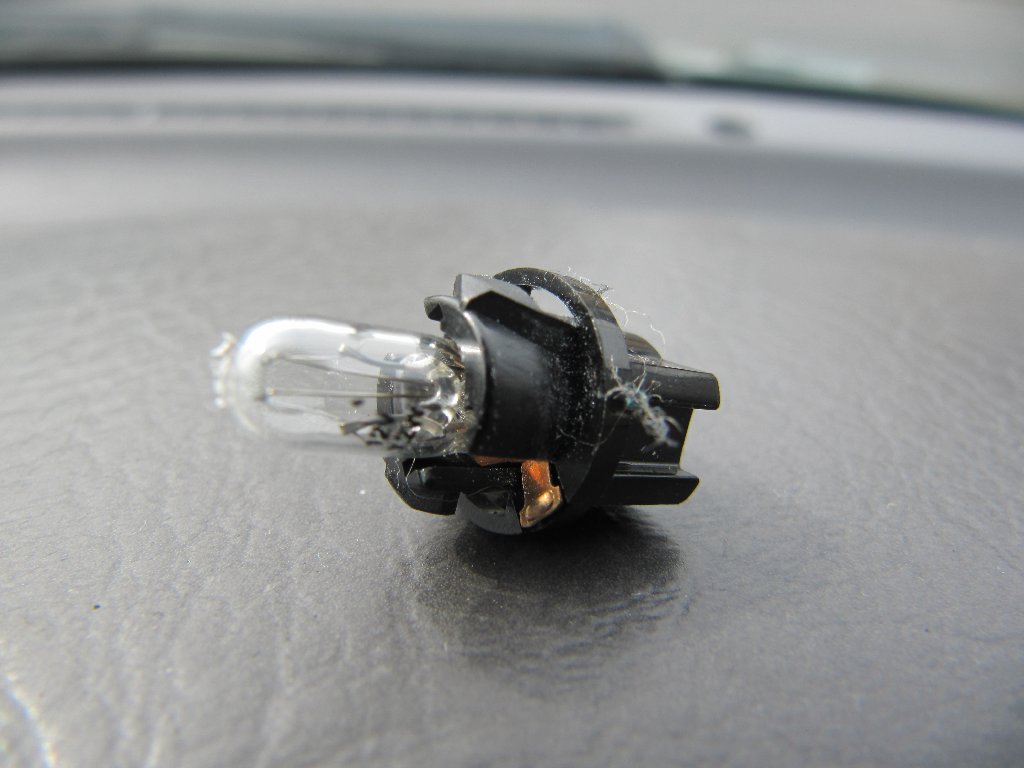

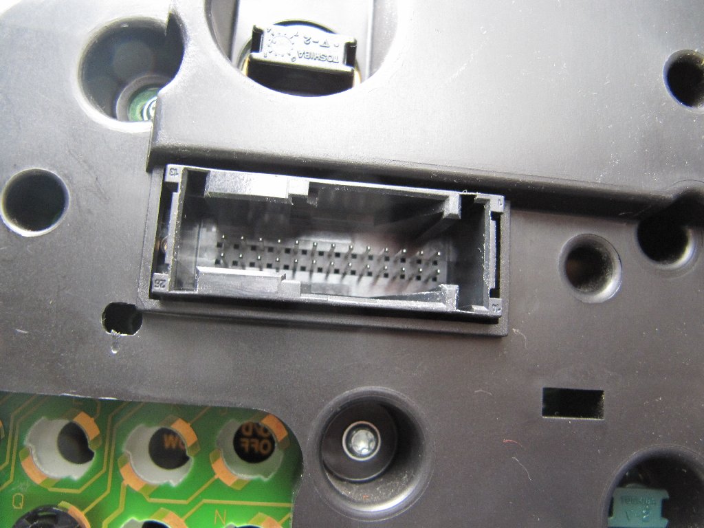

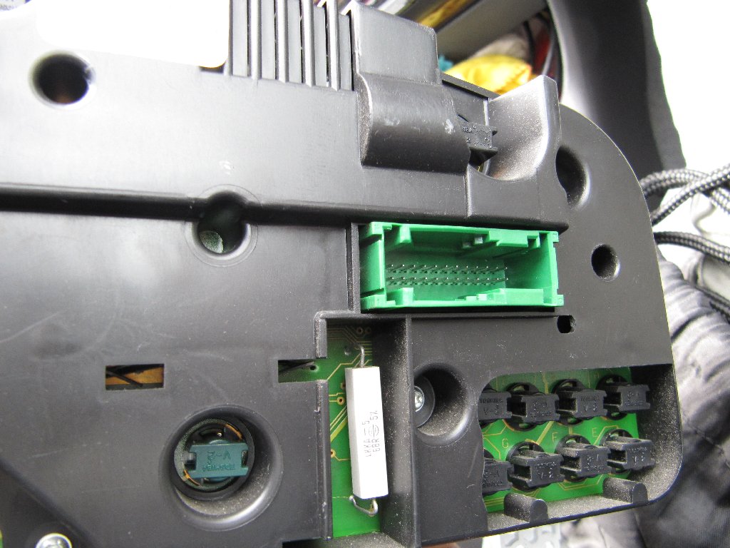

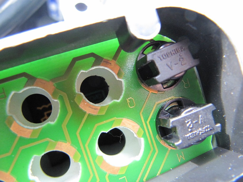

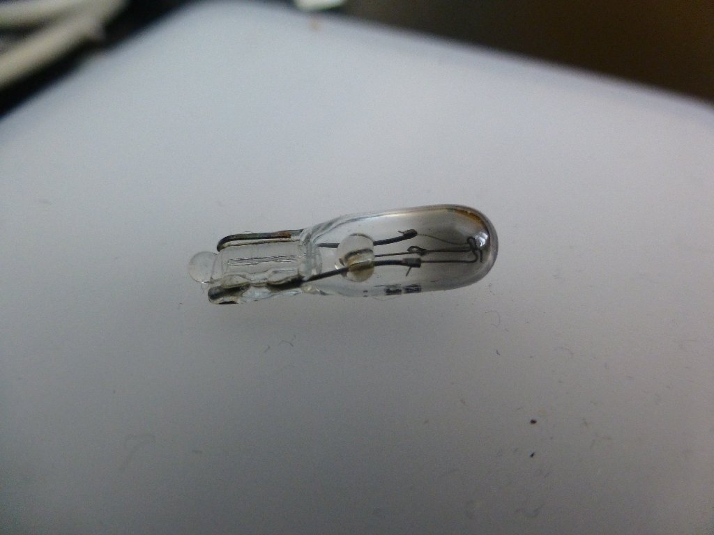

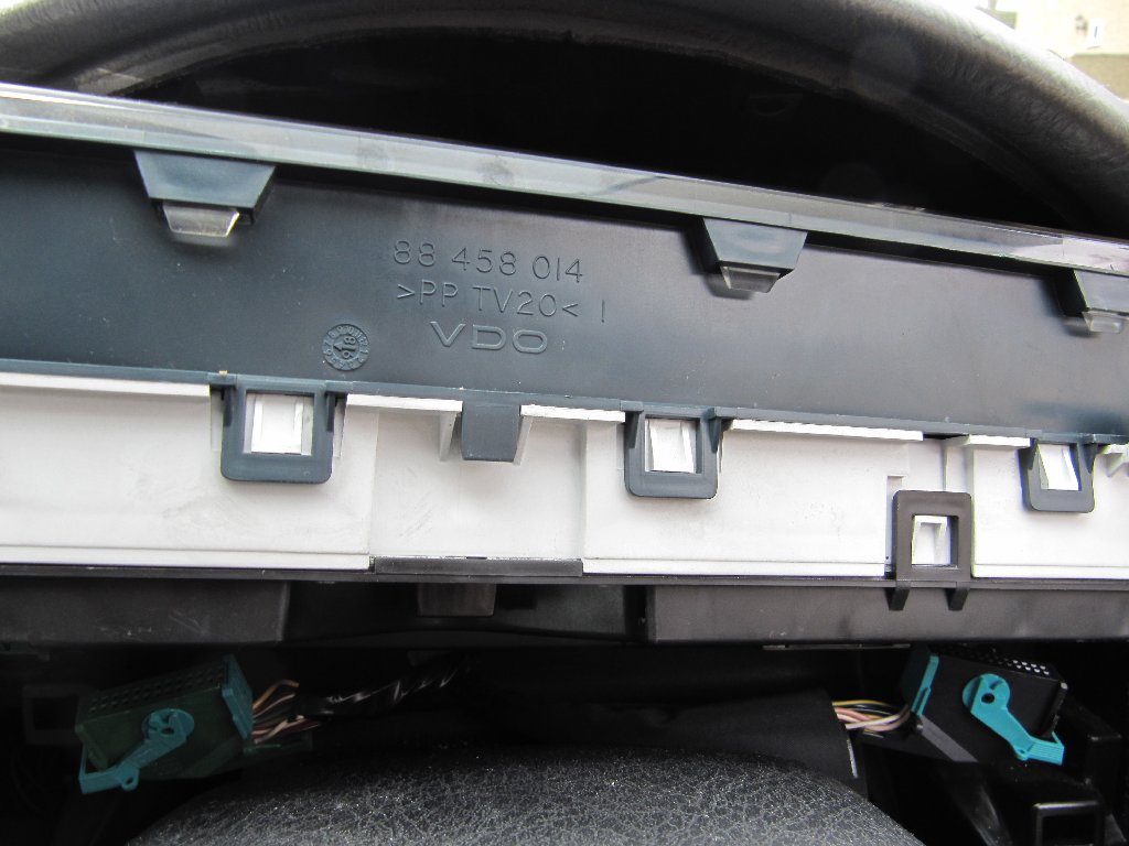

Hi Michael.
I searched my archive drives and found some photos of when I was replacing bulbs at the back of the instrument panel.
IMG_0320-1.thumb.jpg.bf3df0c001a5946d35ef067c21f65c35.jpgIMG_0318.thumb.jpg.1d071b629299a2b88672abe5eacb9029.jpgIMG_0319-1.thumb.jpg.2d56e85af3cb71dbe4a70f274775629e.jpgIMG_0315-1.thumb.jpg.c2dade9c46d4e1d2843da82fdcfb0b45.jpgIMG_0317-2.thumb.jpg.ceff6d573ec50729bb7d7baeaa9e95ed.jpg
Those photos go back April 2011. I still have to look for a photo of the dash warning indicators all on.
