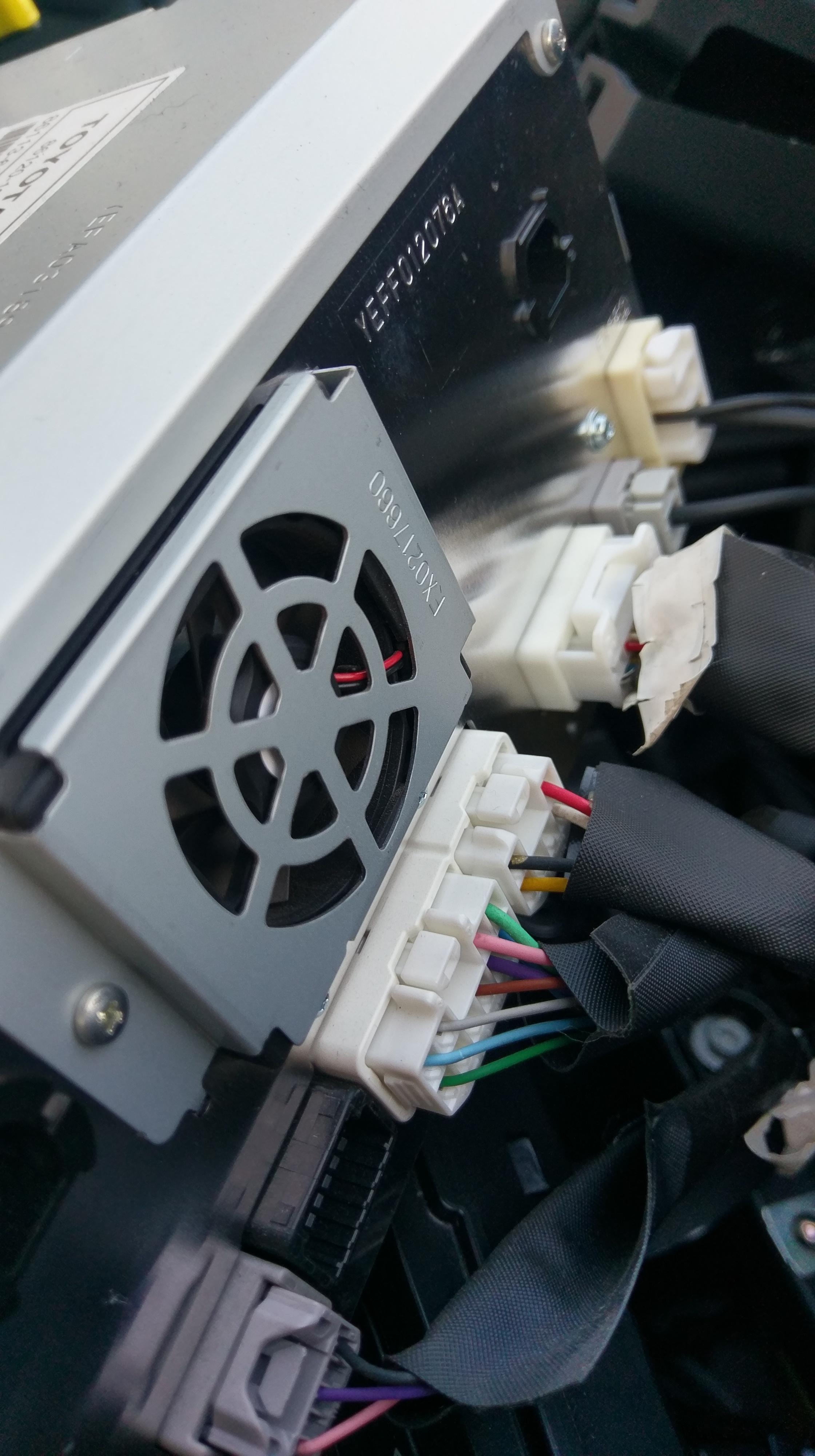

I've been looking at getting an Android head unit but I've come to realise its not as simple as it should be, I've taken the unit out for a quick look what I'm playing with and I think I've worked out so far:
(far-near)
Aerial, GPS, Steering wheel controls & camera, rear Speakers, front Speakers & power and what I assume to be the reverse gear sensor?
Then I started to look for a head unit. They all seem to be RCA connections? Some even state not suitable for hybrids? So far I've found very little in getting from the plugs I have to a different unit.
Is this a Toyota thing? A hybrid thing?
Any insight, help, assistance, words of warning greatly appreciated. I feel like I'm looking for answers that don't exist!

Hi Shaun,
Apparently it's complicated to replace the head unit, but actually is not.
If aerial connector is not the same, you can find an adapter; regarding GPS system, new head unit must have it's own antenna.
Unfortunately, you lose steering wheel audio controls unless you are lucky to find an adapter for that...
For power and Speakers (those two big connectors in the middle of head unit) Toyota - ISO adapters can be used, the most of media players have ISO connectors.
For rear camera you can cut the existing connector, and solder a RCA. +12 V signal for camera can be taken from reverse lamp switch situated above gear box and route the wire from engine compartment to head unit through the fire wall grommet.
Good luck !

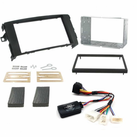

I've seen this:
https://www.dynamicsounds.co.uk/toyota-auris-2007-double-din-stereo-fitting-kit-fascia-and-steering-stalk-control-black.html
Looks like what I'm after?
I'd like to keep any cables in one piece if I can, so I'll have to look at cutting into the cam connection 'down the line' in case I need to swap back again.
