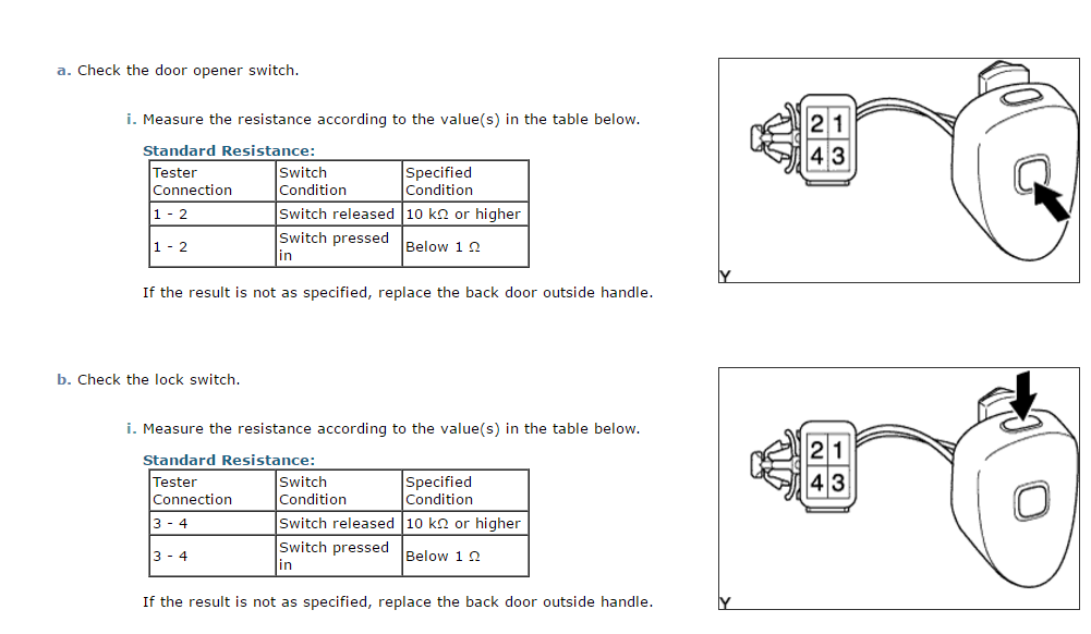

I have tested the unlock button as stated in the workshop manual and the button seem to working well, see below.

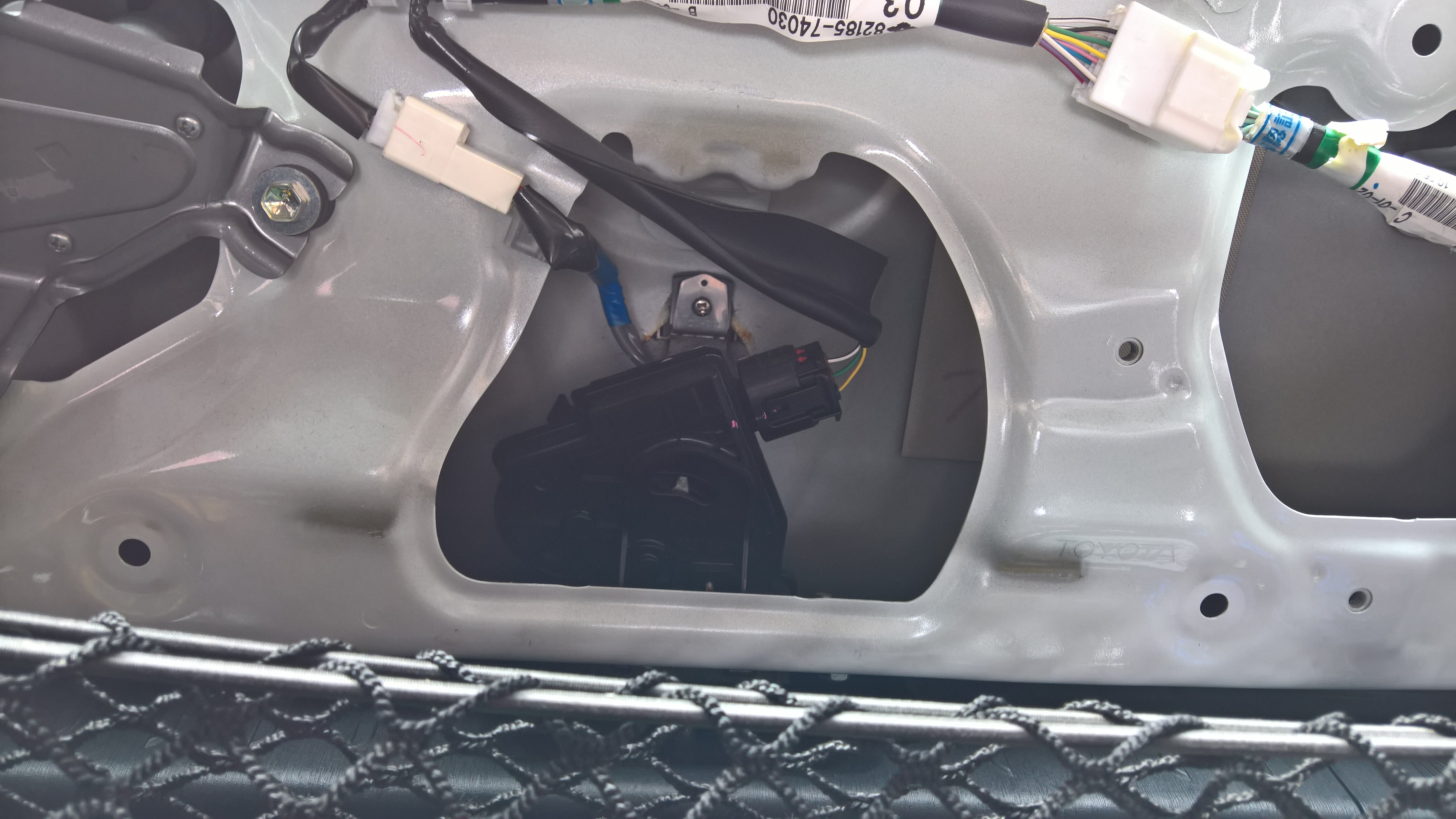

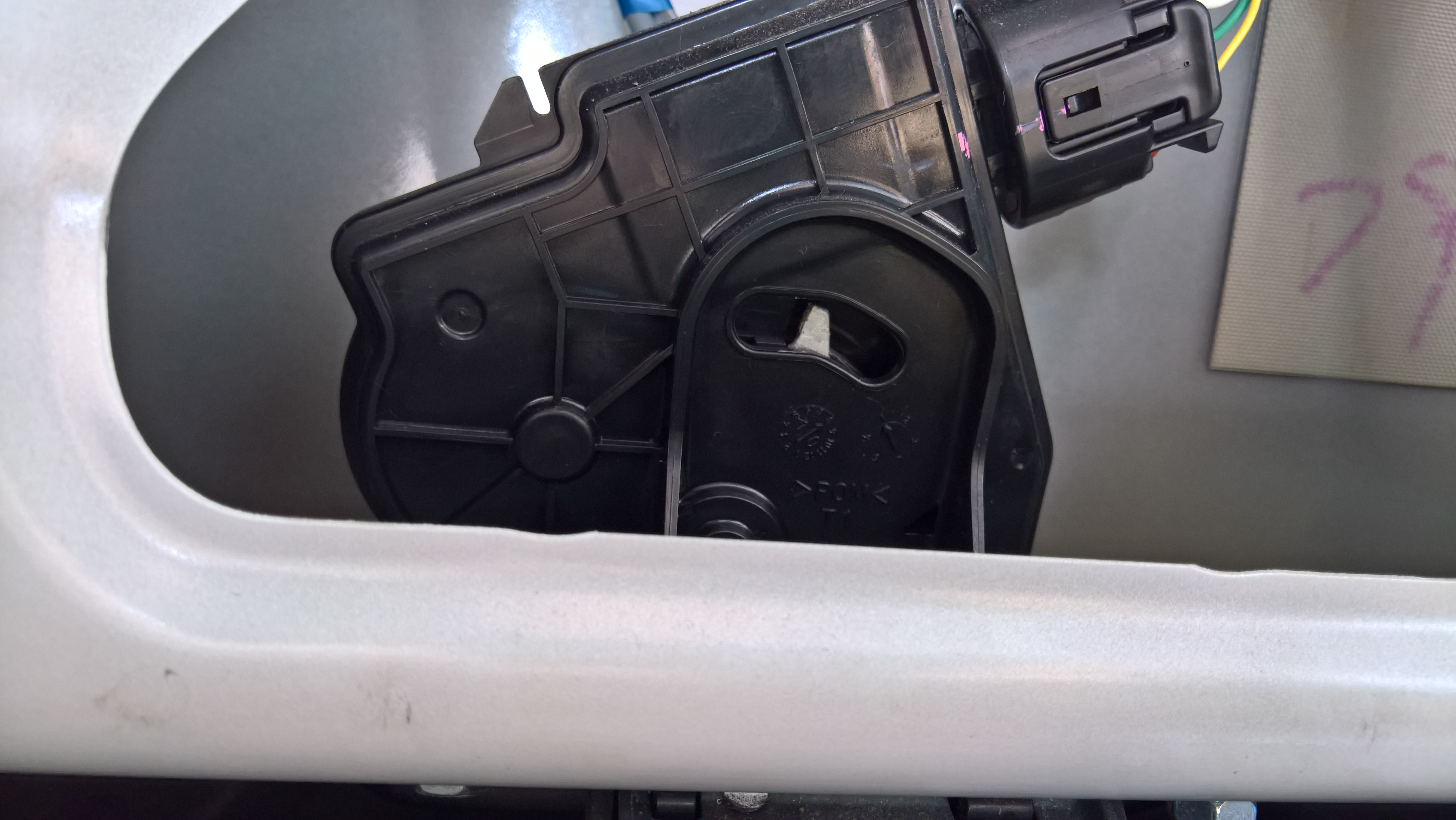

Craig, remove the trim from the inside of the hatch to gain access to the lock\solenoid assembly. There is a little lever, just move that downwards.
Ah, got you now. I never went to the hassle of removing the inner trim.
