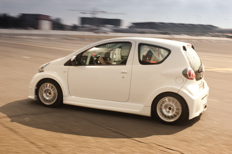

Am sure I saw something about a mk1 Aygo with a 2.0i engine shoehorned in instead of 1.0?!
Shoehorned? Might as well have stuck the wheels straight to the engine!
