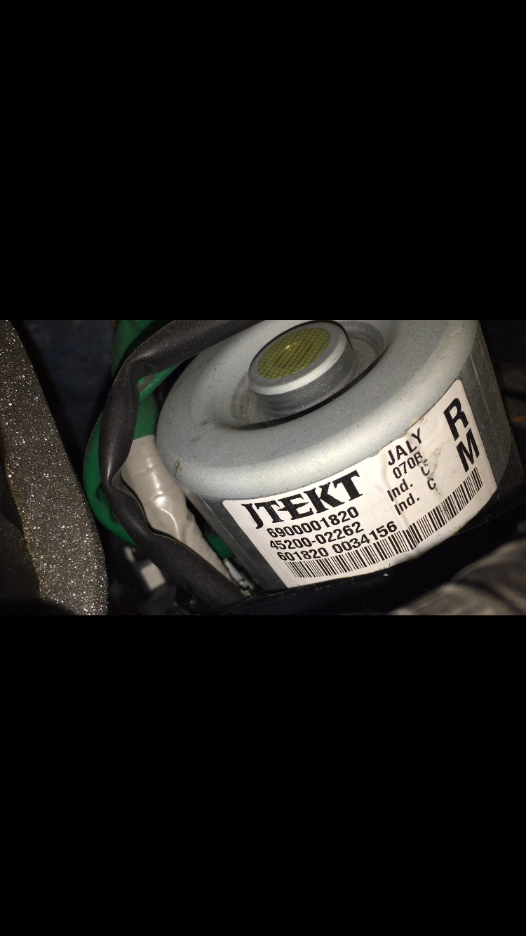

Which is the part number on this that I need to look for?
The part number you are looking for is 45200-02262 so long as the replacement carries the same part number it is compatible, bit of an unusual part to need though what is the fault?
There's an horrendous knocking/rattle coming from the column. Rattles like crazy over bumps in the road going at slow speeds, and also rattles (the same noise) when you quickly shake the steering wheel side to side.
Weve taken the intermediate steering shaft off and it still does it, so the ruled that out and anything under the car.
We then removed the steering wheel and airbag at the top end of the column and it still made the noise. It seems like it's coming from inside the column or the column shaft which runs through the electric unit. I have a feel it's where the top shaft on the steering wheel connects to the bottom shaft on the electric unit.

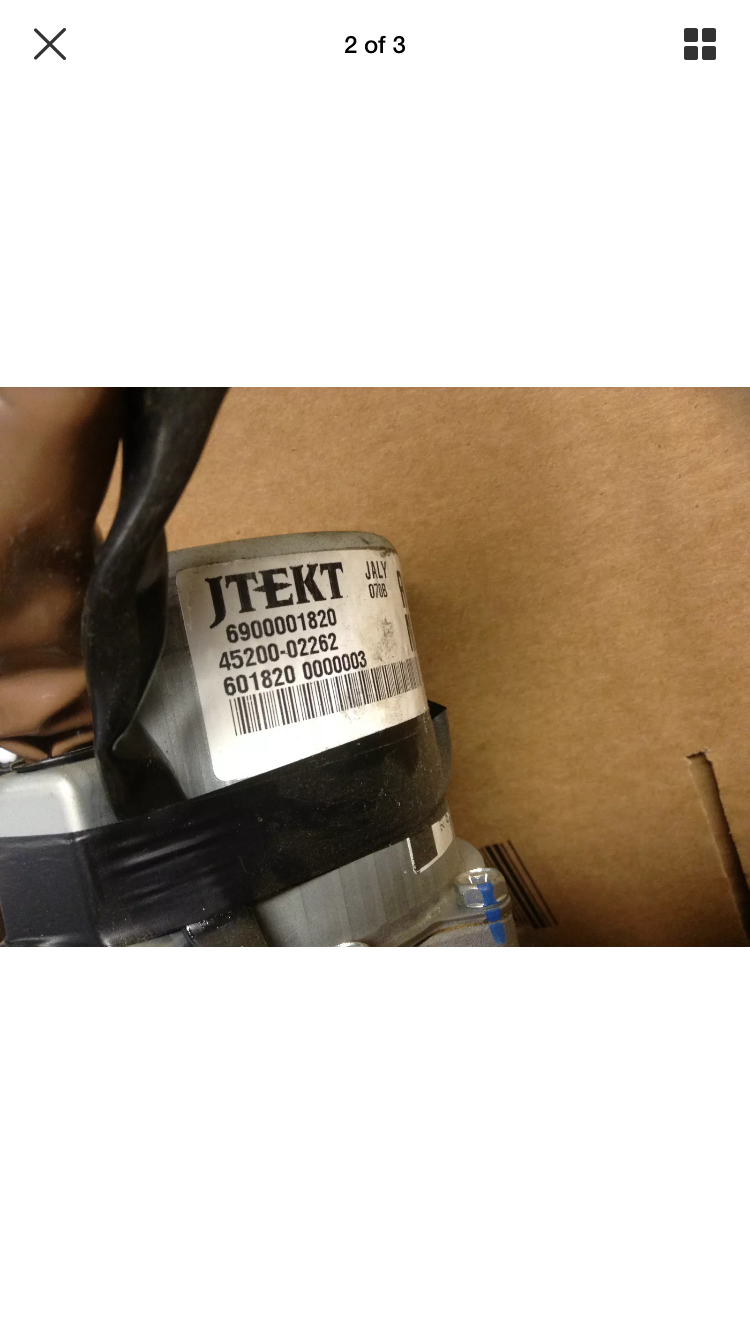

This is the one I've found online for a decent price.
Only difference I can see is the colour of the wire covers and mine says Ind C what ever that means?? And the second part of the long number at the bottom.
this is the exact same as mine!
