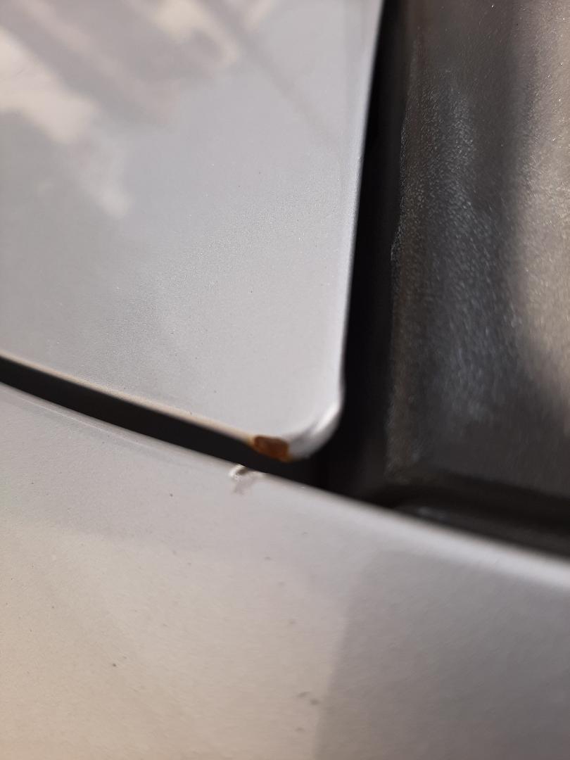

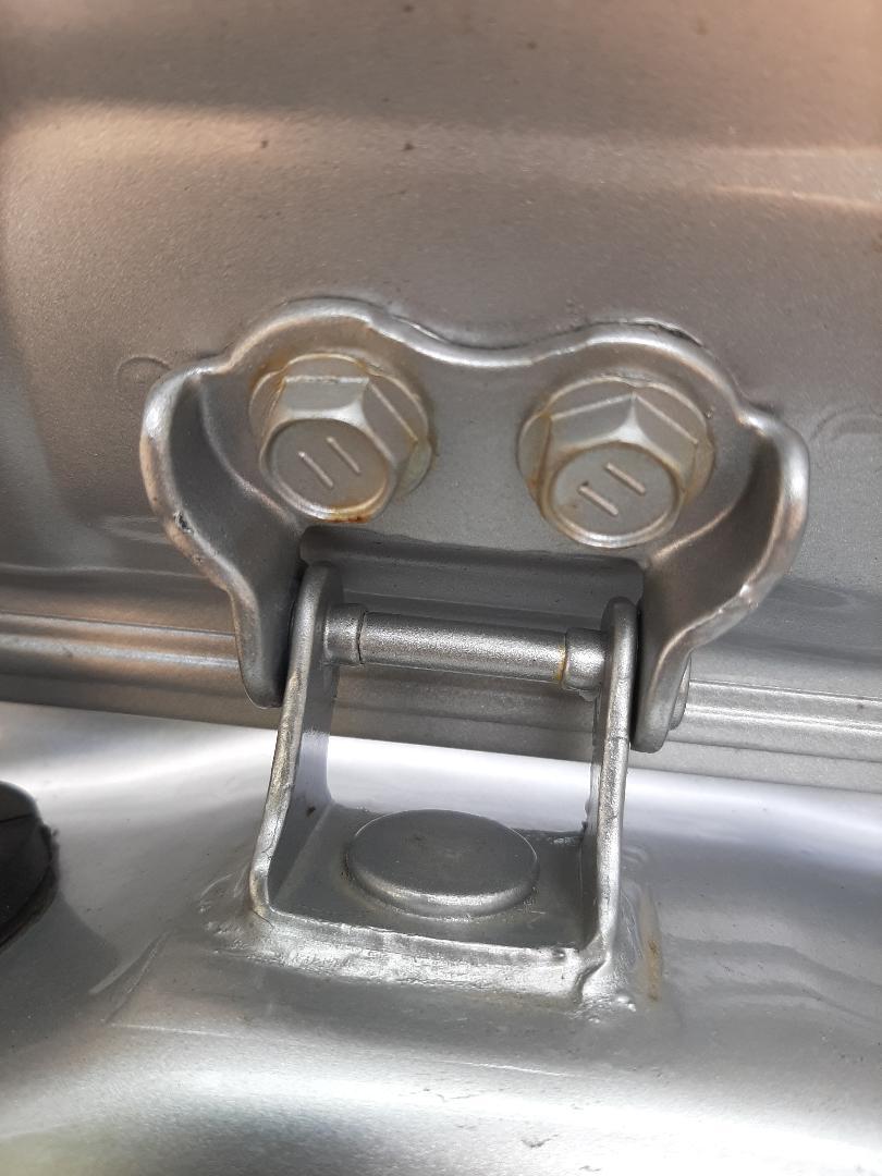

I bought a brand new Yaris 2018 in PR in august 2017. About a year later I noticed rust in the body area close to the hinges in the hatch back door. I also found tiny rusted areas in the hood. I recommend to all owners of Yaris to take a closer look to your cars because I have seen other Yaris 2018 with the same situation. Problem is the rusted areas are hard to see now, but will get worse with the years. When I took the car to the dealer they didnt cover all the rust problems of the car because they say is was caused by impact, but is not true. Check your cars.
O bought my Yaris 2018 brand new in year 2017 in Puerto Rico. A year after the purchase I found rust in the body close to the hinges of the hatchback door (which the dealer repaired), on the screws of the hinges and very tiny rust spots on the hood. the dealer dont want to fix all the rusted areas. Check your cars.

The first photo does look as though it could have been caused by an impact - stone chip or similar. In which case the responsibility to repair would be the owner's. The hinge repair would have been done under the paint warranty.
The Toyota US warranty may be different to that of the UK, where Toyota Owners Club is based and where the majority of members reside.
I agree about the first picture. It does look very much like impact which has been neglected, not a warranty issue.
I can only see a bit of surface rust on the two hinge bolts too. Easy for owner to rectify.
Rust spots on the bonnet/hood will probably be untreated stone chips and not covered by any warranty.
