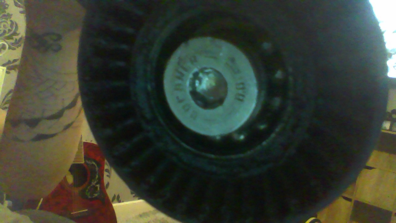

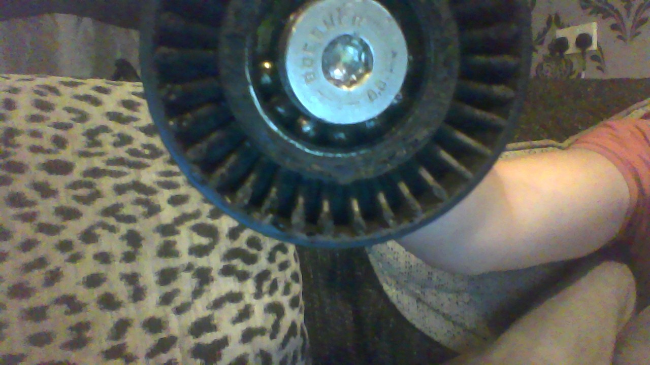

Got it off but when I took dust cover off to take the pulley off ,,now I know this pulley definitely needs changed lol
the garage i bought the car from said this has been done aswell as everything else I've done to it
I think this is a t70 to take this off but doesnt look like it would work
might take grinder do 2 straight edges and get the adjustable on it
now just need to find new bolt to put new pulley back on
