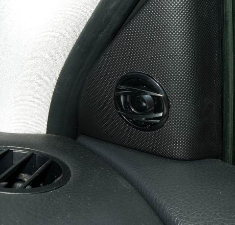

Which Pioneers are you looking at , the 3 way TSA17331, they are similar in todays money to the ones I fitted in 2011, so they should give a good sound.
Pic below of my tweeter by the door mirror covers , which are where yours should be if fitted.

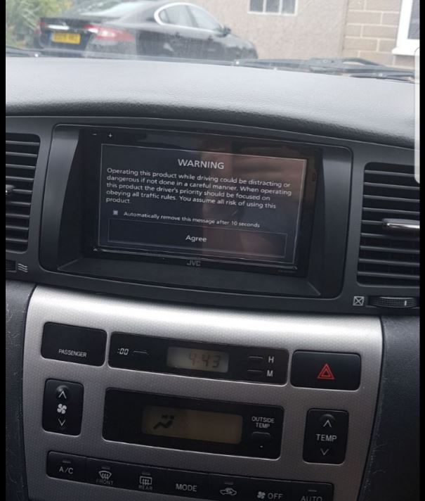

Little update :)
Has anyone used the connect2 steering wheel control adapter?
Theres a noise coming from behind my new stereo, kind of like the noise a CD changer makes when changing CDs however theres no CD player on the Stereo. Only thing i can think of is that connects2 adapter has some kind of moving part.

I would think its more a question of if the steering wheel controls will work on your new head unit; perhaps one to ask connect2..
Never known of a moving part inside such units, more likely something is rubbing /creaking with the movement of the car |? so you might need to slip the unit out and ensure everything is secured down /foam around the wires/cables.
That bezel looks a good fit, what model is that and of the jvc unit ?

Hi Mate, the steering controls work fine! Its just the noise, the foam is a good shout. Would any kind of sprayable foam work? Is it easy to remove if i want to put original radio back?
The bezel is the Connects2 CTKTY13 Toyota Corolla 2003> 2008 Double Din Radio Installation Kit  from CAD.
The JVC unit is JVC KW-M730BT. It has android Auto which is brill as i can get google maps on the Stereo.
