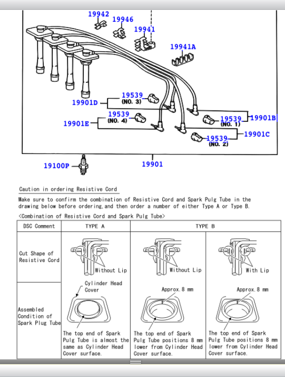

See the picture attached there is a choice for the correct cables depending on the picture shown
90919-22399 is Type A fitment
90919-22325 is Type B fitment
Dear seven sir
Kindly guide me..I am confused with this pics.
When I enter in catalogue it shows 9091922325..I am getting cable of 1.6l/1.8 l engine..Not 1.3 l ..Will it fit in my car.?
I can't interpret the picture for you, you need to look at the top of your engine around the spark plug tubes and decide if your engine looks like type A or type B then order the corresponding part number in my previous post.
