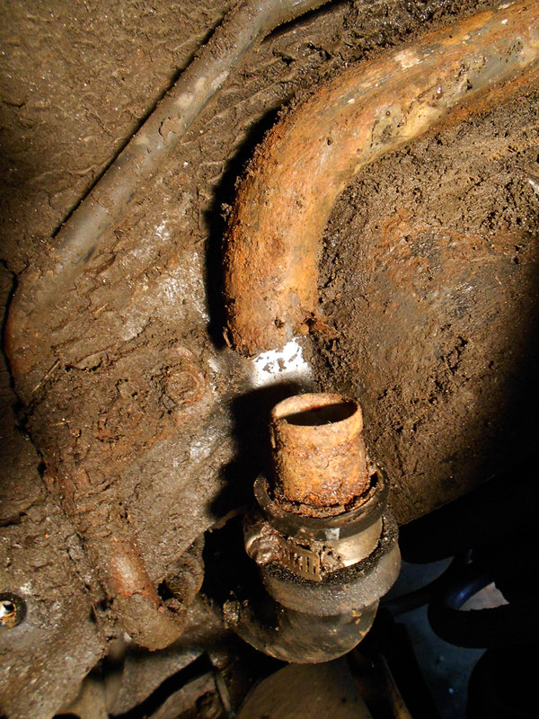

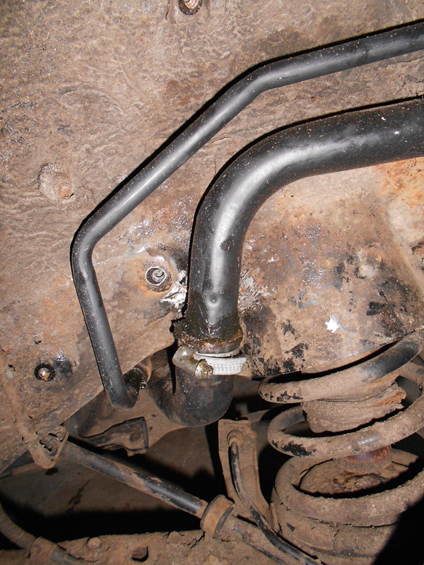

I was at a Sainsbury's petrol station, putting petrol into my RAV-4, and suddenly the pump cut out. I knew it couldn't be because the tank was full; it was almost empty.
Then one of the employees came out of their hutch to tell me that they had turned off the pump because they could see petrol pouring out from under my vehicle. I had just enough fuel left to get home.
The steel pipe had rusted right through and parted company with the rubber connection to the fuel tank. I guess that it had been quietly corroding for a long time, and then suddenly broke off (given that this was the first event of any leakage.)
I call it a design flaw. The pipe is in the wheel well, covered by a plastic plate, presumably to protect against stone chips. But when I took out the plastic bit, the rusty pipe was packed in wet mud, which is not known for its anti-corrosive properties. If your car's as old as mine (2004) it might be worth taking off the back wheel and cover plate and having a look.
looks great from a great manufacturer, you have done well really with it being 2004 model, mines is a 2007 and the wife's was 2006 both been well looked after, but both got badly corroded fuel pipes, my opinion not good enough Mr T.
