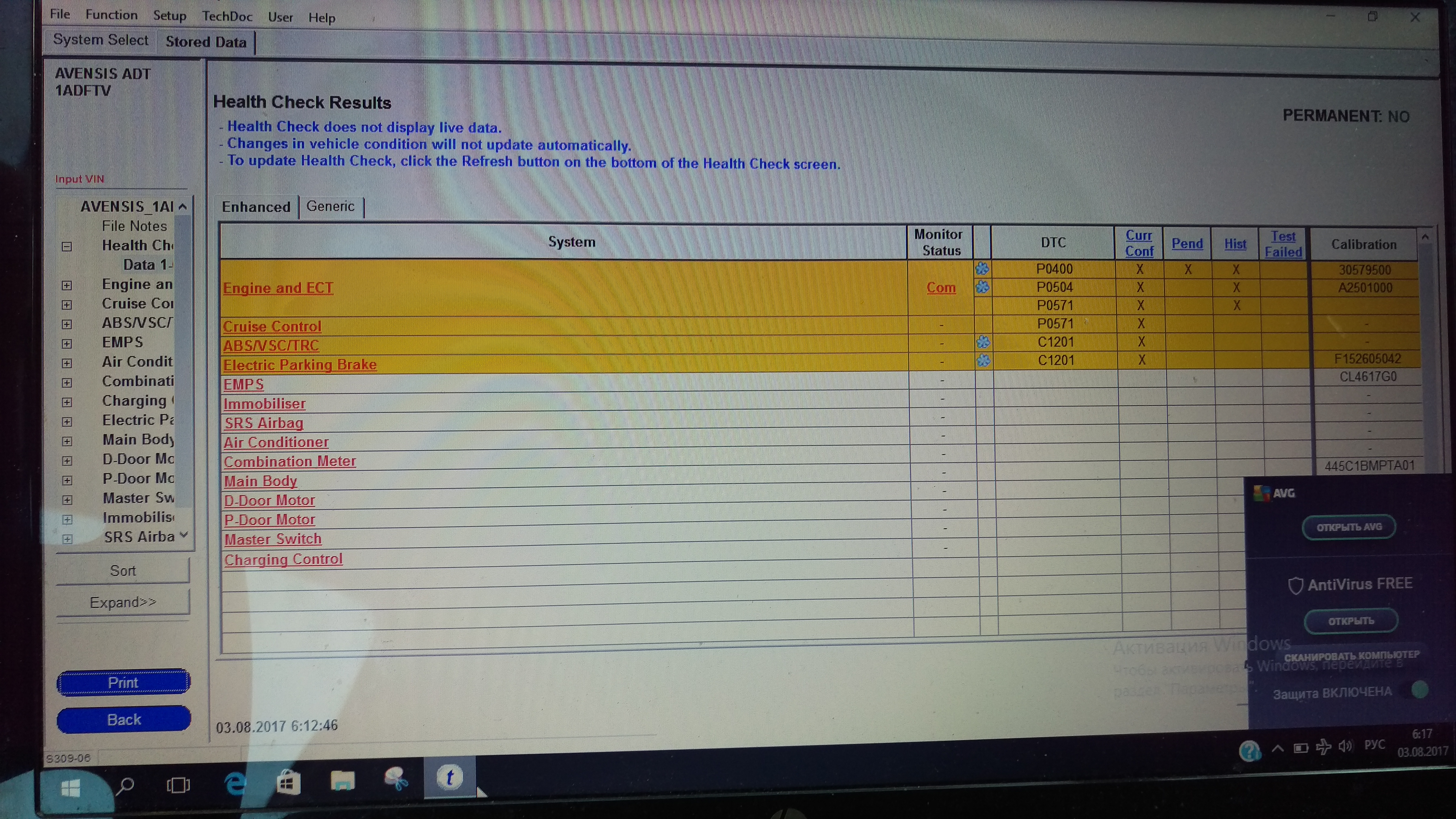

Deleted egr dpf and chip tuning every 200 km comes this, please are need your helpIMAG0029.thumb.jpg.1b1b73b02320e6909dd76049e6e17c02.jpg
Is the engine light on?
P0400 Is "Exhaust Gas Recirculation Flow" the car is detecting you have deleted the EGR as it cannot detect any EGR flow
P0504 Is "Brake Switch "A" / "B" Correlation" the car is detecting a fault in one of brake light switch circuits
P0571 Is "Stop Light Switch Circuit Malfunction" as above

Yes check engine light is on, so basically I can back to tuner, pedal sensor is OK, I checked spring is OK , and position also, all that bad stuff become from dpf in Slovakia after 900 km when I cut it off... so sad ,and also all those faults come in the same time
Tomorrow will check with tester led lights...
