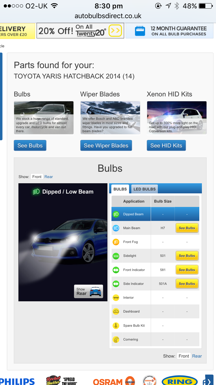

That's what I thought until Frostyballs replied. If I put my number plate in to lightbulb websites it says H7. When I put make and model it says HIR2.
