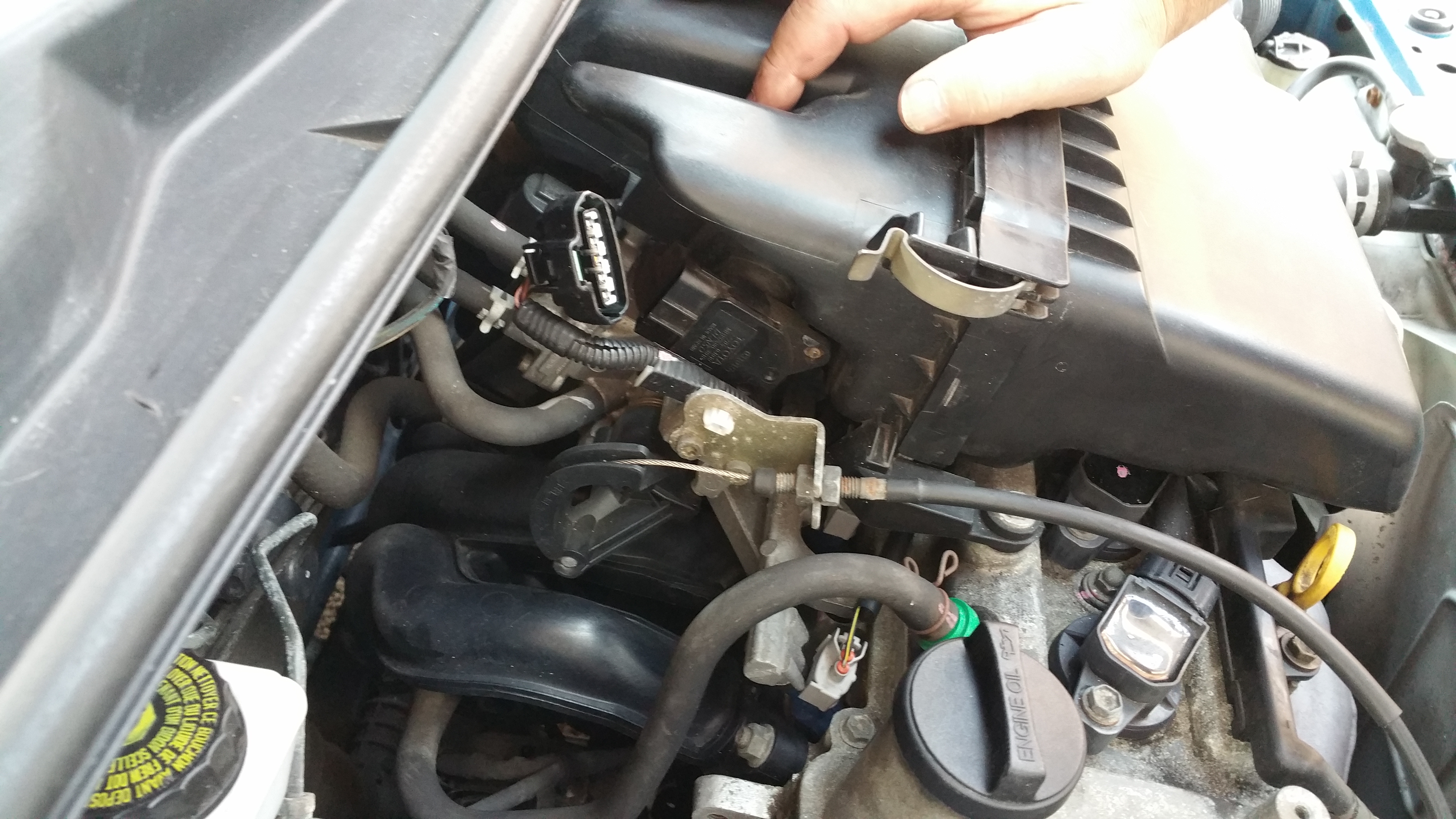

I have a Toyota Yaris 2003 T2 model and today out of nowhere the car started revving itself continuously. I have had a look at the motor and have taken this part/sensor off and the car is back to normal. So my questions are;
1) From the picture attached, can anyone tell me what part this is so I can look into fixing it?

1/ Mass Air Flow Sensor.
2/ Not sure it's dangerous to drive but I would imagine the engine warning light is illuminated and I would have thought idle speed will be erratic.
3/ Sensors can be purchased for less than £50.(They can also be cleaned with care as they're fragile).

I have tested the accelerator cable, all fine and secure. No problems there. My dad and I had a quick look to see what the problem is, thinking it was countless other issues but instead we tried this to which it worked. With this sensor removed the car stopped revving itself and went back to normality, driving like previously. Any idea why?

Yes, I have, the problem still remains. The problem is that even without the sensor, it is still erratic. So must be another fault.
