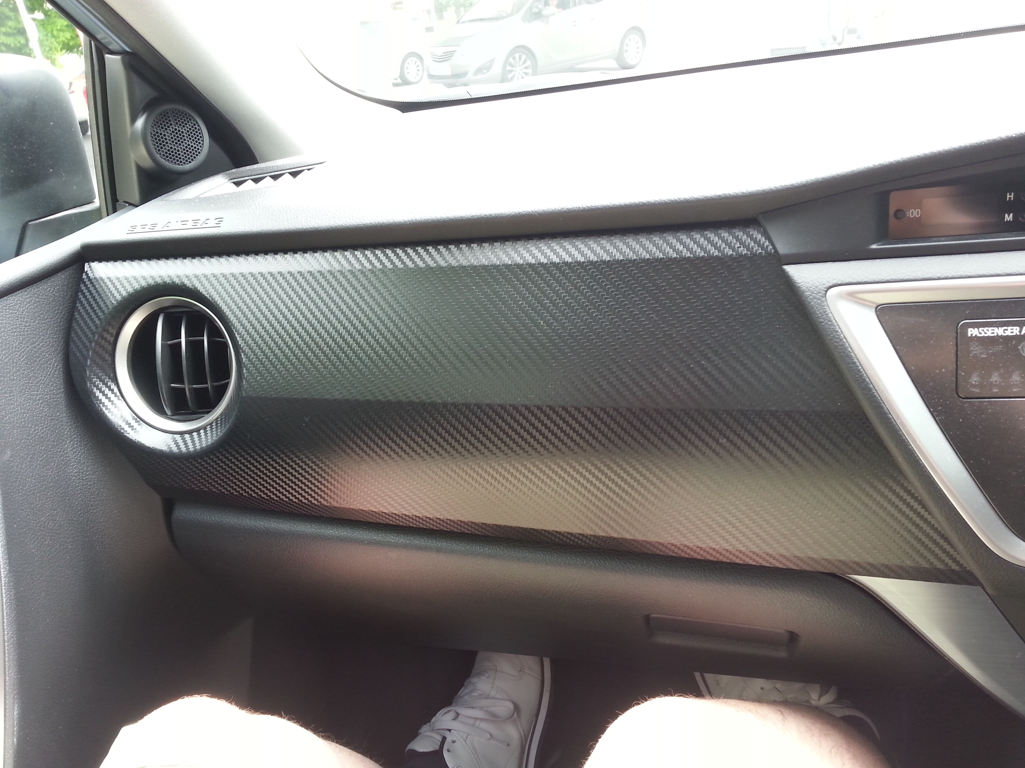

i have wrapped some dash panels in the Auris we have with a carbon fibre film.
Stunning job there, Mark.:clapping:
Can I just ask, did the hairdryer belonging to Mrs Eygo become involved or did you manage that great finish without heat?
The finish that you have got is flawless and the best compliment that I can give you is that it should have always looked like that....Well done, Sir!
well it wasn't the mrs's i'm not making that mistake again i happily divorced :biggrin:

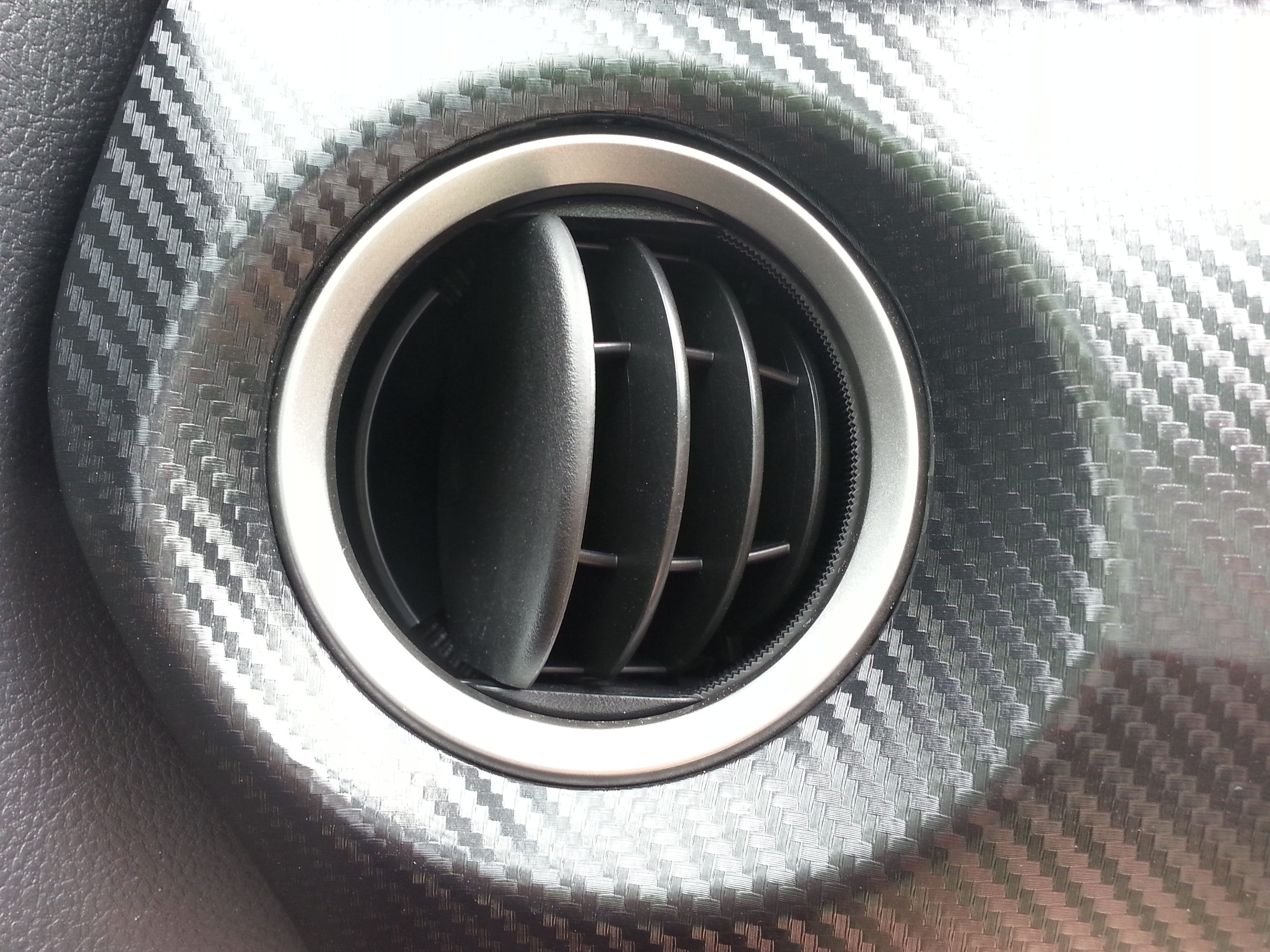

but it was my other half's hair dryer,for wrapping arounf the air vent i removed the vent
put a hole about 30mm in the middle then with heat rolled the wrap around the
inside of the panel this will stop the risk of the wrap lifting, in the auris hybrid
the dash panels have a bluey tint to them and when the sun reflected off it it was blinding.

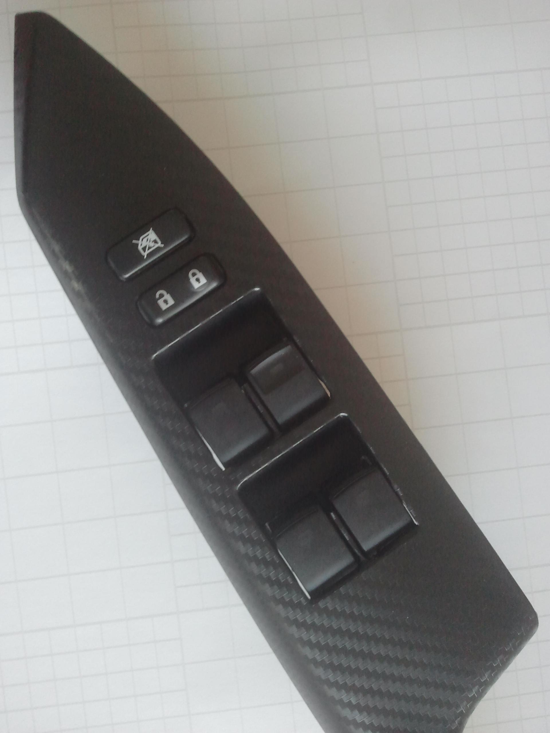

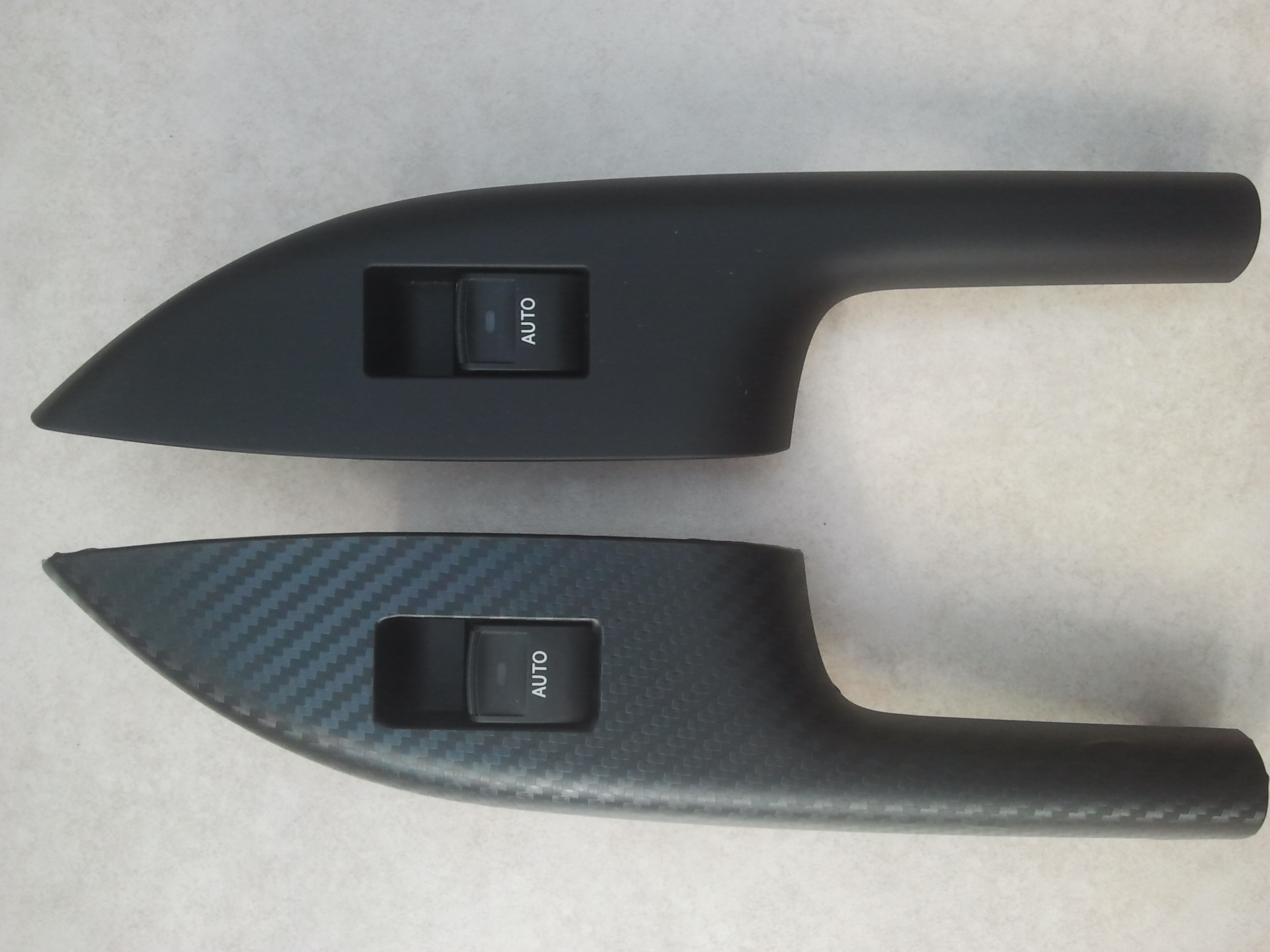

here are some images of my IS300h door switch surrounds.
