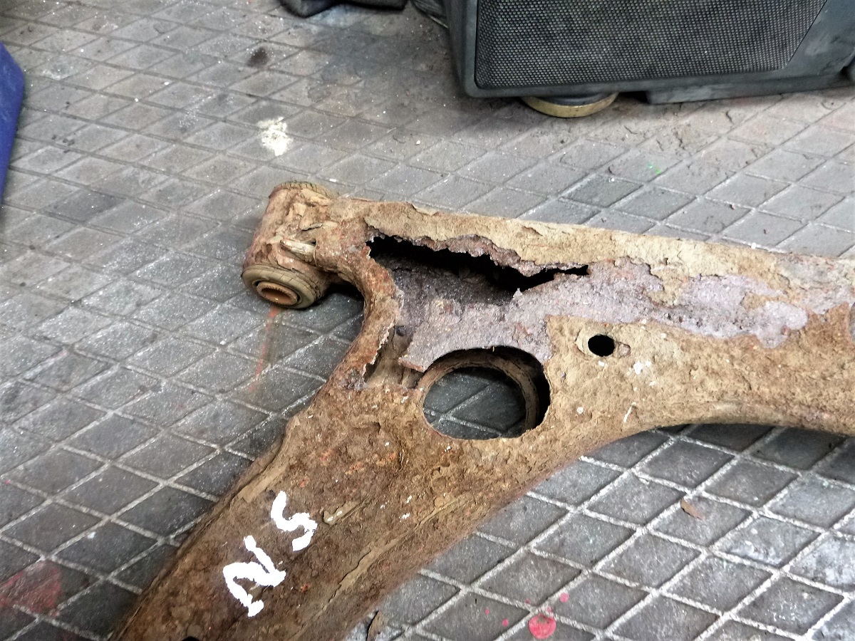

Was slightly alarmed to discover how rusty the suspension is on my 2006 Corolla. Car only done 80,000 miles, and the body looks mint. Is this normal?

If you live near the coast, or the roads are heavily salted in winter and you don't regularly wash the underside, then possibly yes.
Don't live near the coast, and do wash underside occasionally. Car serviced annually at main dealer since new. Had both arms replaced at a reputable local indie garage who said they'd recently seen a similar age Yaris just as bad. They also said Mercs of a certain age were worse. No idea if the roads in North Yorkshire are thought to be heavily salted in the winter compared to other parts of the country though.
On a positive note, you've had some good mileage out of them, considering the battering they get. Usually, the ball joints or bushes go before rust eats them.

Surprised you never received a mot failure or advisory as that kind of corrosion does not happen overnight.

Amazing what you find hidden underneath. Strangely, no advisory on the MOT, nor any warning from the Toyota dealer either until the car went back, a month after the MOT (not Toyota), for the airbag recall. Sorry, I don't know what make the arms are. Toyota quoted £300 for the one arm fitted. The ones the local indie sourced looked identical to Toyota's and were half the price, including ball joints.

After the problem was pointed out to me by the Toyota dealer who did the airbag recall a few months ago, I brought the car around to this independent garage and had a good look with him underneath while he had it up on a ramp. There was a lot of rust visible all around as you'd expect, but this by far was the worst of it. I'm not overly concerned now that I've replaced both arms and ball joints (Toyota only recommending replace the n/s arm in the picture). I'd had an advisory the year before for a corroded brake hose ferrule, but that really was just surface corrosion that was cleaned up. Curiously, it was the same MOT place who did the MOT this year and didn't mention anything about the arm. Won't be using them again.

Hi, I did car MOT's for many years and that is an instant fail, either the person that did the MOT wasn't very good at his job or he didn't see it..........is the hole on the top or the bottom of the arm? Mike.

A coach driver in the Yorkshire Dales was telling me today that there were traces of salt on the roads from November to March. So I guess you could say the roads where I do most of my winter driving are heavily salted. He didn't think it surprising that an eleven year old car might have serious rust underneath, which is what the first person who replied to this thread seem to be saying as well.
Incidentally it is 99.9% of the time that it's the N/S of the cars underparts that rot first due to the fact that's where the water runs to collecting all the muck/salt collects and the tyres splash it up under the car. Mike.
