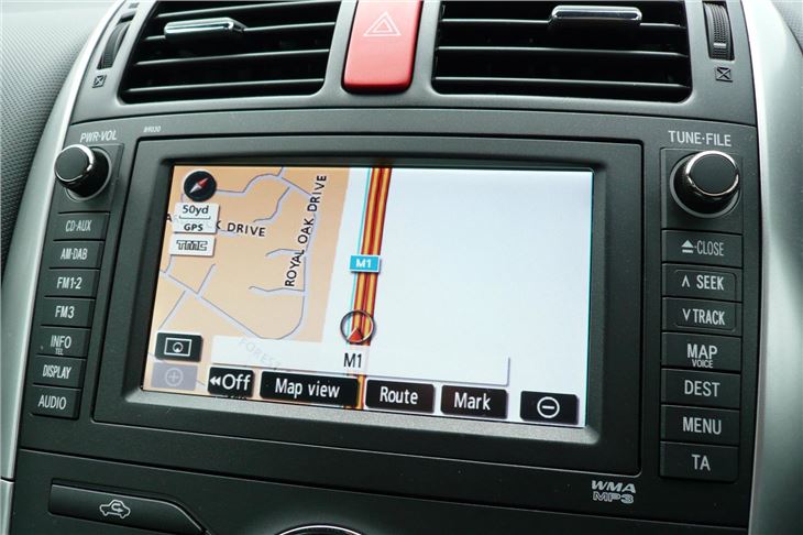

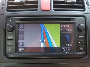

Hi all,
I'm viewing a couple of hybrid Auris T-Spirit cars tomorrow and have noticed a difference between a 2010 model sat nav hardware in comparison to the 2012. Does anyone know what the difference actually is other than the obvious aesthetic changes? Are there any worthwhile technical or GUI alterations worth considering between the 2? I have attached a picture of both for reference.
Also, is there a buying guide or any pointers to look out for on these cars like common faults that I should be aware of?
Any advice welcomed,
Regards,
Joel.
2010 car:
2012 car:
The 2012 Auris will have Toyota's later Touch multimedia unit and if it has the satnav module, then it will be Touch & Go. No CD.
The 2010 car will have a completely different, older design radio/CD/satnav unit, which, I think, dates back to 2006.
The Touch multimedia units were replaced approx two years ago with the Touch 2.
check if the 2010 uses an SD card or a hard drive or what for maps & updates.

The first generation Auris hybrid went on sale in the UK from May 2010, and the second generation Auris hybrid went on sale from December 2012.
The photos in the OP's first post are the dashboard from the first generation Auris.
