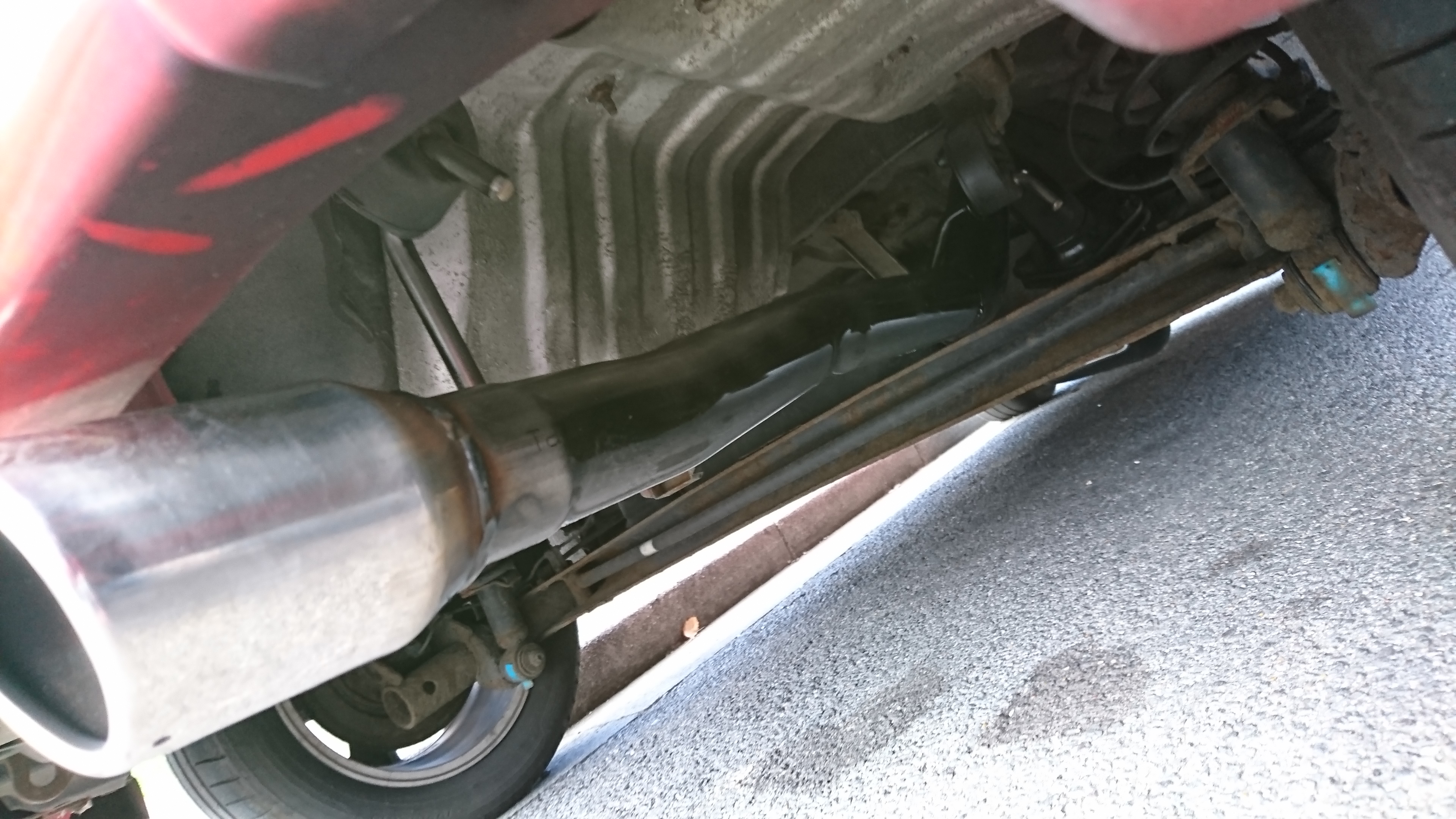

Hi, from what you have written do you now have a Toyota standard exhaust or a made up copy one? Mike.
It's not original it's the same exhuast with boxes removed and straight pieces placed between etc. I don't think it's the exhuast. The work was done from the cat back. It isn't a turbo whistle sound as I can hear that it's like a slight metal on metal sound but hard to say.

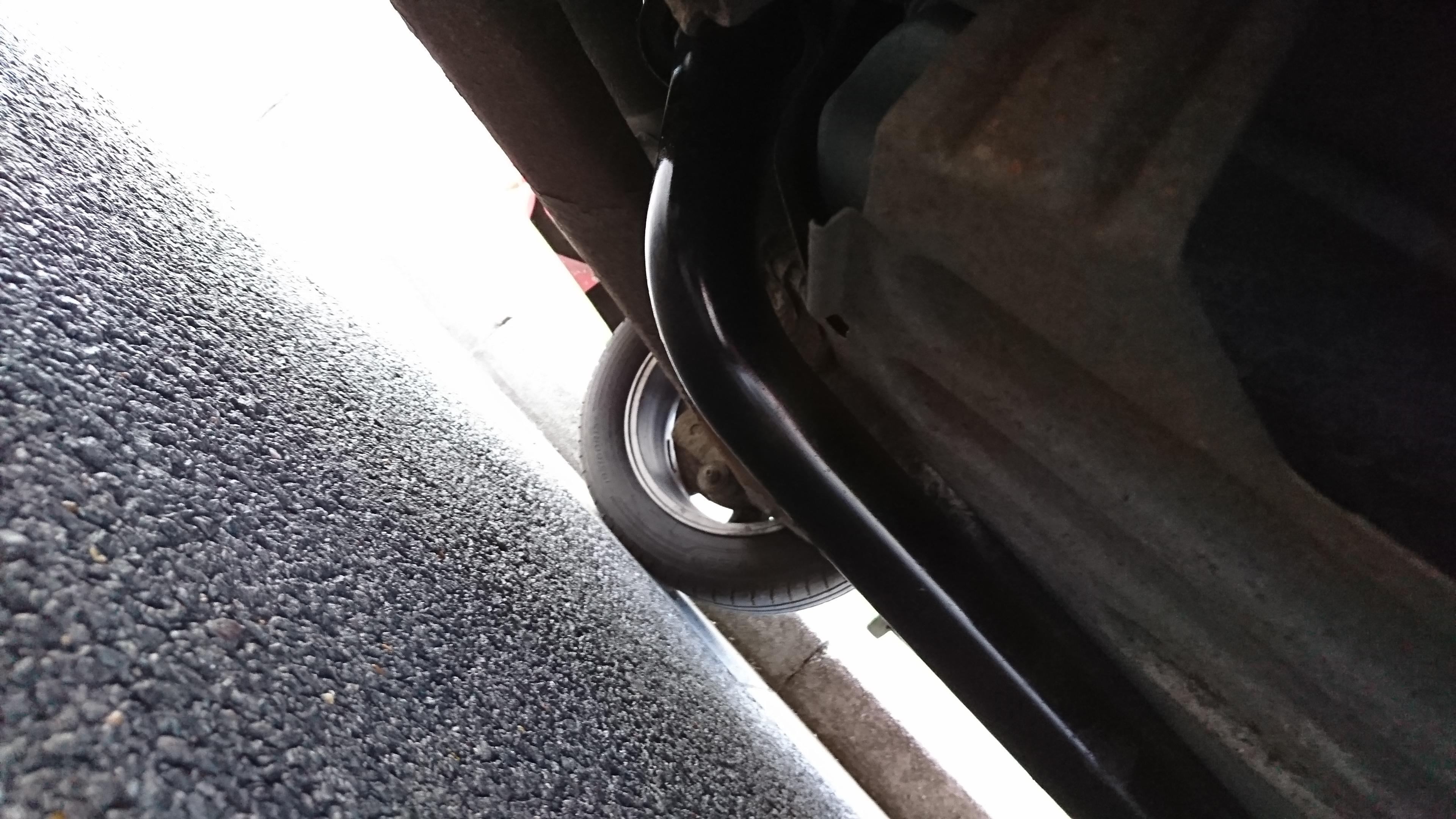

This is the exhuast now quite a neat job from a reputable place DSC_1499.thumb.JPG.5396c11046f5cdc21709124377808015.JPG
