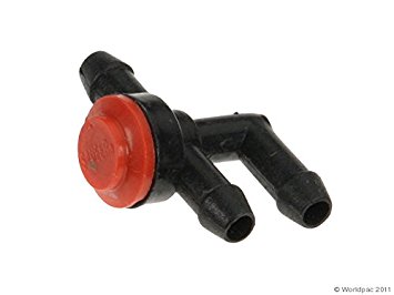

Usually there is a one way valve in the Y-shaped junction in the pipework. Could be that the valve has blocked. Try tracing the junction and see whether the valve is operating OK (ie allowing washer fluid through) - if not replace the junction.

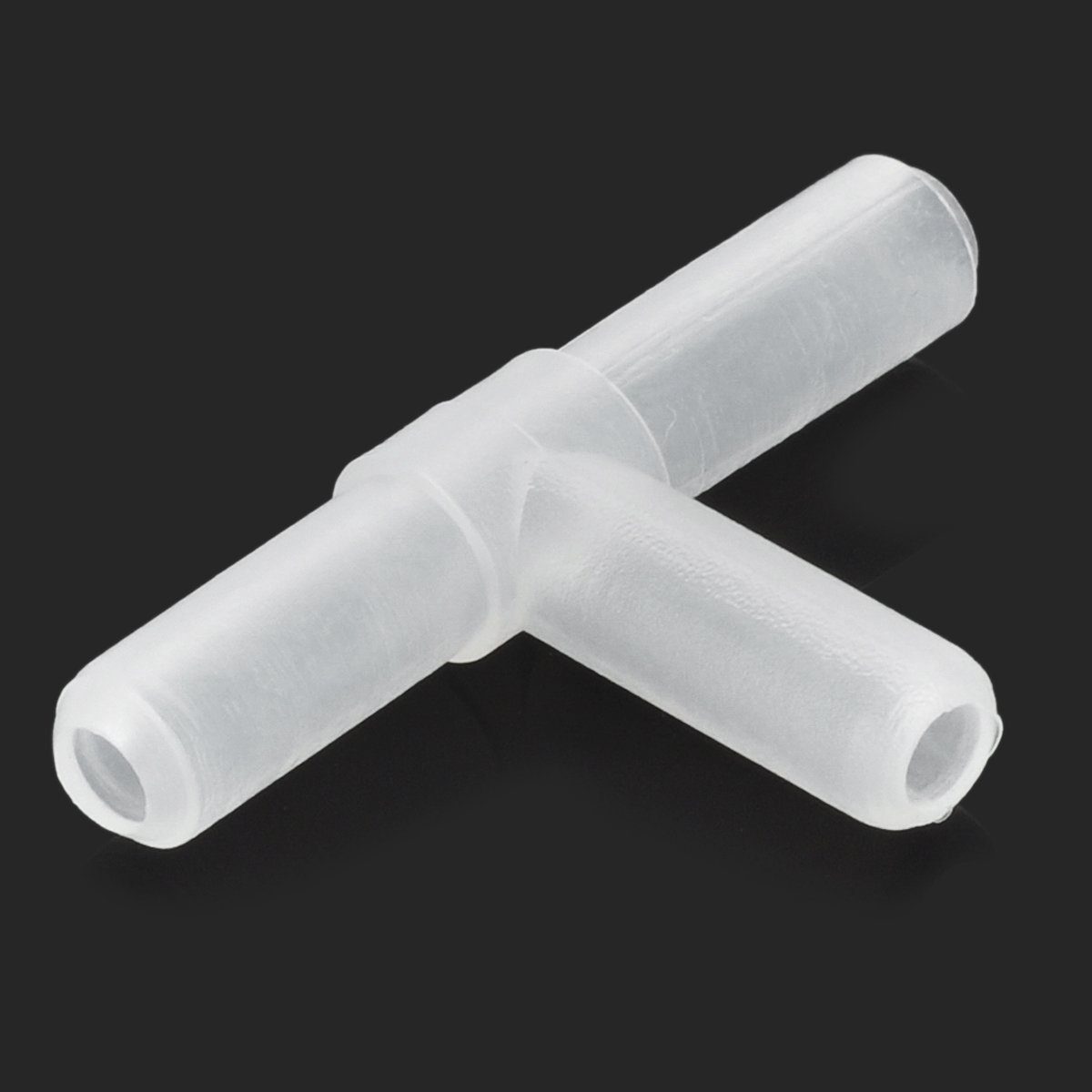

I`ve replaced mine with T junction for aquarium usage. Working fine now. Factory splitter works as non-returning valve also. So if you replace it with regular T, you can expect a little slower reaction from jets. But otherwise is ok
