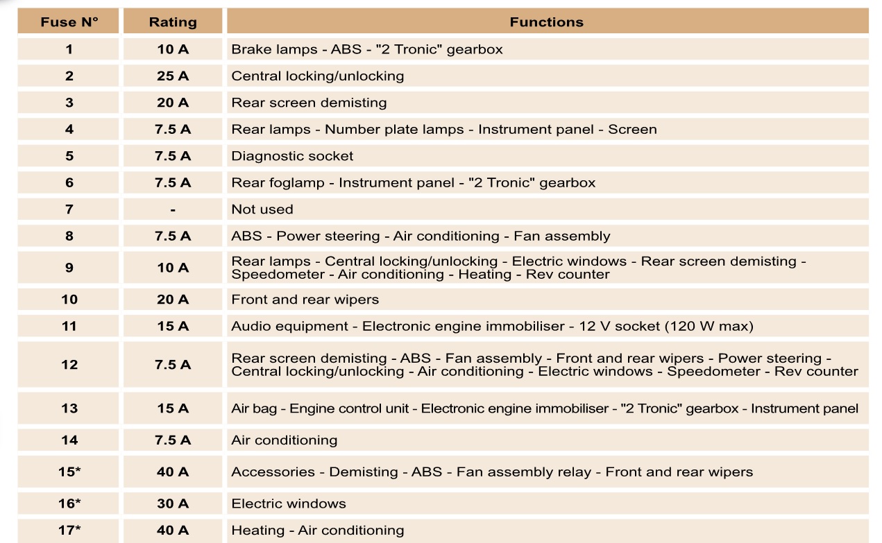

I've fitted a dash cam in for her (Wiring) but I can't seem to find an answer on where the fuse for the 12v cig lighter is..  Ive taken the.speedo housing off but not sure it's there?
Also does anyone know of a ground point?

fuse 11 15a (blue) in the speedo housing is listed as a 12v socket , you only have power sockets in cars nowaday,
as for a ground take your pick of the whole body, as long as its fastened to a good clean section of the metal bodywork it will work.
