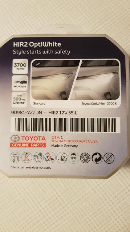

Toyota have recently introduced their Optiwhite bulbs which includes an HIR2 fitment with up to 60% brighter light - presumably they're available in the UK.
Believe both are around £60-70 for a pair.
As regards the Toyota Optiwhite, either contact Parts King by pm and include your reg.no, or your local Toyota dealer.

There appears to be nothing that actually says what they are basing their +60% on though so it could be rated against a "standard" halogen bulb. Especially as in my experience Toyota tends to use Optifit as a brand for parts that are a slightly lower level than Toyota-branded oem fitment.
Different brand to Optifit, which are the cheaper option. Previously Toyota's upgrade bulbs have been sold under the name of Optibright, and this HIR2 upgrade bulb is sold as Optiwhite.

I cycled down to Snows Toyota in Plympton today and bought a PAIR of HIR2 Optibright bulbs. They didn't have them in stock, so they were ordered for me to pick up on Friday ........... two days from now. Cost?  They were £40.64 for the pair including VAT.
I made sure that the lady I spoke to understood that they were Optibrights, and she assured me that they were.  Info as per the invoice is T90981-YZZDN HIR2 CUV 12V 55

Note that Mike said, "OptiWHITE" not "OptiBRIGHT"? (I think that Optibright is the standard fitment bulb and is why you've been quoted the lower price from what Mike suggested the Optiwhite's were...) However, since the part numbers appear to match, maybe you've got yourself a good deal there? Let us know how you find them in use, please Mick?
Will do!
I should be able to get to Snows Toyota at Plympton tomorrow, but it could be Saturday.  I have the picture of the box that they come in on my phone via iCloud, so I'll compare it to what I pick up.  If they're not the right ones, I won't bring them back and get them to re-check what I want.
I actually can't remember if I said Opti White or Bright, but I stressed that I wanted the extra bright ones than standard.  The young lady behind the counter fully understood - or at least I thought she did.  The way I see it, is that the standard bulbs would be in stock, but it's just the extra bright ones that aren't for the very reason that they aren't standard.
