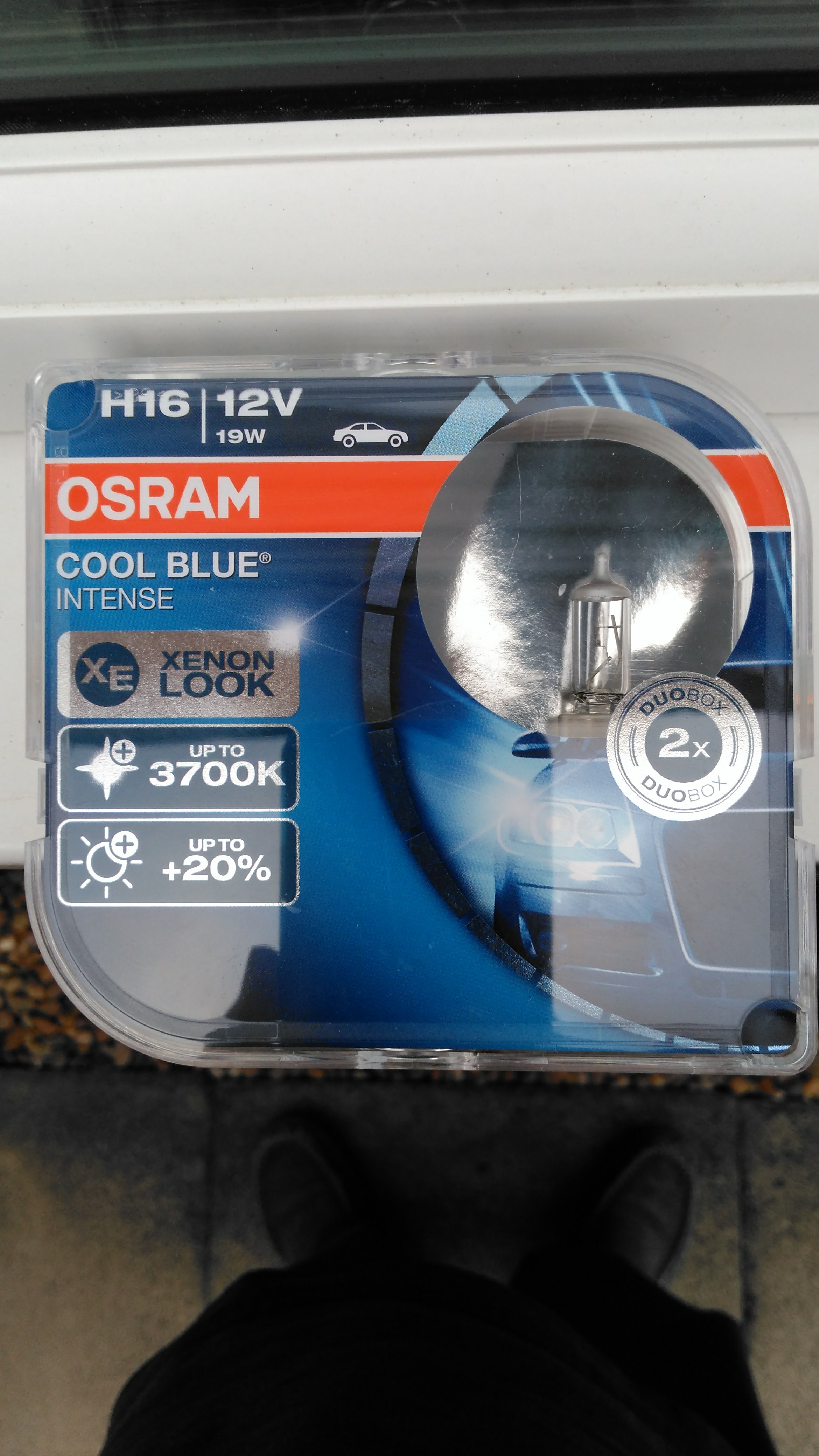

Just wonder which company make these bulbs for them. Both my pairs of Osram Cool Blue and Philips Crystal Vision are made in Germany. Osram claim to have a 4000k colour while the Philips are only 3700k. I am still kind of suspicious of where that extra 60% brightness is coming from.

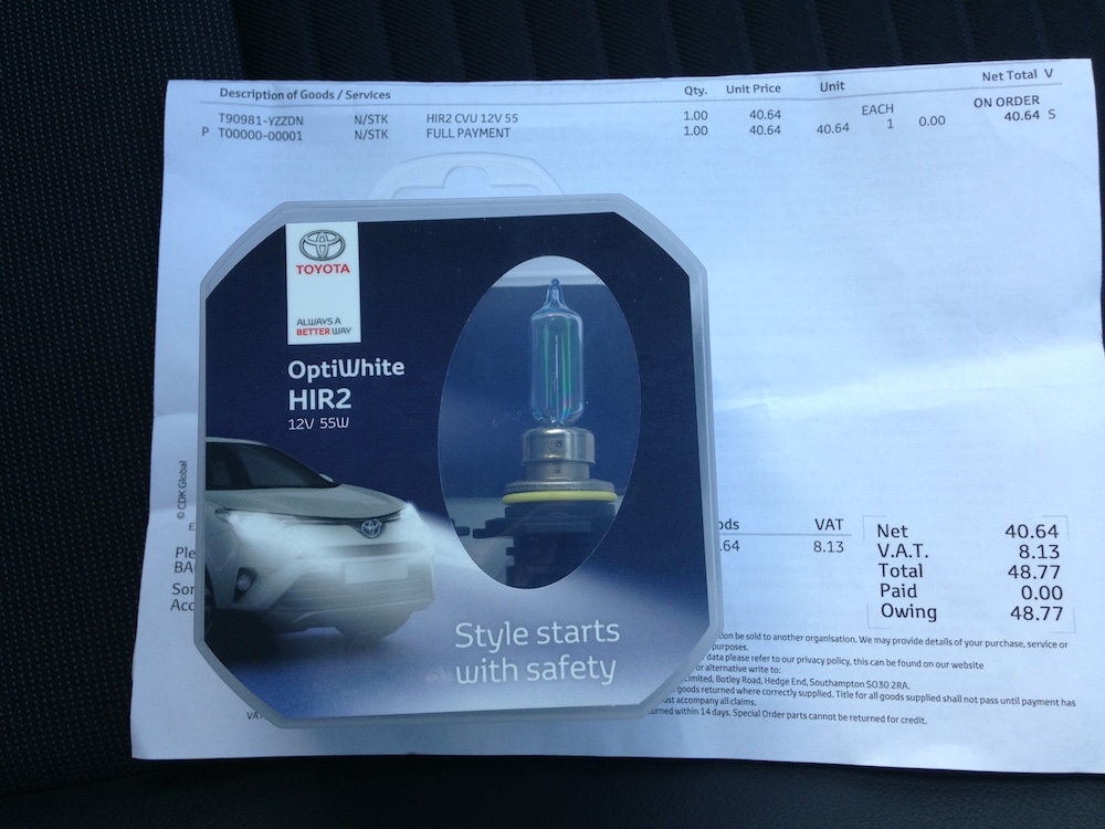

On 08/11/2017 at 6:35 PM, Mick F said:
I cycled down to Snows Toyota in Plympton today and bought a PAIR of HIR2 Optibright bulbs. They didn't have them in stock, so they were ordered for me to pick up on Friday ........... two days from now. Cost?  They were £40.64 for the pair including VAT.
Sorry, my mistake.  They were £40.64 PLUS VAT = 48.77.
We picked them up today, and I've just fitted them.  I've never owed a car where it was simple and easy to change the headlight bulbs.  Whole job from start to checking that they worked, must have been all of five minutes.
The bulbs are OptiWhite, though the box they came in was different to the one I posted above.
The bulbs themselves have a blue tinge to the glass(?) whereas the originals are crystal clear.  The filaments on the OptiWhites look finer than the originals.
Mick.

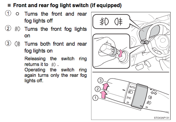

The fog lights on the Yaris are very similar to that last example you spoke of in the Fiat 500. The rears are first switched on by turning one click from off going forward on the ring. To add the fronts, you turn it a second turn against spring pressure and it springs back leaving the fronts + rears on. Turn back to off turns them all off. Obviously, this way you can have just the rears on, on their own. I believe it is now a legal requirement (EU) that the system must not allow the front fogs to be on in isolation or without the sidelights being already on (BIMBW).
BTW, the new bulbs are excellent! What a massive improvement in both the headlights (dip and main) and the front fogs which are now actually useful (which they were not before IMO...).
This is not the same for the 2012 hybrid:
Fog lights can be used when:
Vehicles with a front and rear fog light switch (like mine)
Front fog lights: The headlights or the front position lights are turned on.
Rear fog light: The front fog lights are turned on.
I take it that this is a typo & should read "can't"?
Pre-dawn test drive complete.
I cannot say I was impressed, but I was relieved.  The headlights are now like they should have been all along.  Not fantastic, but quite good .................. thank goodness!
I tried to see how the foglights work.  First click brings on the front ones - BAD!  The rears should come on with the first click.  This is the same as our 2001 Clio.
I couldn't get the switch to turn to rears, as it seemed springloaded and wouldn't work.  I'll dig out the instruction manual later.
Mick.
Indeed! I got the whole thing ass over elbow!! It all should have read:
The fronts are first switched on by turning one click from off going forward on the ring. To add the rears, you turn it a second turn against spring pressure and it springs back leaving the fronts + rears on. Turn back to off turns them all off. Obviously, this way you can't have just the rears on, on their own.
