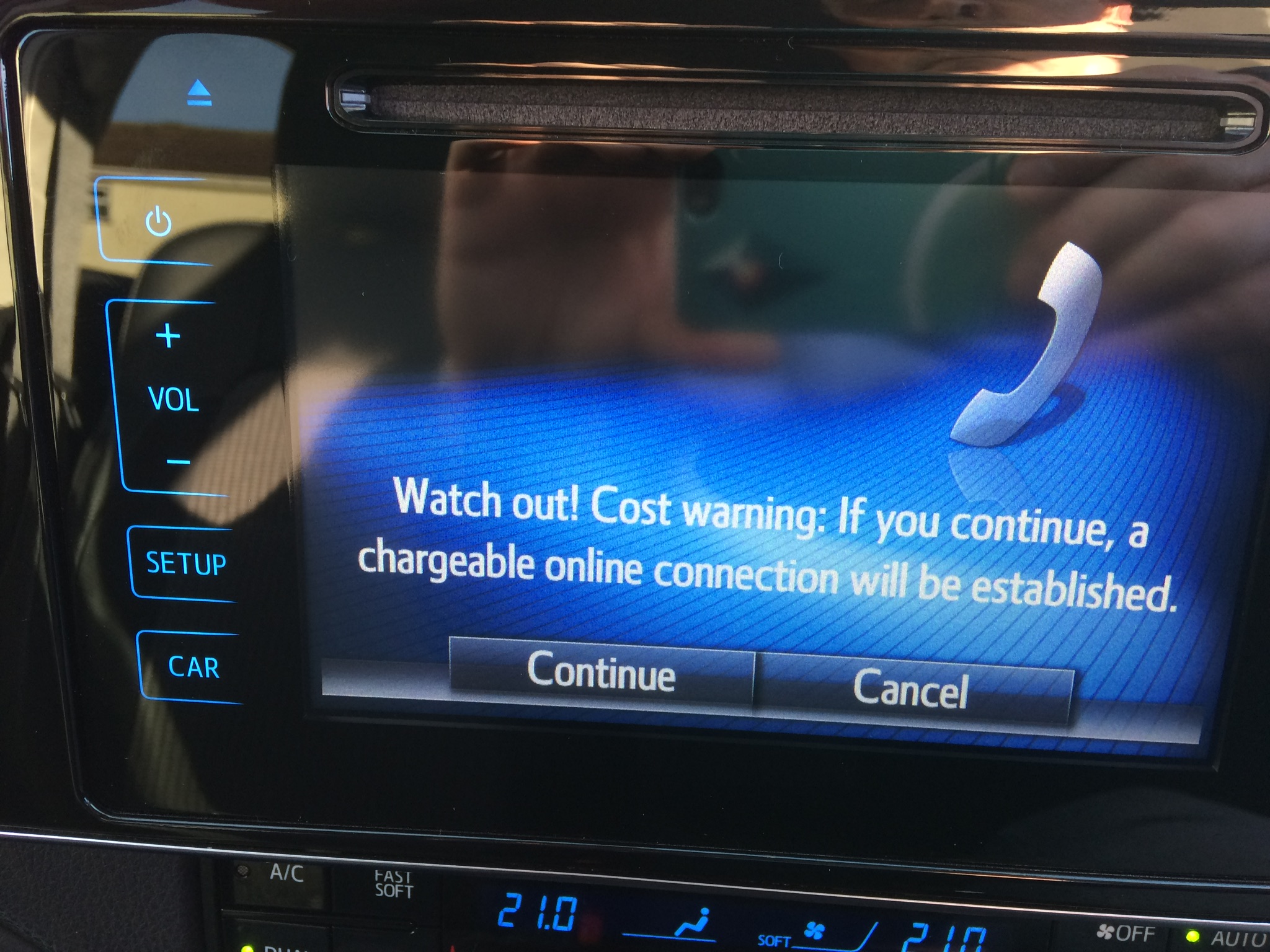

Anyone know why my car has suddenly started showing this warning ?
And how do I disable it ?
And how do I make sure it doesn’t connect online, either by something in the car or on my phone, iPhone 5s.
Have you recently updated  or reset the head unit/satnav?
1 Press the“SETUP”button.
2 Select“Connectivity”.
1 Display the connectivity settings screen and select “Bluetooth*2 connection.
2 Select Charge warnings and then select what you would like or not like displayed.
To stop it connecting to the internet I would read the online manual on the Toyota web site, it can do it over the phone or over a WiFi network.

Thanks chaps. I’ll look at the warnings settings and the online manual.
TonyAuris, any idea where to look in the online manual ?
Hi
If you have setup your car in My Toyota on the Toyota web site the manuals for your car will be listed and it’s the Nav one you need.
If not you can do a generic search for manuals on the web site. Chapter 6 is about the setup.
