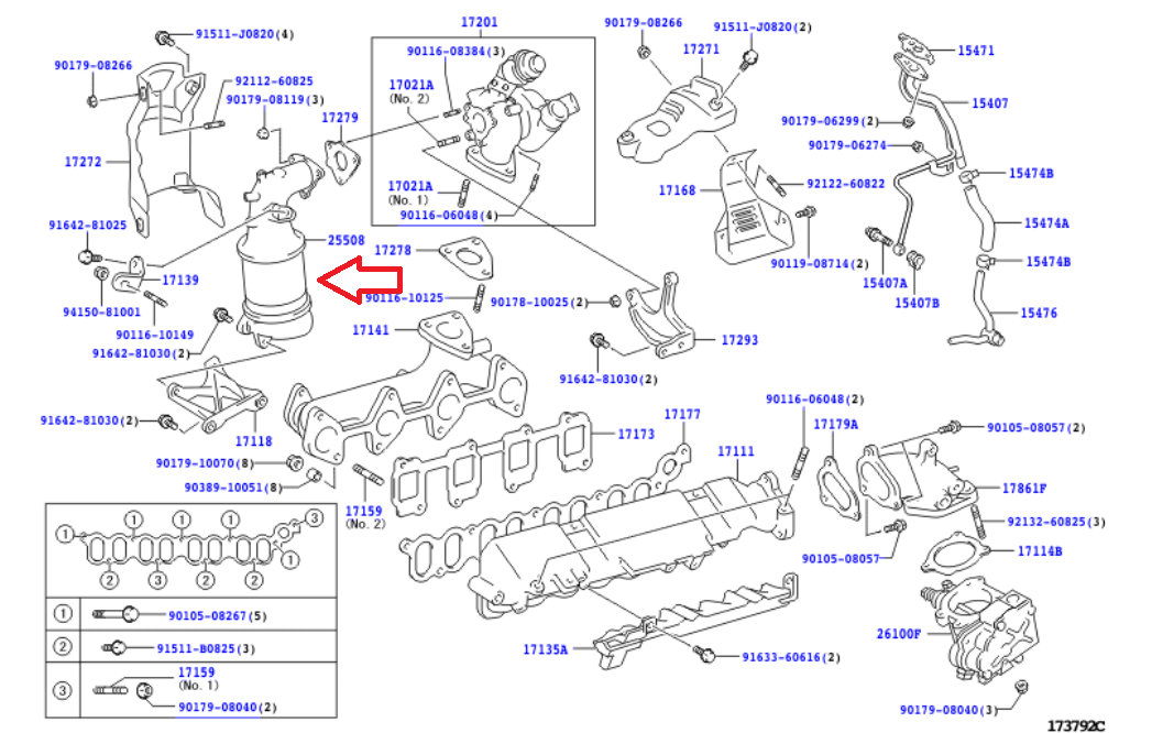

On 1/26/2018 at 7:45 PM, Devon Aygo said:
OK if it is a 2.0 D-Cat then its a late 1CD engine, the DPF is in the exhaust manifold dropping away from the turbo down to the front exhaust pipe and P2002 means the DPF is clogged and needs regenerating if you can't do that through a good motorway drive then a forced regen is required. The DPF fault will have set the Engine management light on because of this the VSC and TRC systems are disabled resulting in warning lights for them as well.
i have a 2014 d4d toyota avensis i see the dpf id in a really hard to get place behind the engine at  the back it looks a real pain to get out if i have any problems later on is that where im looking at is where it is
Do you have the 1AD or 2WW ? the 2ww has a cat and a DPF, 1 and 2AD has just the one combined cat/dpf or D-Cat
eg. 1AD
2WW all 1 piece
eg. 1AD
2WW all 1 piece
thumb?id=20444400&m=1&n=0&lng=en&ccf=940
not sure if you talking to me but mine is a 1ADFTV engine 2.0

it is indeed a 1AD
we were told to remove the exhaust system and the drive shaft on the right side. Is there anything else we have to be aware of?
