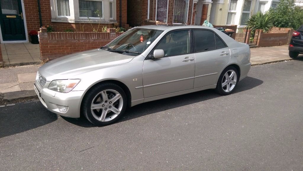

I have an e150 2007 corolla. I want to put on a pair of lexus alloys off an is200 sport. These alloys are 17" and have the same bolt pattern and centre bore  as the original wheels. Only difference is that the lexus wheels has an offset of 50mm whereas the original wheels are 45mm. I have read other posts of steering and ride being disturbed by changing the offset majorly but I was wondering will increasing it by 5mm cause any problems or is it too small to make a difference. I've attached a picture of the lexus alloys. Thanks

Are the Lexus alloys the same width as the existing wheels?
Yes same width
OK, if you aren't changing wheel width usually you can get away with plus or minus 5 without issues.
