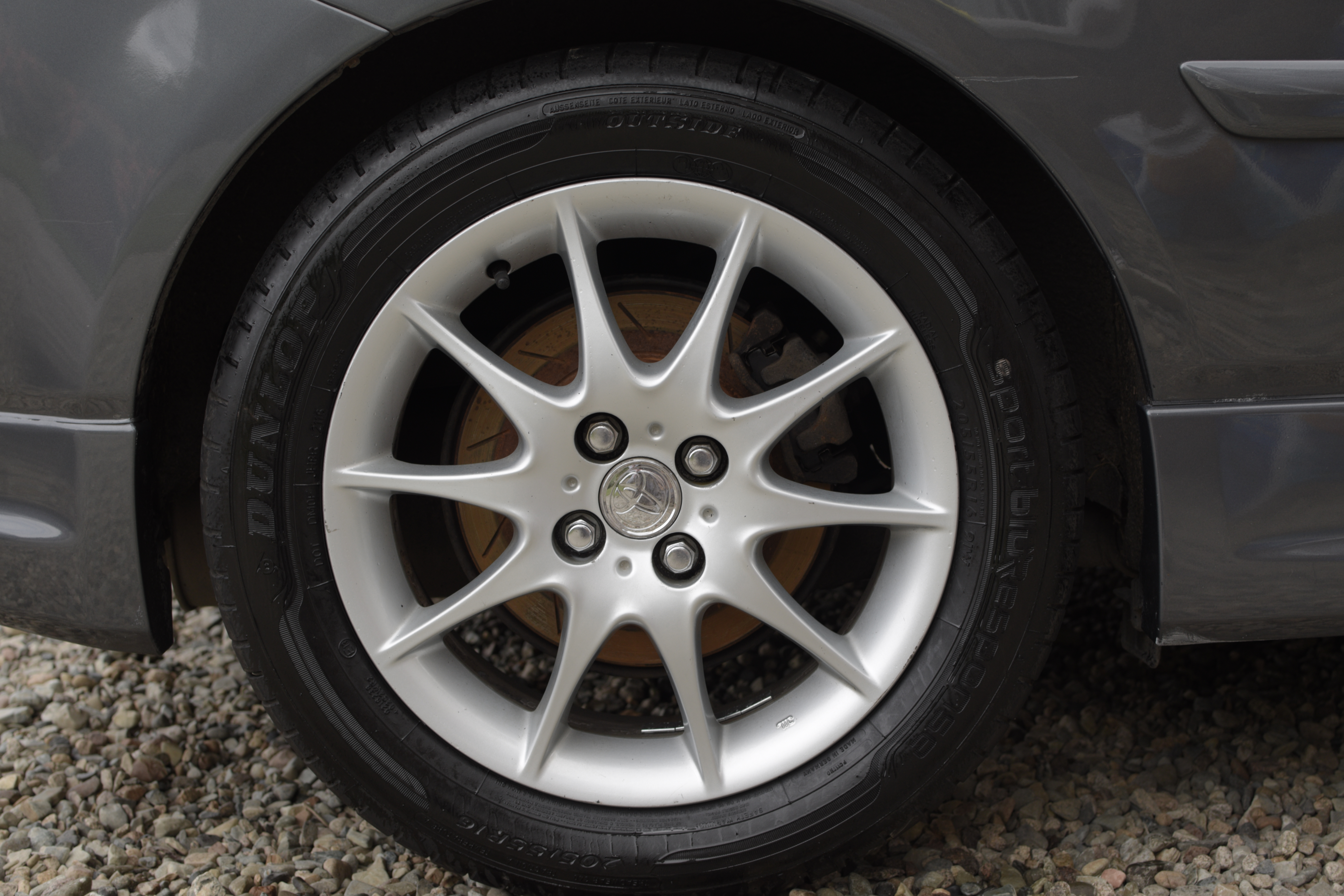

You can run 205's fine. I have 205/55/16 Dunlop BluResposne Sport tyres. I was also looking pilot sports but they are a bit pricey
