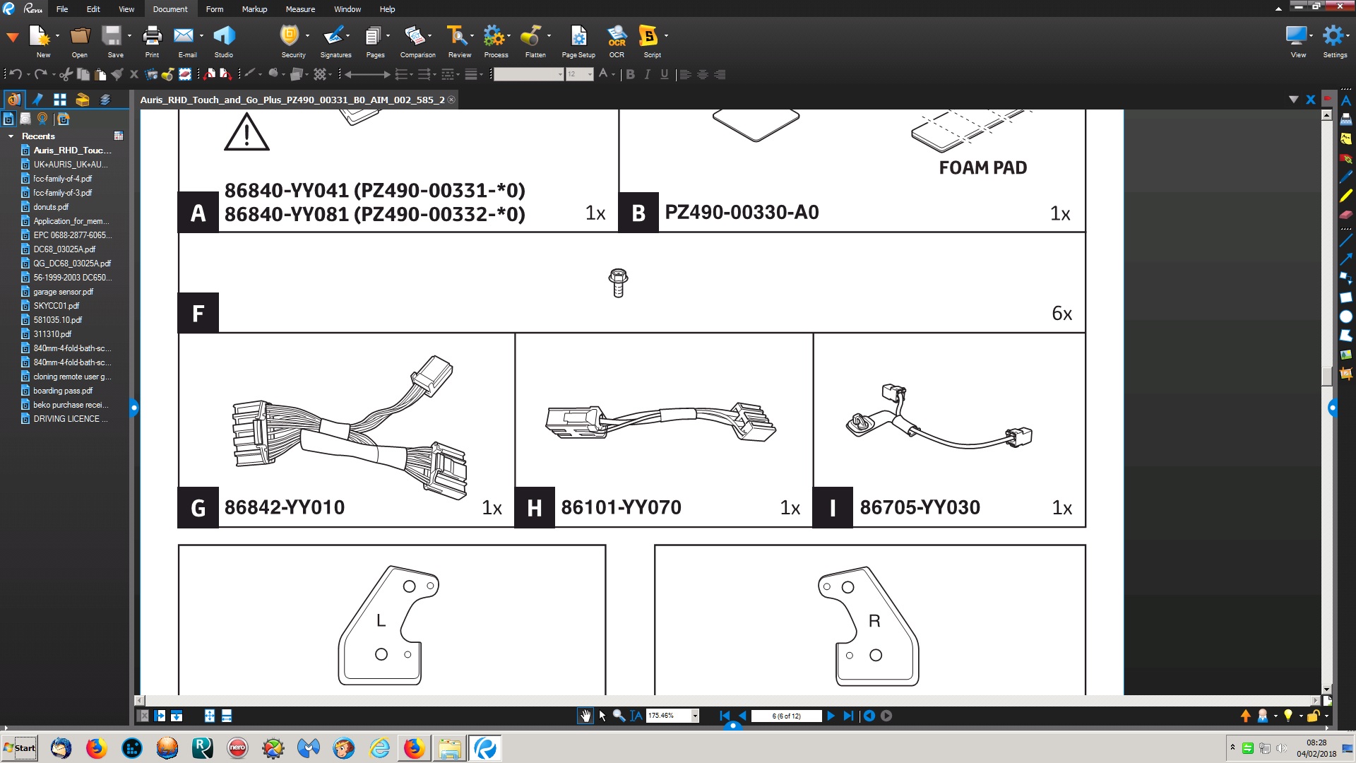

if you buy a secondhand satnav unit like we did make sure you get the wiring cables that are needed
theres one on the top of the sat nav unit and 2 other cables to connect the headunit and nav unit together
one is for the aerial you can get a gps antenna for £10 new
see attached image for cables and part number for the original touch headunit
