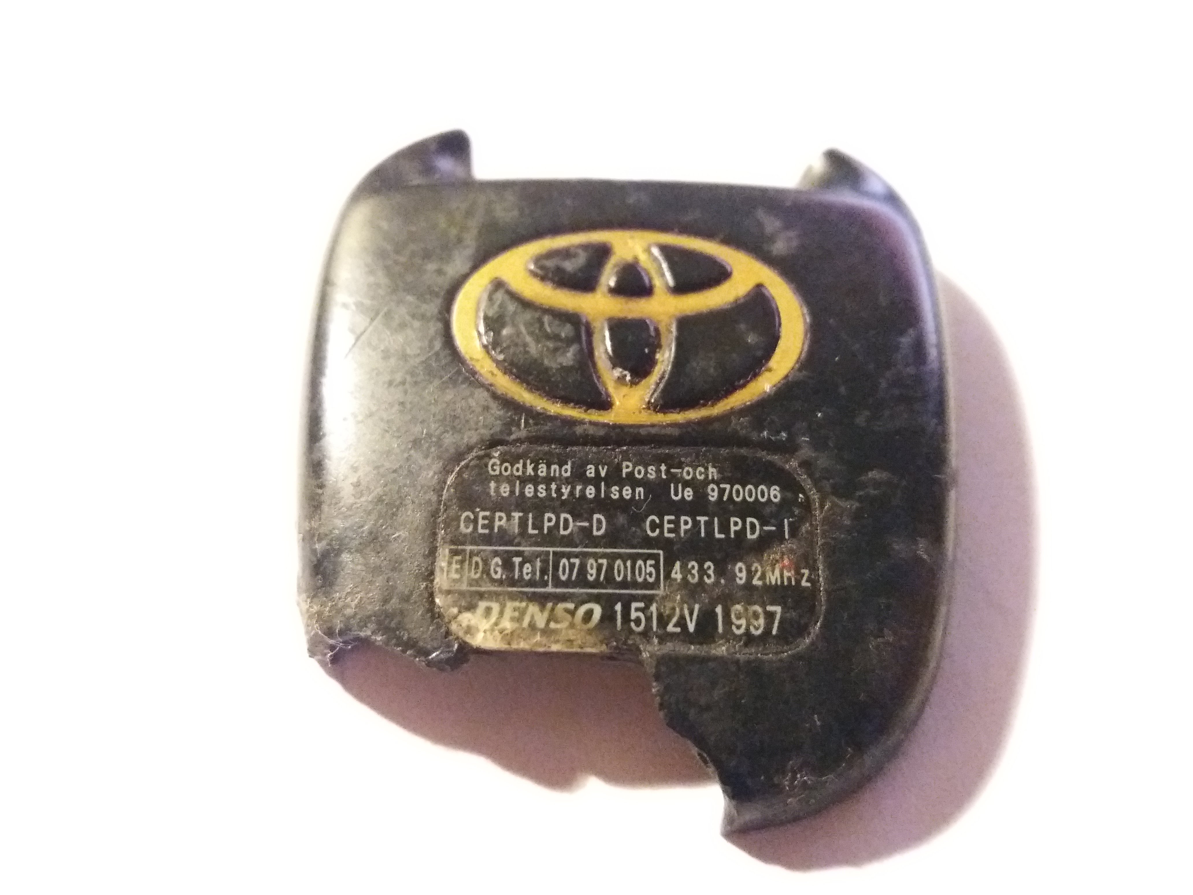

I found the programming instructions for the remote but I think I have a problem with the current remote I have. From what I've found it is a e12 remote, the later model of mine and the frequency is defferent.
I was searching e-bay to find an uncut remote for my vehicle but I have a problem. There seem to be two types of chips. A 4C and a 4D67. The only thing that I have from the previous key (which PROBABLY is from the previous key-aka the right one) is a broken case with sum codes and stuff. Can somebody help me find what chip I need? The blade is a TOY43.
