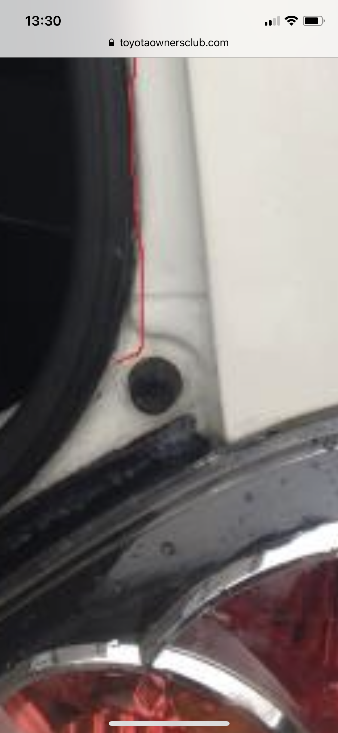

Does anyone know what these things are called, if you can get replacement ones and  if they’ve got any link with the body work?

Presume they are bump stops which cushion the glass tailgate when closing. Should be able to buy replacements from a Toyota dealer.

Great thank you! Do you know how they fitted in by any chance?
Tailgate stopper, part number 90541-09124
Think they push fit.
