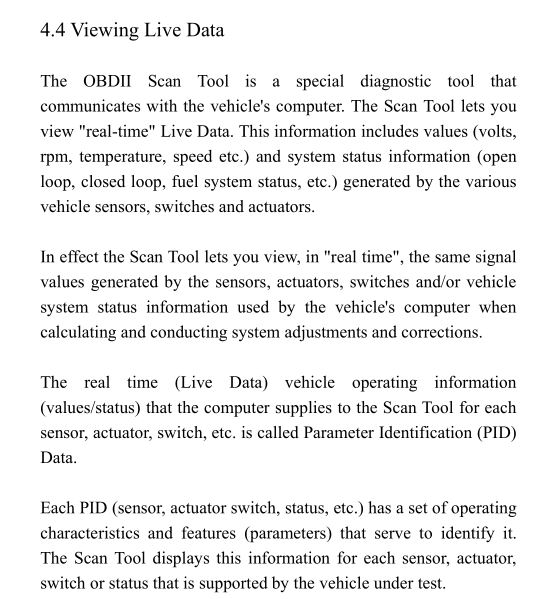

You might get some info by using a OBD2 scanner with a graphic  display that you can view live data on.
I've got one of the cheapy D900 scanners and it does show live data, though a long time since I plugged it in.
