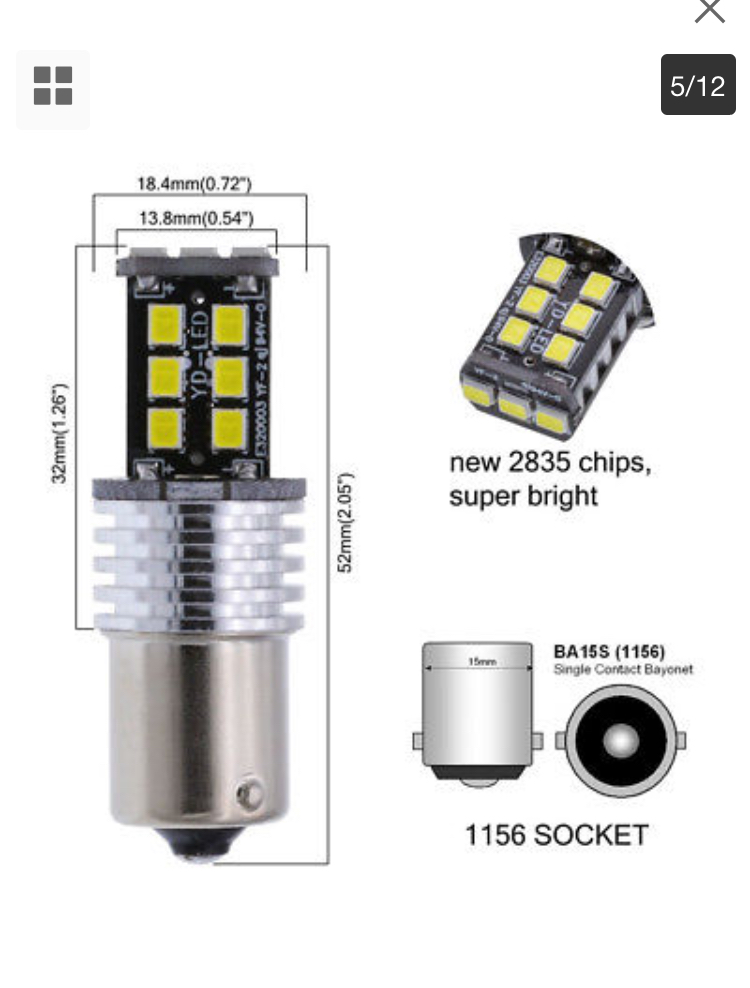

I recently changed my car Indicator's bulbs to the more brighter and energy efficient ones Led low power .
Now they are hyper flashing,far to fast any suggestions ..?
Toyota Corolla Verso 2006 T4D
I read another thread,  possibly on here, re LED bulbs. Seems their resistance is different,  much higher IIRC,  so that'll mess with the flasher circuit.
You can put a resistor in parallel with each bulb (you'd have to go searching for the value or work it out yourself ) or its back to filament bulbs
Seems they're also generally not e rated.
