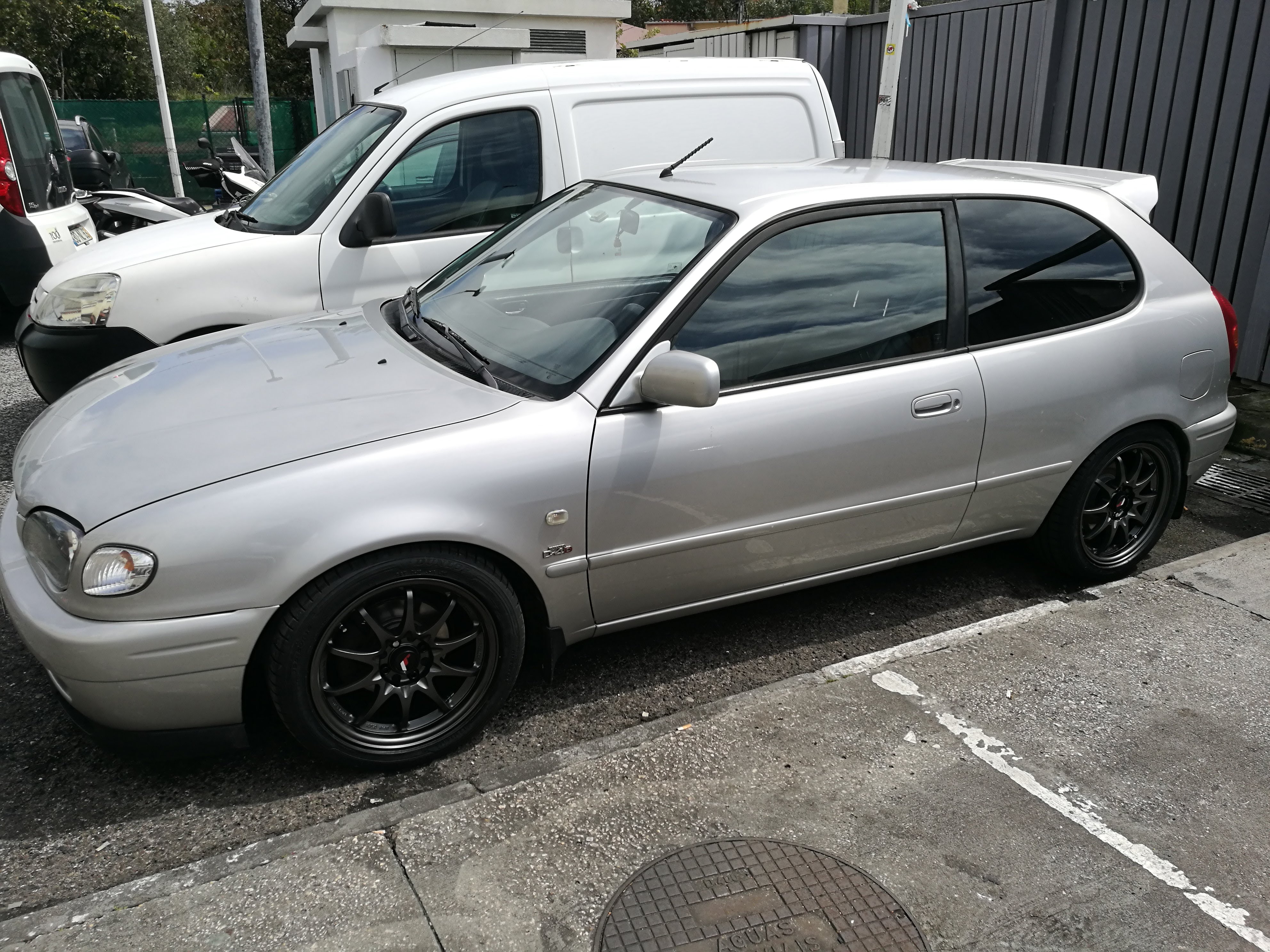

I've lowered my E11 corolla on 40mm lowering springs and add some Japan Racing JR5 16" 7J  ET30, with 195/50R16 tyres.
The problem is that the tyres sometimes are rubbing.
What should I do? Roll fender will fix it? Or should I change the 40mm to some 30mm Eibach pro kit?
Does someone have pictures of an E11 with the Eibach pro kit?
Thanks.
Do you know where the tyre is rubbing? It could be rubbing on the inside of the wheel arch, or it could be rubbing on the outside. You'd have to put it on full lock and inspect it.
Other than that, you can either put up with the rubbing or give the wheels more room. Can be done either by reducing the width of the tyres, increasing the height of the suspension, or roll out the arch flare and use a spacer to bring the wheels out a little.
