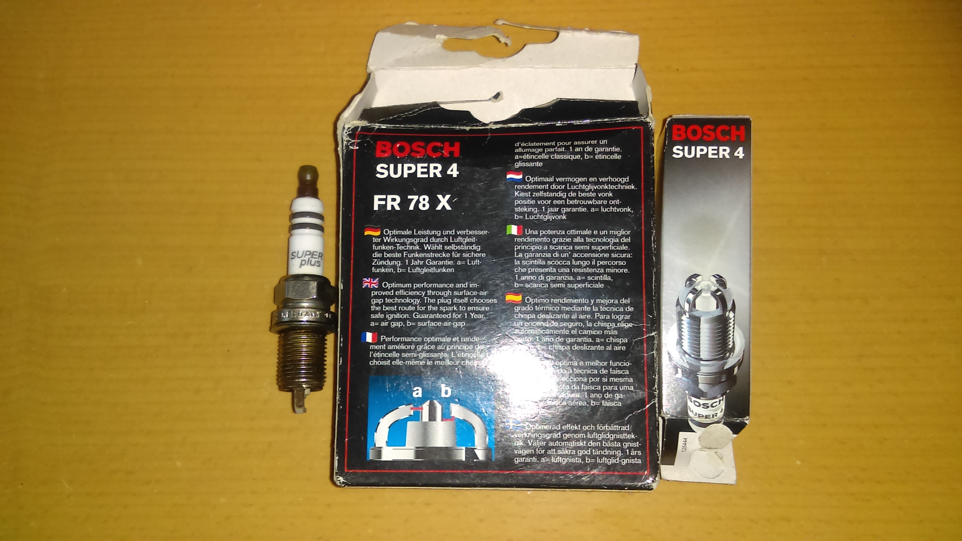

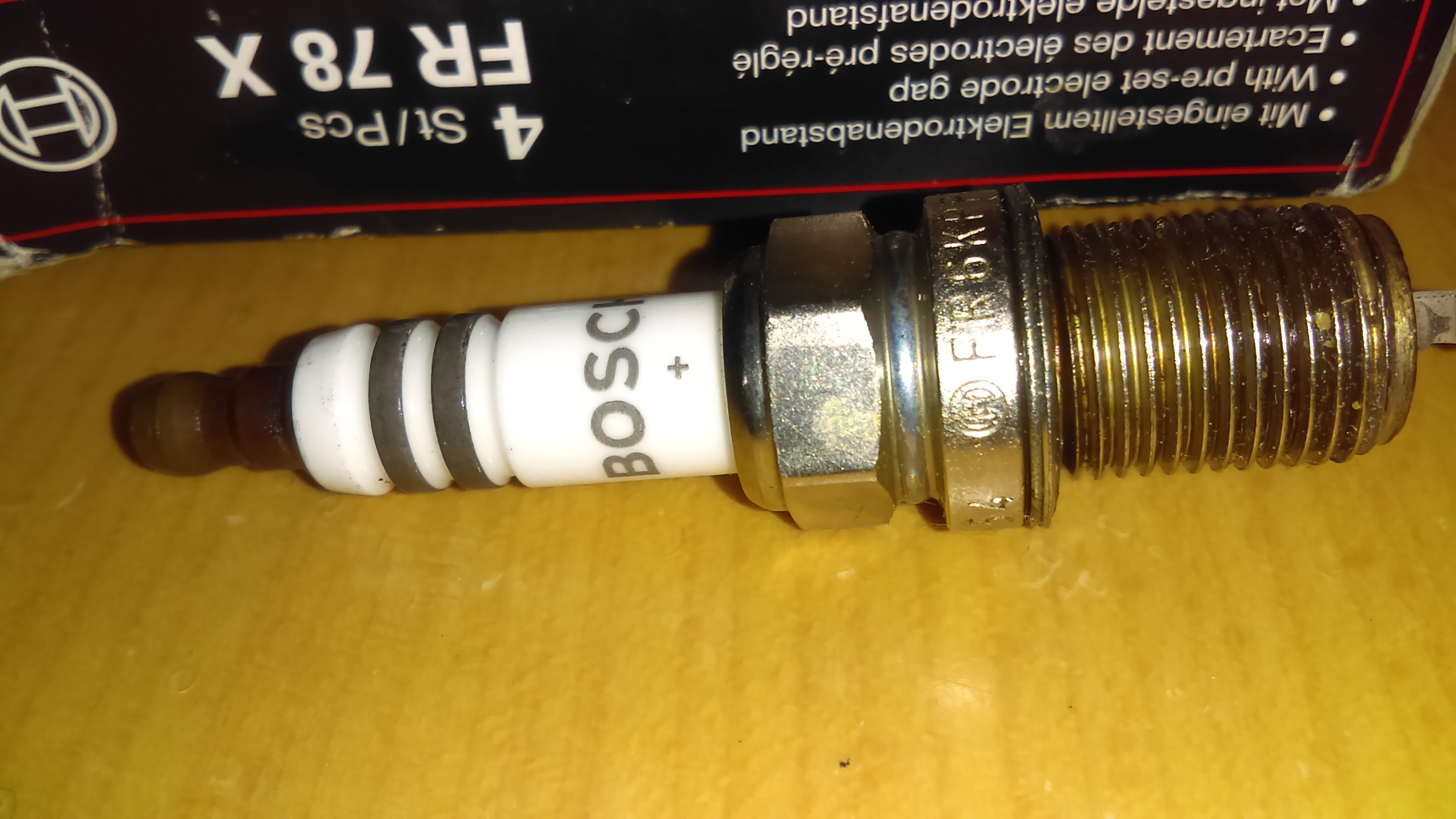

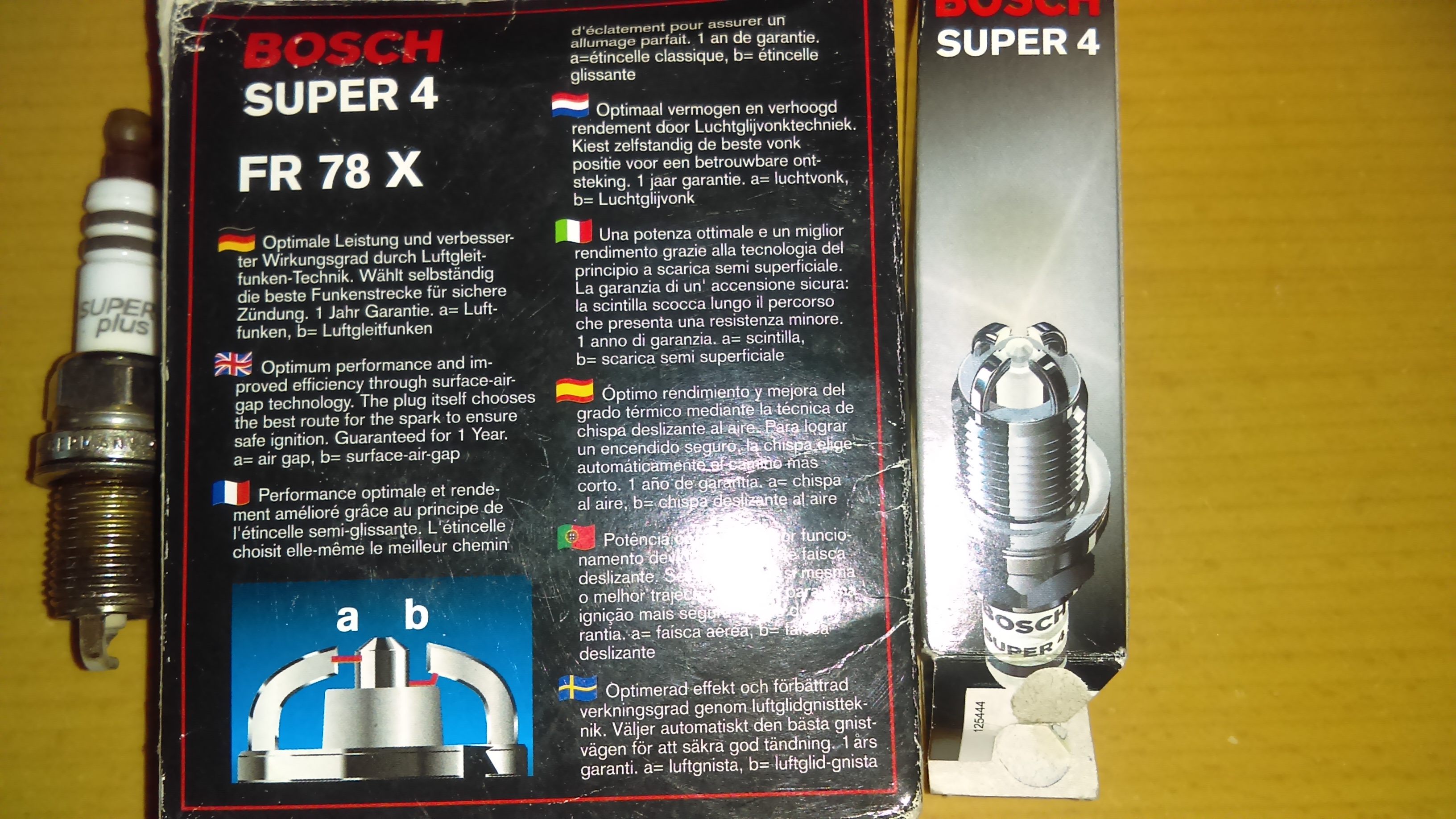

Another very puzzling factor has turned up regarding spark plugs. A car - Toyota fitted with Bosch plugs.
A box of 4 plugs Bosch Super 4 FR 78 X. A multi point plugs at the base. Open the box and there are 4 boxes of Bosch Super 4 FR 78 X. Open those plug boxes and one finds 4 Super Plus plugs FR6KPP33X +54 with U tube base. The owner of the Toyota was totally  confused. What plug had been supplied.5ad5aeda0fbcb_IMAG09041.thumb.jpg.d8557135faa45f83811e8ff6df4c1afd.jpg
