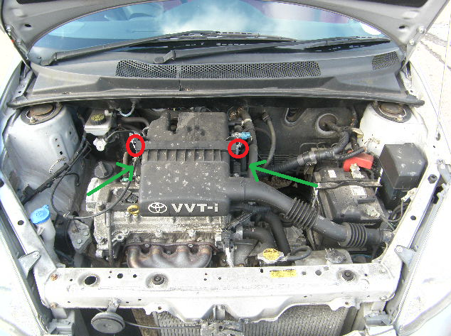

I had the same issue myself. It turned out to be 2 separate but related issues. The first was an air hose underneath the air box had come lose, the clip was missing so I got a jubilee clip from Halfords and popped it back on. The second issue was the MAF sensor, I tried cleaning it, however it didn't help. I replaced it with an aftermarket one from eBay for about £25 (£20 now) and now it drives flawlessly.
Here's the MAF (Make sure it's definitely compatible, PM me if you want me to take a look):
https://www.ebay.co.uk/itm/For-Toyota-Yaris-VITZ-AVENSIS-1-0-1-3-16V-Mass-Air-Flow-Meter-MAF-1999-05-PINS/252692035223?epid=5016650572&hash=item3ad59e7697:g:Z8wAAOSwLF1X~LhT
And the hoses that came loose and may be worthing checking can be found by unclipping the air box (red circles), and looking where the green arrows point:
Good luck, and don't hesitate to get back to me with this 🙂
