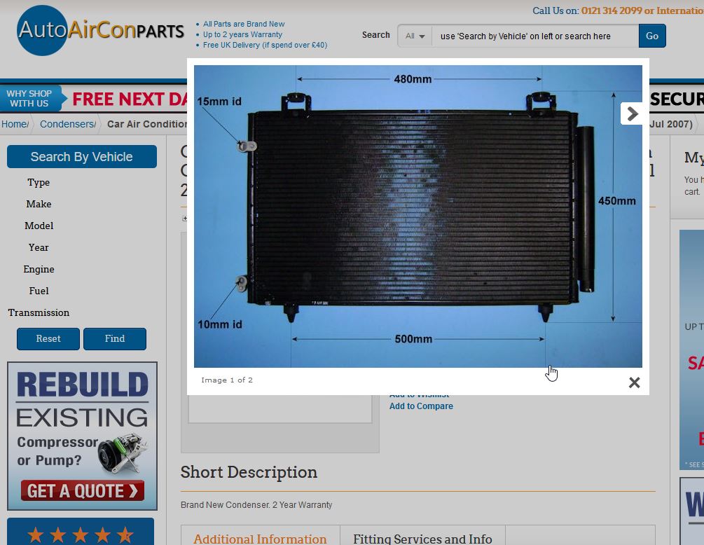

I got the condenser from here  but found it was about 15mm too tall, it has to fit between two fixed cross members,  had to make adjustments to the upper and lower fixing on the condenser to make it fit;  they are China made pattern parts, so expect other similar priced suppliers will be the same...?
Apart from the gas, its a simple enough diy job, but its made easier by removing the front bumper, just a few screw bolts, as it give clear access to the pipe connections to the condenser and plenty of room to guide things in and out.
Do check yours has pipe fittings like this pic, there are two possible models.

You have to order that essential O ring kit as a separate item at checkout, not included with the condenser.
I had to remove some of the depth from the bottom rubber to make it fit,  but not too much otherwise the body will touch the bottom crossmember.
The upper brackets can be unscrewed to allow them to slide down over the frame so  you can get the unit under the top cross member, then they can be reattached, if you see what I mean.
