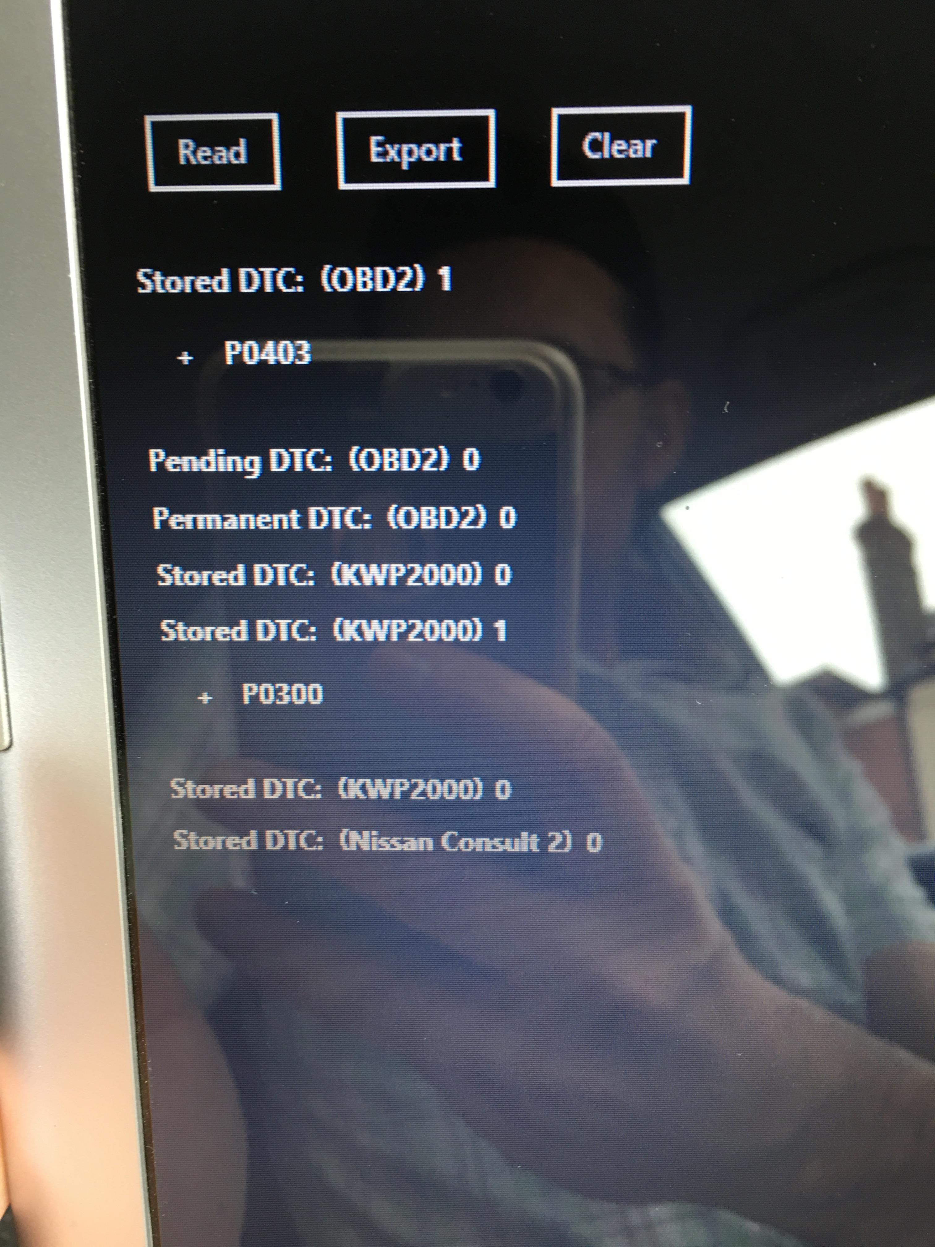

Hi Avensians, anyone decipher these 2 codes and are they related to one fault? If it is just the EGR valve is there any way I could get the part number/code without diving into the engine? Car : 2005 2.0 D4D T4 Hatch. Thanks folks. WOW just realised, haven't been on this forum since 2013...my first fault showing up.
The causes for a P0403 EGR code could be any of the following: Bad EGR solenoid Excessive resistance in control circuit (PCM controlled ground) due to an open, chafing or damage to the harness Poor connection at the EGR solenoid harness (worn or loose pins) Water intrusion at the EGR solenoid harness Blockage in EGR control solenoid holding solenoid open or closed causing excessive resistance Loss of supply voltage to EGR solenoid Bad PCM
