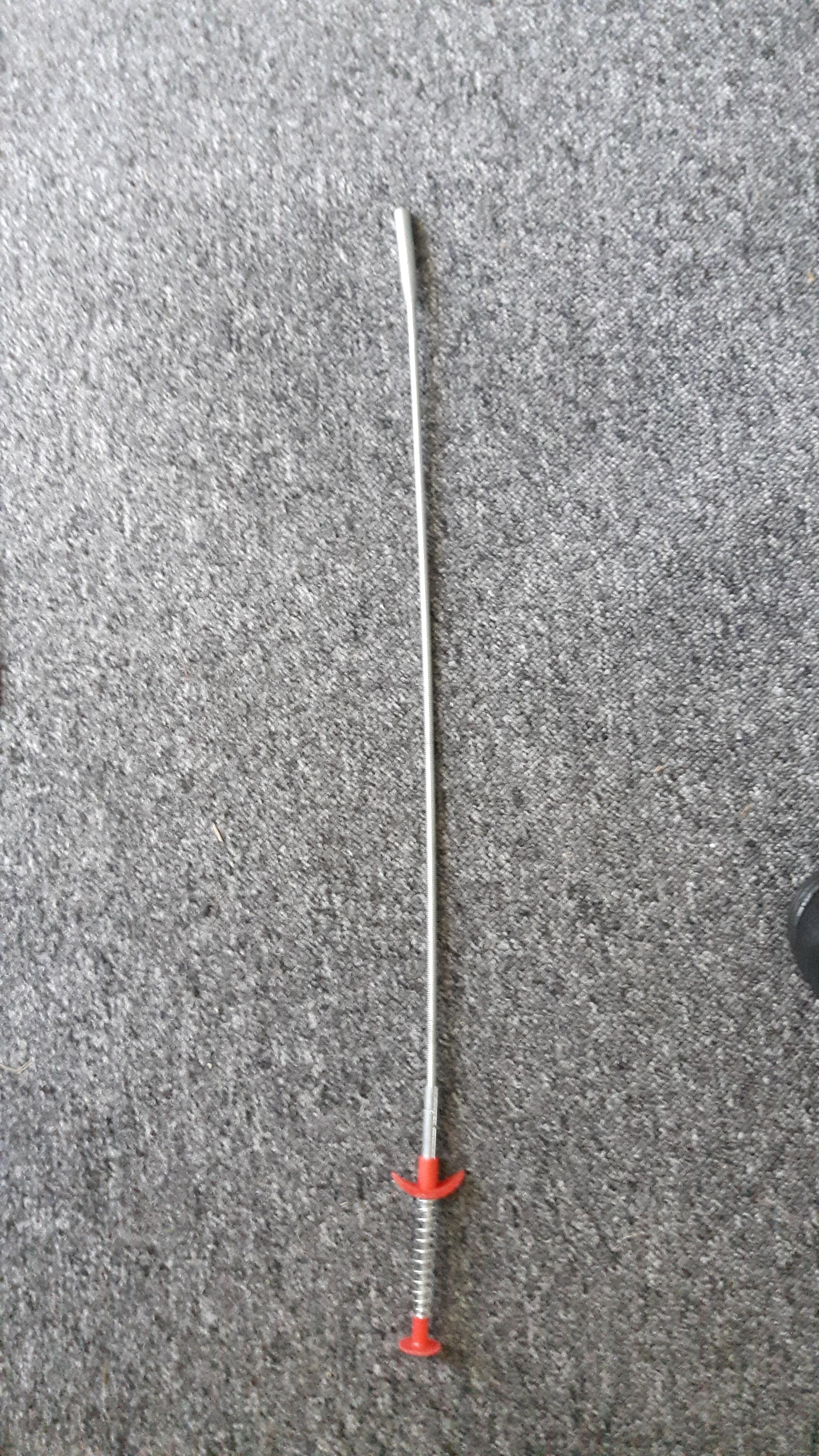

I this tool to reach down the spark plug tubes to retrieve plugs or sockets. 20180610_094644.thumb.jpg.a7498898a50e265249177a47c50880c8.jpg
It is 2ft long (60 cm) long and is very handy for getting at difficult to reach objects.
