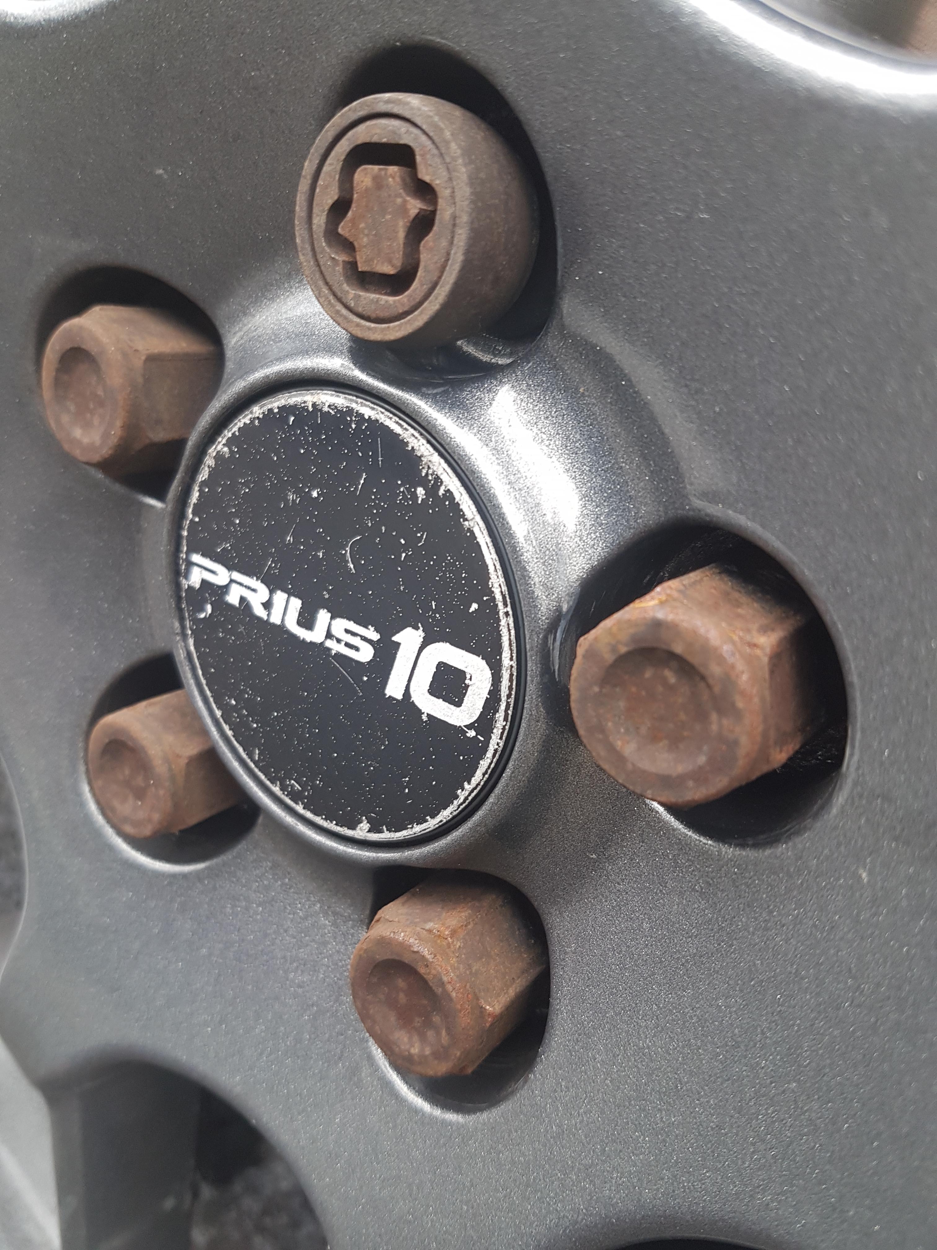

I've got a lot of rust on every single one of them. Does anyone know where I can get them replaced as I'm looking on eBay but have no clue as to what what would fit. Thanks

Do you need model like this down?
Size should be M12 x 1,5mm, which is same as i got on my Auris, so i presume it's Toyota standard.
You can find it searching for FEBI BILSTEIN 26587  or  FEBI BILSTEIN 46663 (they are identical.

Are those some special edition alloys? Not sure if they'll fit, but I have nuts like what @furtula, got them from my local Toyota dealer at a reasonable price (to replace locking nuts). They seem to be decent quality chrome, as my brother's '09 Auris has the same and there is no corrosion.
To my knowledge, they seem to be default for gen 1 Auris, i have them on my 07 with summer alloys. I haven't noticed any corrosion on them.
You can take 1 nut from that Auris and give it a try, but i think should be the same size as written above.
The model from the picture costs around 2 GBP where i'm at.

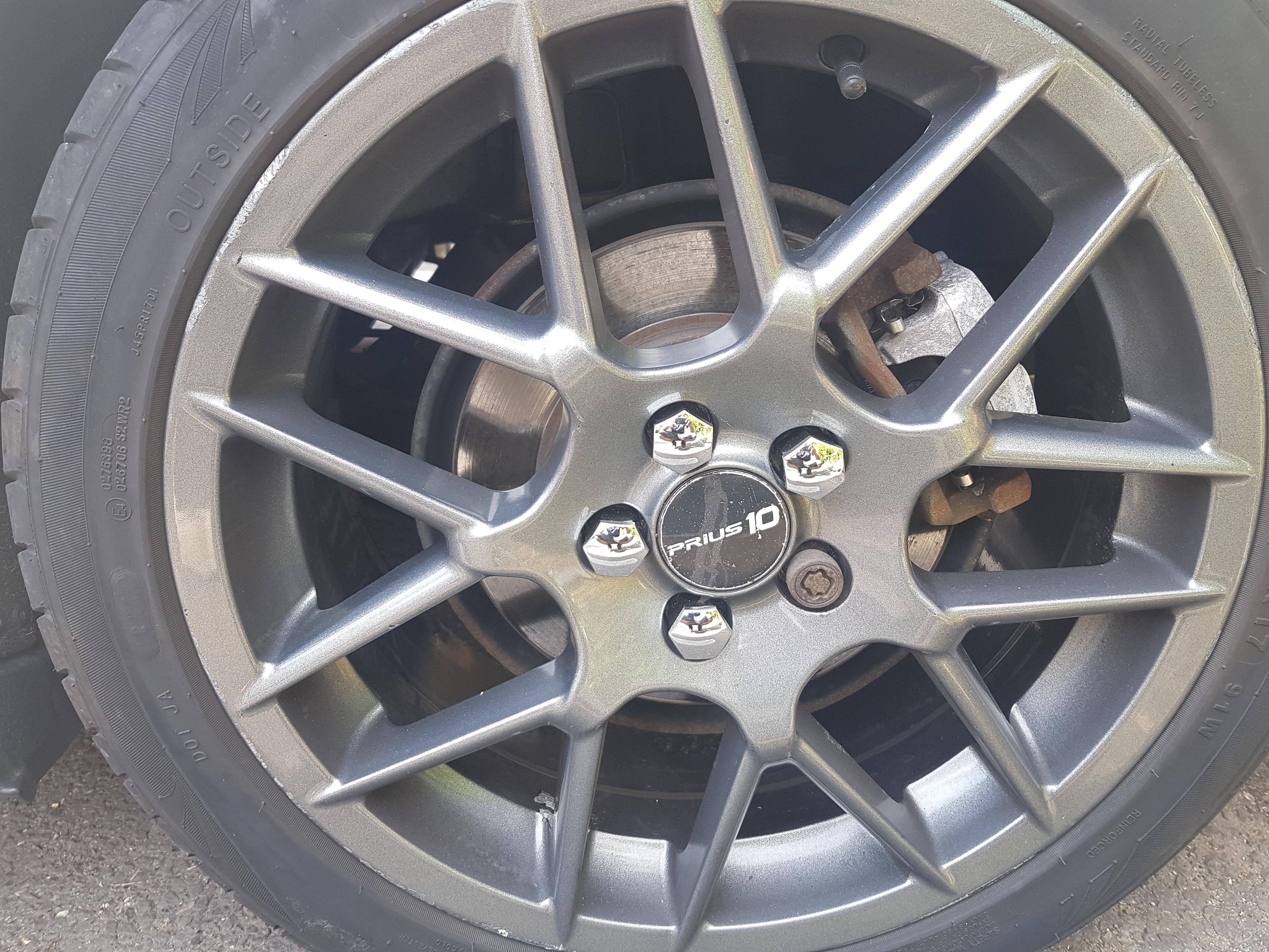

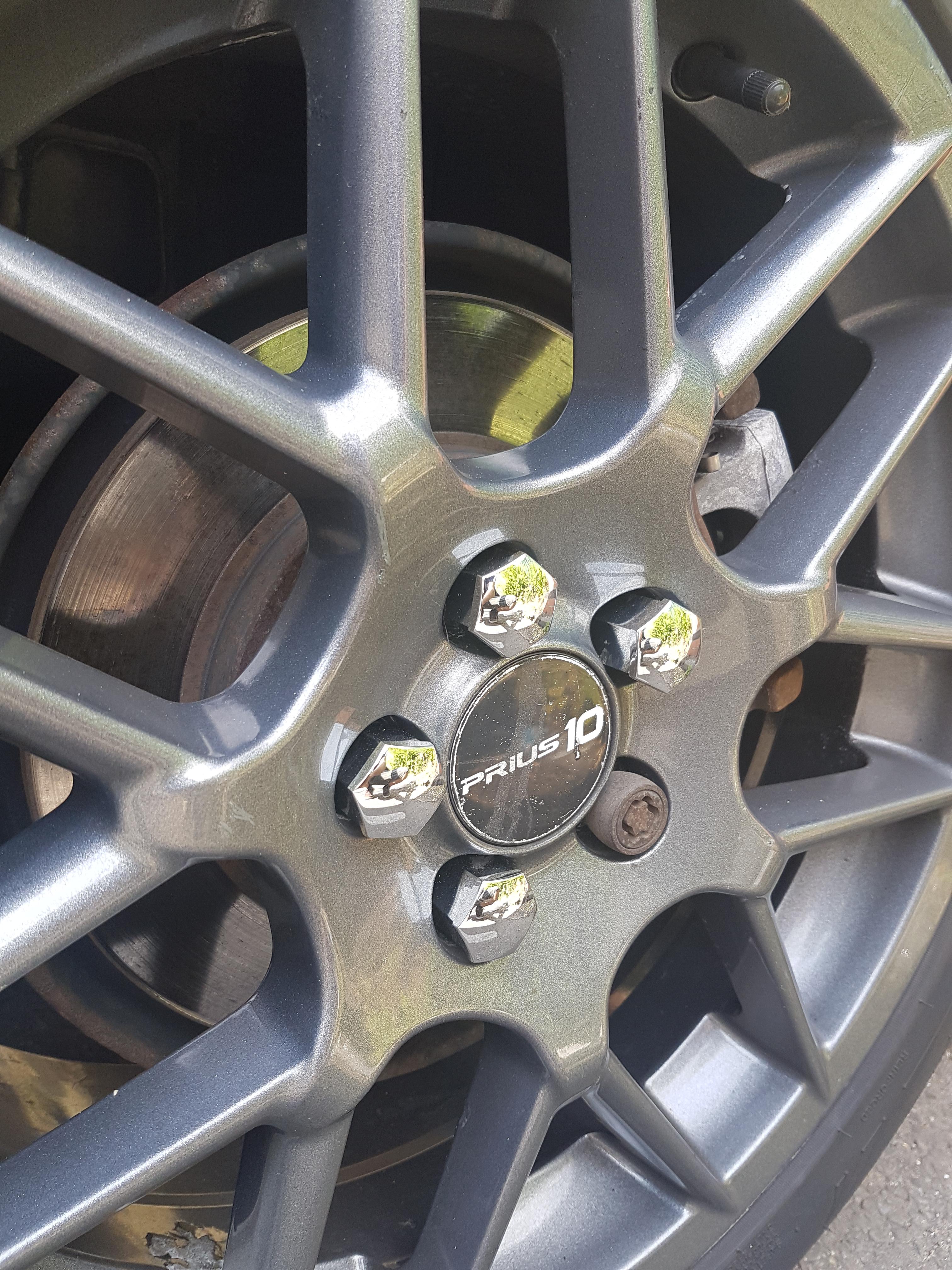

Thanks, I've just bought the black ones! I will send a photo after I put them on lol
I've put them on, lol
I've fitted some as well Forge,  it's pity the ugly locking wheel nut can't be covered somehow.
Exactly what I thought.  😋
You could just get rid of the locking nuts, I'm considering it myself. Who's going to steal wheels off a 7 year old Prius? 🙂
My thoughts too. Chalk up another reason why I don't like locking wheel nuts. Dog's breakfast!
